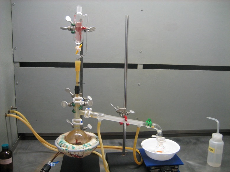

I recently prepared some ethyl iodide (EtI) using the method found in Norris in the forum library. Since this is an alternative to the classic method using red phosphorus and iodine I thought my results would be of interest.
The Norris procedure specifies 60g of 57%HI. Since I only had 50g I scaled back accordingly. Not having a 200mL distilling flask I used a 250mL RBF. I used a small pressure-equalizing funnel with a 6mm glass tube attached as a dropping funnel. Some time ago when cleaning this funnel I accidently broke off the small inner glass tube at the tip of the funnel. This was serendipitous for this use as I could now clearly see the ethanol drops as they were added at 1drop/s as required by the procedure. The boiling HI did tend to percolate up the tube but this gave no apparent problem. As Norris indicated the EtI accumulated in the receiver drop by drop as the ethanol was added drop by drop. A photo of the reaction apparatus is shown below:
dripping ethanol into boiling HI.JPG - 92kB
dripping ethanol into boiling 57%HI

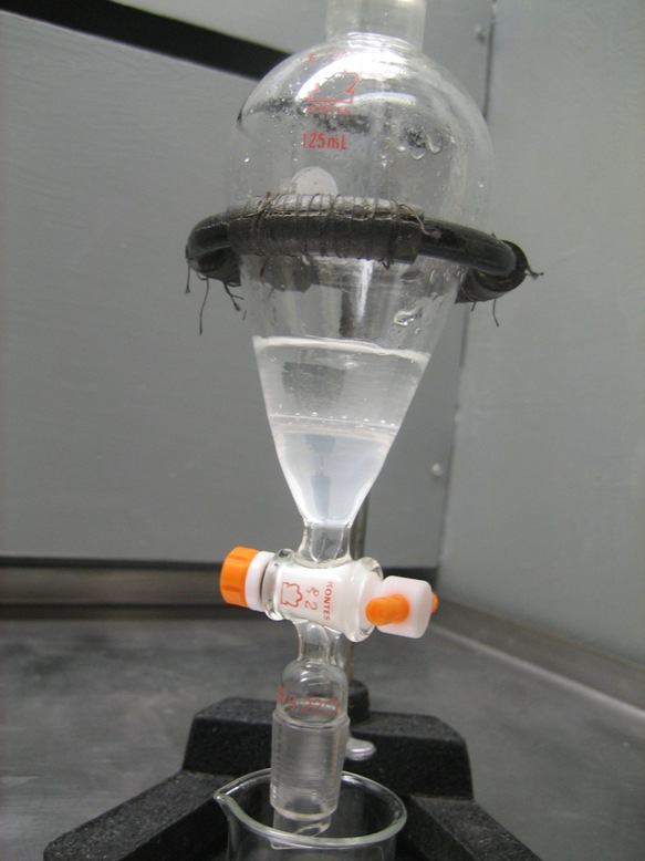

For the workup, per Norris, some water (~7mL) was used to wash the product. The washed product had a deep brown color due to dissolved iodine. At this point I switched over to the workup in Brewster. I washed with 5mL of 3% NaOH which discharged all the iodine color. I then washed the product with 12mL of water. This was removed by separatory funnel as shown in the photo below. There was a very clean separation as the density of the EtI is 1.93.

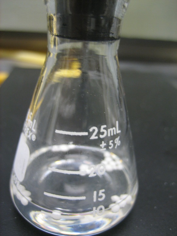

The product was then placed in a small Erlenmeyer flask and about 15 BB's of CaCl2 were added for drying. As you can see in the photo below they floated. This was left overnight, and yes, the rubber stopper did swell. It likely would be difficult to remove if left like that for much longer.

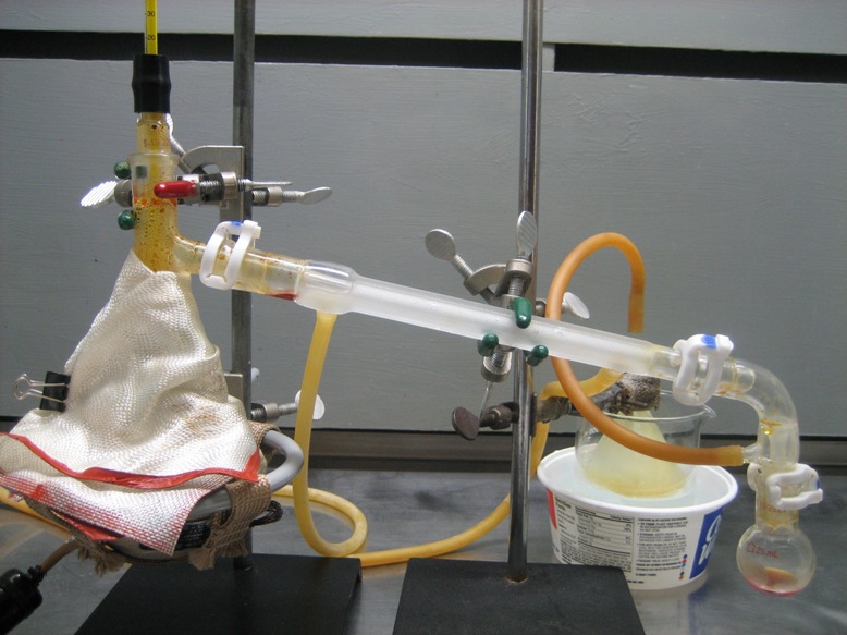

Today the product was placed in a 25mL RBF and distilled. The boiling point was 72C (literature 72.3C). The yield was 11.7g; the % yield on ethanol was 41.7%.

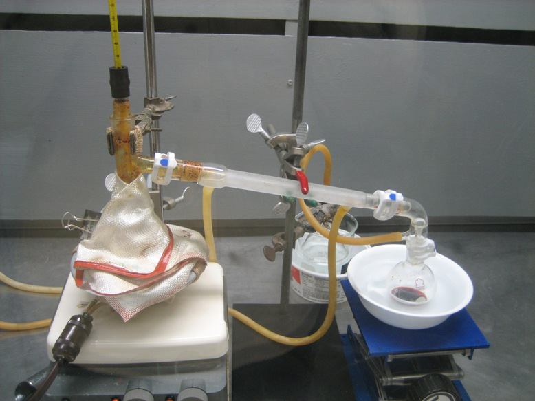

Thank you. With some reluctance I first tried the method in Brauer, ie, the use of H2S and I2. But this did not work well as my scale was so small. Also, I don't like making elemental iodine, then working with it - so messy and volatile, and stains everything. But even worse is working with H2S due to its stench and toxicity.
Also with some reluctance due to the phosphate polymer formation I then went to the method of Argox. This worked exactly as advertised. My %yield was low at 44%, but this was expected as I did not recover the HI dissolved in the gas trap, nor did I push the phosphate polymer production to the endpoint.
