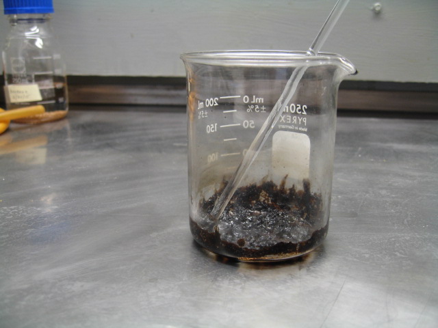

[*] posted on 28-6-2015 at 06:28
This synthesis appears to be a failure. Most likely what I have made is just a tar composed of polymerized catechol.
Here's what the product looked like. I meant to post this in the original post but forgot.
catechol reaction product - dried.jpg - 80kB

[*] posted on 28-6-2015 at 08:53
Then I added some NaOH and a little water just to clean out the beaker.
That NaOH should be worked on. Perhaps the toluene was unable to access anything it could dissolve.
