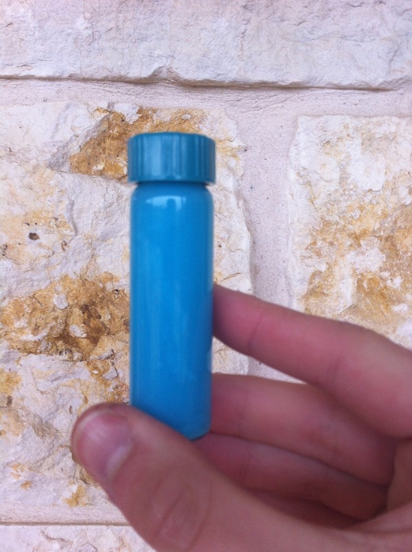

Bike Centrifuge
Today I was preparing some copper carbonate from copper sulfate and sodium carbonate, and wanted to centrifuge the product to speed up the separation. Since I don't have a centrifuge, I turned my mountain bike upside down and used it as a makeshift centrifuge, securing the vial with duct tape. It worked surprisingly well! Here's some pictures, before and after.
