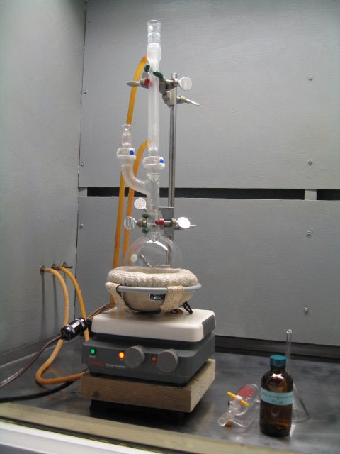

A. Saponification
32.9g KOH mixed with 32.9 ml H2O
DNBM 32.9g
The DNBM ester is first saponified with KOH. This was done by heating the reactants at reflux for 3 hours. A ml was withdrawn and mixed with a ml of
water. It completely dissolved. Therefore, per Vogel, I assumed the saponification was complete. The products are the potassium salt of the diacid,
n-butyl malonic acid, and ethanol.
saponification

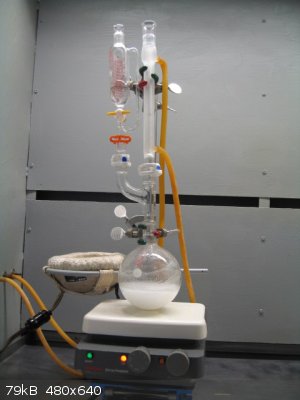

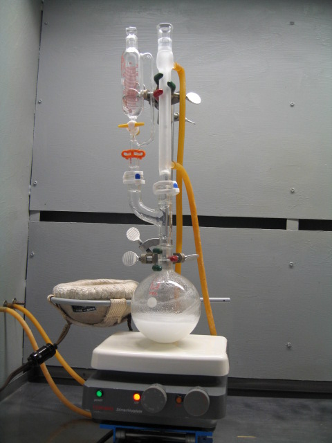

C. Decarboxylation
Add 36.2 ml con H2SO4 mixed with 71.3 ml H2O
The resulting diacid malonic acid is then converted to the monoacid n-caproic acid by heating at reflux for 4 hours. The reactants were clear for
about 2.25 hours. After this the mix was turbid indicating to me that a second phase now existed, ie, the water insoluble n-caproic acid. Following
this about a 3-4 mm layer of organic material could be seen floating on top of the aqueous phase.
decarboxylation

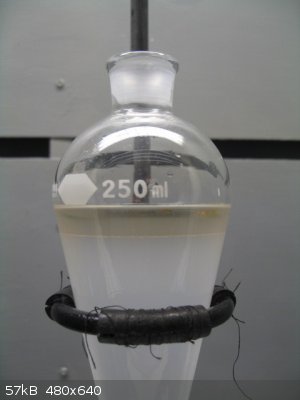

crude n-caproic acid separation
Brewster said to extract the aqueous phase with 3X100 ml of benzene. I substituted 3X50 ml of lab grade toluene. A literature source indicated that
the association constant for benzene is 96 and that for toluene is 94 (ref 4).
The combined crude n-caproic acid and the toluene extracts were then washed with 10 ml of water. Brewster specified 20 ml H2O. This where I ran into
problems. I expected the water to separate out as the heavier phase in a 2 phase system. What I got instead was two phases with the toluene on top
and a large phase on the bottom, apparently n-caproic acid and water.
I added 3g of NaCl to try and salt out the water. It didn’t work. Then I added several grams of anhydrous MgSO4 in a further attempt to salt out
or absorb the water. This also did not work.

This morning I added 1 ml of con sulfuric acid and shook well. The picture below shows what I now have. The upper layer is toluene, the middle layer
is likely n-caproic acid, and the lower layer is the aqueous inorganic salt solution.

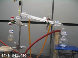

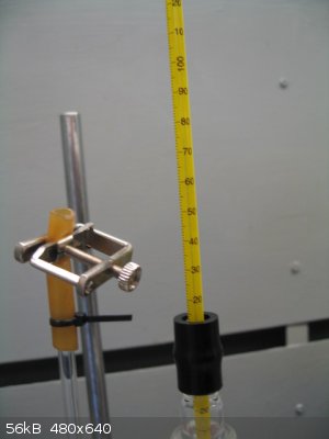

This n-caproic acid (n-CA) synthesis was completed this morning. After draining off the water the upper layer (toluene/n-CA) was filtered to remove
crystalline solids, likely MgSO4 hydrate.
The toluene was then removed by simple distillation. This came over at 88-118°C, the first portion being an azeotrope with water (bp 84°C) most
likely. At 118°C there was very little condensate coming over. There was a fair amount of foam but it was not a problem, as shown below.
foam during toluene removal

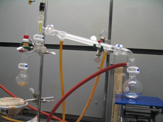

The residue was then subjected to vacuum distillation at 2 mmHg. The first distillate came over at 75°C as expected and held there for a few mls.
n-CA bp at P=2 mmHg
I stopped the distillation at 81°C. There was a few mls left in the pot as can be seen in the picture below.
recovery of n-CA by vacuum distillation
The final yield was 8.3g of n-CA. This is a 47.0% yield. It likely would have been better if the water wash/separation had gone well. Comments,
