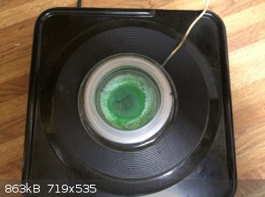

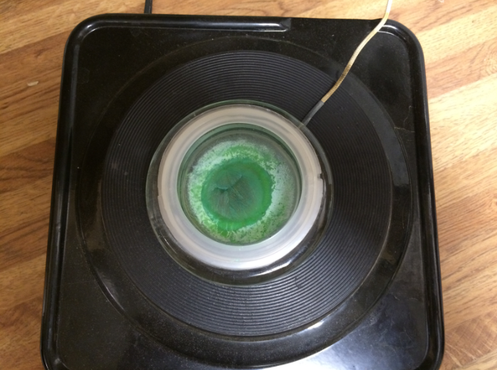

Disappointed at the trihydrate crystal attempt.. I added a bit of distilled water, stuck it on the hotplate above 30 C, and let it dry. The result looks way more like CuSO4 or CuCl2 with some white junk around the edges. It definitely doesn't have the deep blue of Cu(NO3)2
crystalized cuno32.png - 863kB
