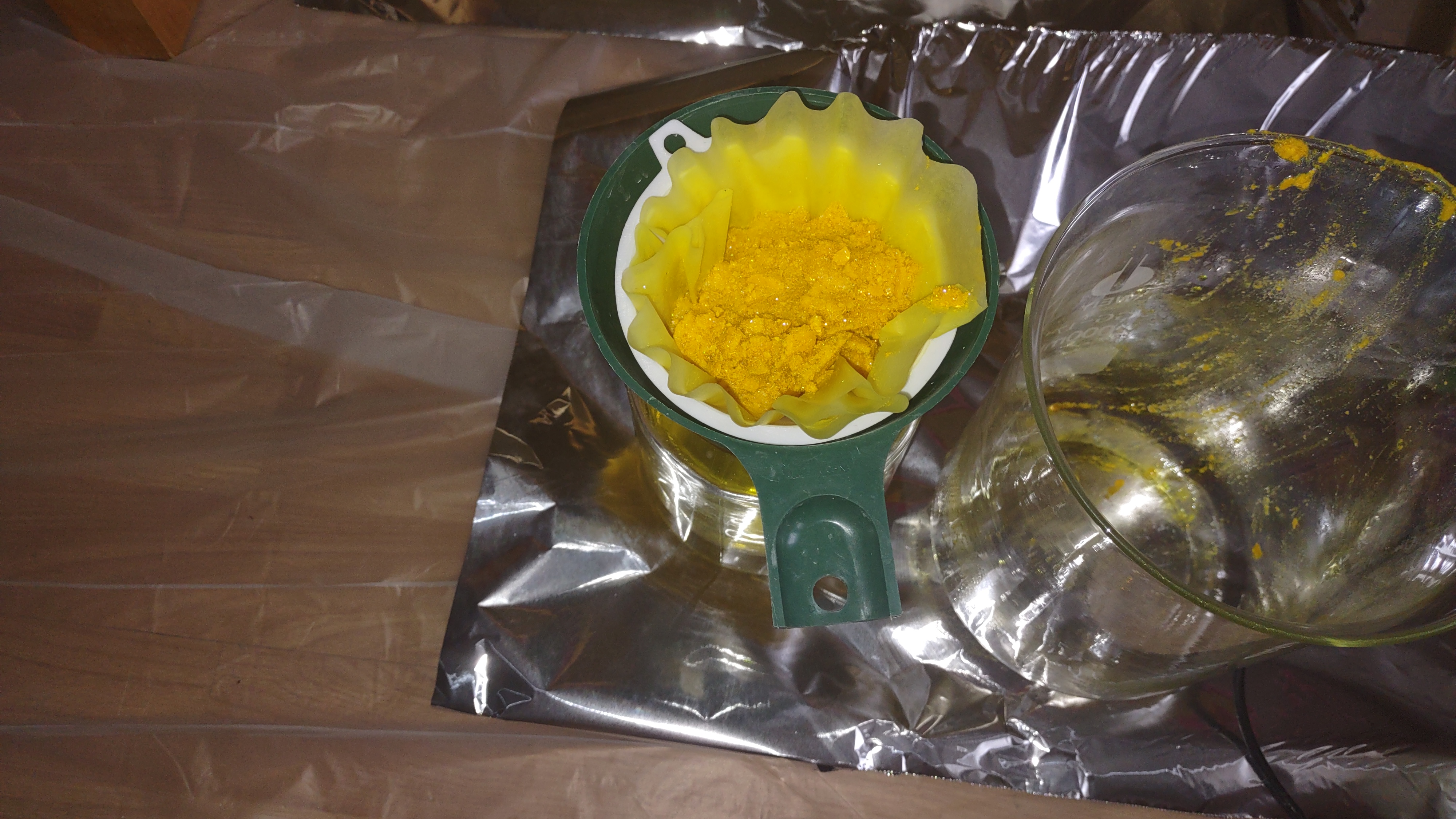

The picture is from my third batch. I will describe everything on what happened.
The synthesis went normal, but I used too much water and too much ice to crash the picric in, the result is I had almost no crystals filtered out. I decided to just boil everything down. Look up at the post where I have two pictures of my beaker, this is what I was describing. After filtering that stuff down, I boiled the stuff even more and I got what I thought was more picric, but it must have been REAL dirty since it was eating away at the paper filter.
I hated it so much that I neutralized it with sodium bicarbonate and just dumped the sodium picrate with large amounts of water down the drain. I hate having to do that, but this is not a good batch at all and I cannot mix it with anything else.
I hope my fourth batch doesn't suffer the same fate!
Ah I see, looks like you just tried to squeeze too much pout of that batch. What sort of yields are you getting? Once you are around 75% yield it is time to pull out.
Herr Haber
Posts: 1236
Registered: 29-1-2016
[*] posted on 14-12-2022 at 23:12
You cannot boil down the water in which you crashed your picric acid without also getting H2SO4 when you filter out your picric acid.
All the H2SO4 left from your nitration is still in there !
You say you are going to boil down 2100ml to 600ml. How much of this will be acid ? (All the acid you used)
Crash ---> Filter then do a recrystallization in distilled water.
This water you can boil and get a second crop.
B(a)P
Posts: 1139
Registered: 29-9-2019
Mood: Festive
[*] posted on 15-12-2022 at 02:15
Great catch Herr Haber, I was thinking we were talking about the first recrystallisation.
IMHO you don't need to crash the nitration mix when undertaking a picric acid synthesis.
Once the reaction is complete chill the mix down in an ice bath, or fridge if you have it, and leave it for a good few hours.
Then, as Herr Haber says, filter and start the recrystallisation.
When you do recrystallise, add less water than you know you need, take the mixture to around 100 C then slowly add water a little at a time while keeping the temp up until everything is dissolved (noting that you might have some crap in their that will never dissolve). If your solution is free of solids leave it to cool, once it is room temperature chill it down further for a few hours at least, then filter. If your solution has a little insoluble crap in the bottom decant into another beaker and do as above.
You probably already know it, but best not to stockpile too much of it.......

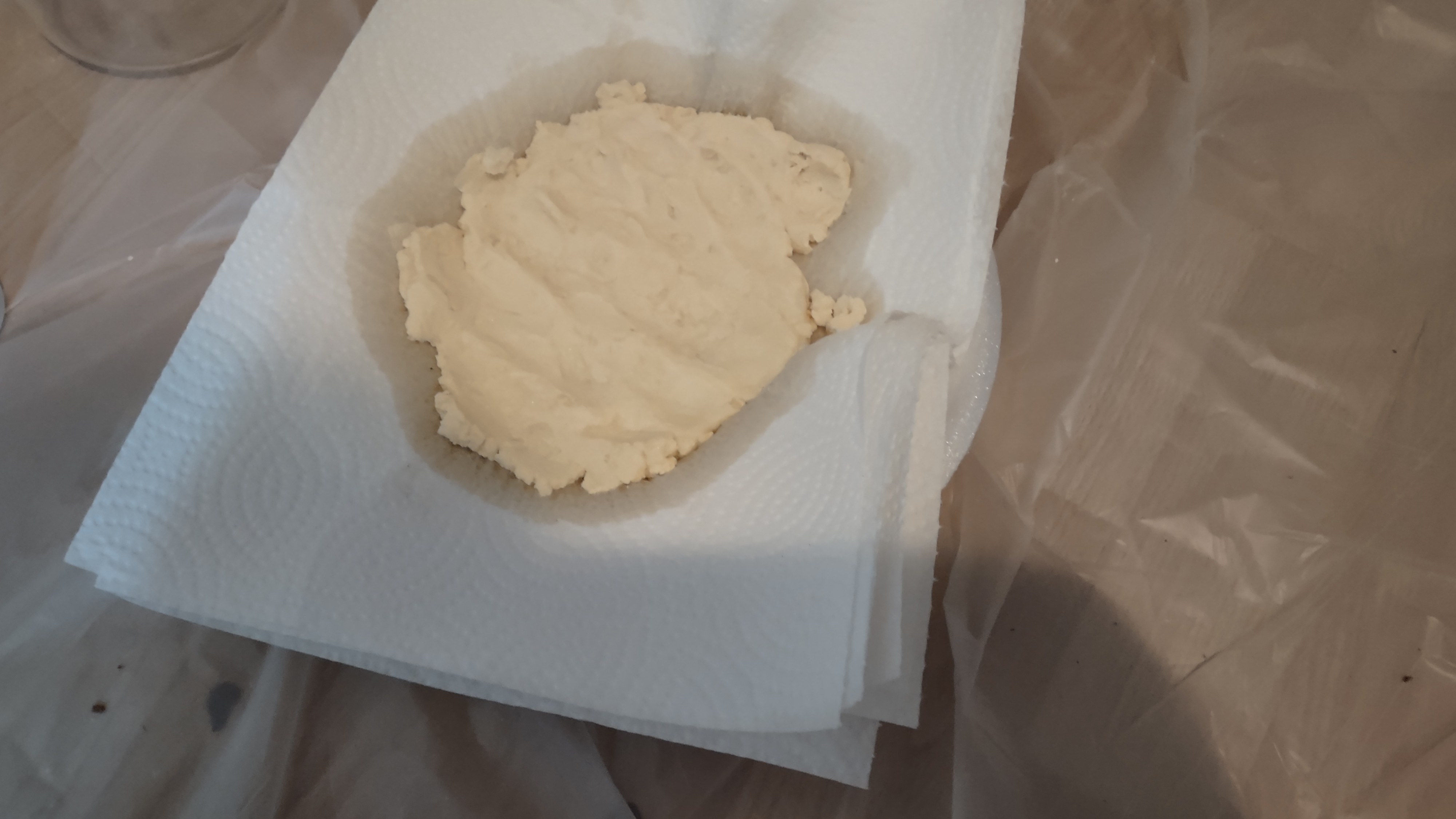

OK so I decided to put my updated notes for the future as I will have to hold off on making picric acid for a few days (the weather is too bad) and that attempt will be the final using my old batch. It will be january before I restart everything as I will have my salicylic acid by then and more sodium nitrate made.
The yield I got from the 75 grams of ASA was only around 18 grams of picric. I know what you are thinking 'that's impossible!' and I would be inclined to agree, but I didn't want to take any risks with the contaminated dirty stuff I put in there during recrystalization. I still need to recrystalize the 104 grams I got from my first two batches to make sure THAT batch is 100% pure. I might lose a lot, but given that I plan on doing many more synths in January that is an acceptable loss.
So to recap the steps based on everything I've learned so far. (I know I might have written something similar above, but just to reiterate).
1: Do the sulfonation and nitration. This time it will be with salicylic acid and not ASA. Add a bit more nitrates just to be sure it is getting enough (2 grams sodium nitrate per gram of salicylic).
2: let the nitrated mix cool down to room temperature on its own
3: put in fridge until it is very cold
4: add a little bit of water, then cool down again, repeat the process, use around 50% of the volume of the nitration mixture in water.
5: Filter
6: wash the filtrate slightly with ice cold water
7: Dispose of the left over liquid (dilute and add sodium bicarbonate)
8: Recrystalize
9: After cooling, filter out the crystals, and continue to boil down the liquid for more crystals until nothing is left.
By the time everything is good again, I should have my gas mask and everything. The weather will be cold as all hell outside but that should aid in other nitrations like RDX and PETN where the cold is necessary, and recrystalizations can be done indoors.

Rosco says to use 1.8 grams of sodium nitrate per 1 gram of ASA, would a similar amount work? Or is a little more needed? I assume the same amount of sulfuric acid is also appropriate?
ASA is 180.15 g/mol but salicylic is 138.12 g/mol. The absolute bare minimum NaNO3 per gram of ASA is 1.4 g to render TNP. That's just a technical minimum, you would want to use excess beyond that. Rosco's recommendation is actually only a little over a third in excess, which is likely enough, but you can increase nitration speed by increasing nitrate proportion even beyond that. Anything below 1.4 g NaNO3 per gram of ASA will result in dinitro product. With salicylic acid, the minimum amount of NaNO3 is 1.78 g per gram of SA. So if you use 1.8 g as with ASA, you are no longer in much excess, it is technically enough but it is close, the bigger your batch and longer the nitration time eliminates contamination of undernitrated product but environmental factors/errors/spills could still give you some dinitro product, short time of nitration would be the biggest cause of dinitro. For salicylic acid, 2 g or 2.2 g sodium nitrate per gram of salicylic acid would be more optimal. That way you are in greater excess for eliminating dinitro contaminant. Dinitro product will result in a fairly lighter color but mostly the dinitro is less reflective than TNP. Dinitro is much more mat and not so sparkly.
H2SO4 is already in excess enough to have no difference between ASA and salicylic acid, the 4 ml / g of ASA seems it should transfer fine to salicylic medium. If the extra nitrate causes too thick mix, you can add H2SO4 to thin it.
[Edited on 27-12-2022 by Hey Buddy]

[*] posted on 27-12-2022 at 21:08
So I will have to work differently to make sure that I get everything working. Once I have my all picric acid done, I will install a new thermoprobe for my mantle (I have another one on the way, which should work well). This will take a while since due to me breaking my 2 liter beaker (it is cracked only slightly, but I will not use it since it might shatter), so I will need a replacement. In the meantime I will probably just do some basic reagent synth until I get my salicylic acid. (I am almost out of nitrate salts)
I made the final picric acid synth with my old ASA supply. This time I will do it right. I can't do a recrystalization, but I will NOT reuse the mother liquor. I am letting it cool down to room temperature before putting it in the fridge to let it cool down even more before putting in 50% of its volume in water before filtering. No crashing it in ice this time!
Edit: After leaving it to cool overnight (room temperature) it is actually not even a slush anymore. It is much harder. I don't think putting it in the fridge is necessary at this point. let's see what adding water to it (slowly of course) will do.
Edit2: Ok so I added 100ml of ice cold distilled water (in three separate additions). There was some heating and a faint smell of NO2, but no major flash boiling or danger. I am waiting for it to cool down again before I will add another 70ml or so of water and cool down in the fridge before filtering it out.
So far I am finding this method is vastly superior to the crashing method. Thank you Xeon and Herr Haber for that. Once I get my supply of salicyclic acid and new 2 liter beaker I will definitely use this method going forward.
Edit3: After adding all the water and cooling it down more in my fridge, I filtered out the crystals. the water that came out the other side was quite reddish. I used only a little more water as some of the stuff was stuck at the bottom of my beaker, and I did need two filters as they both got pretty clogged with the picric acid sludge. I tried to get as much liquid out as I could. The paper is not tearing up like it was when soaked with sulfuric acid, but I do believe there is still some acid left that should be taken care off in the recrystalization (I won't boil down ALL the liquid, just do a two step. First to purify and remove the dinitro and mononitros, then a 2nd time to squeeze more out but leave around 150ml to make sure all the sulfuric acid is gone.
Either way the yield I am getting here is FAR bigger than any previous synth. I am very proud of what is happening so far. And they are all nice and yellow. Now it's just letting them dry out naturally and seeing if the papers are too acid afterward. There is still probably quite a bit of sulfuric acid that needs removing, but they will be removed in the recrystalization I believe. If they don't dry on their own in a few days I know that there is a lot of acid left over. This means the next time I do this I will need to add in an additional 50ml of water or so.
[Edited on 28-12-2022 by ManyInterests]

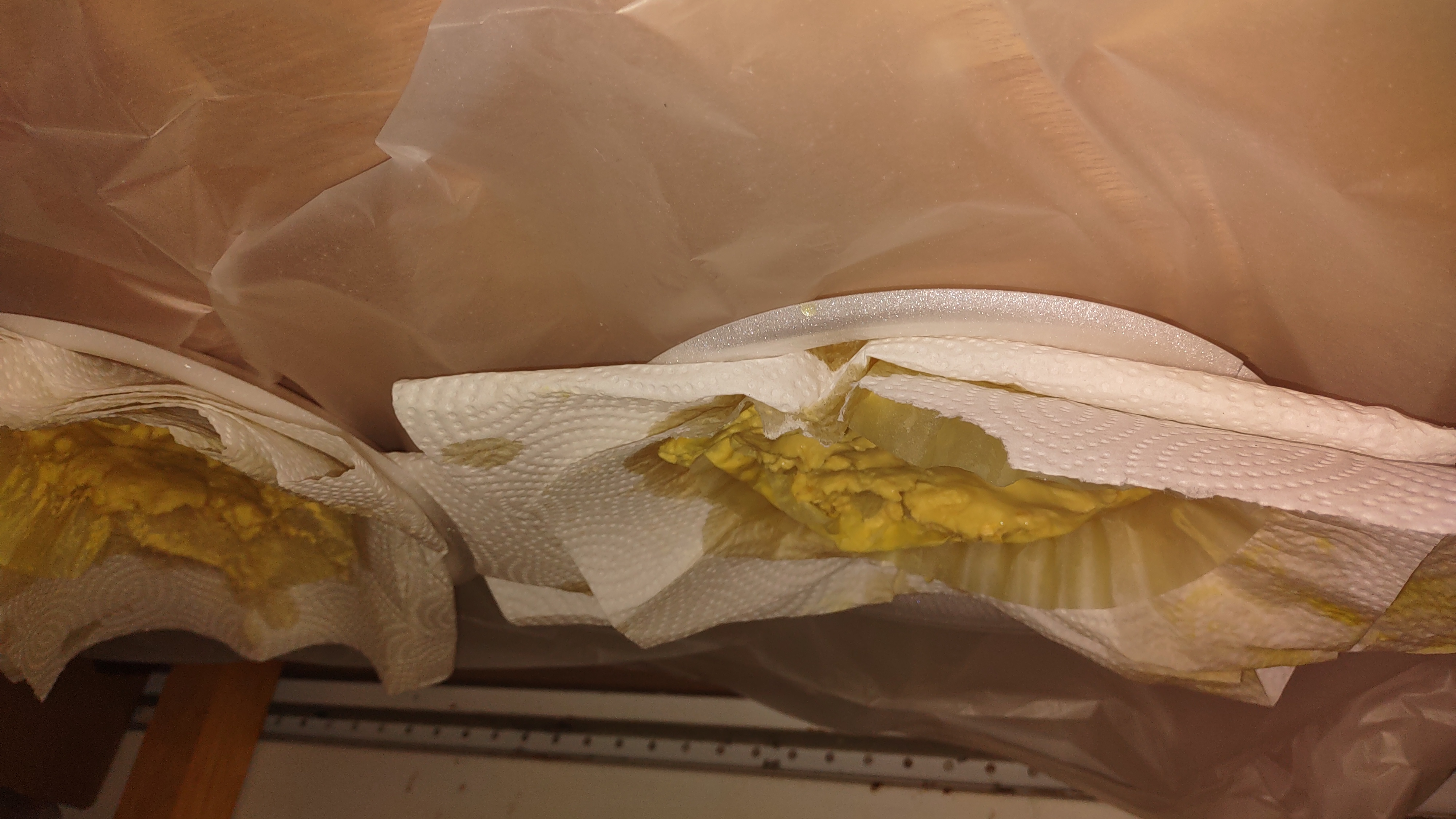

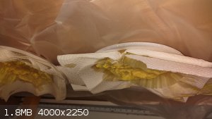

[*] posted on 30-12-2022 at 16:57
So after a couple of days of waiting, I realized that the sheets became SOAKED with residual acid. I am so glad I kept it under a vinyl dropsheet so I will not have to deal with any more stains on my floor (that big stain is probably not going away, but I will still try my best in the future to make it more unnoticeable).
I could have stood to wash my picric acid with a little more water. Not that much, maybe squirting like 60ml of ice cold water to force out more acid would have been preferable. I used very little water so I got a LOT of picric acid crystals. But there is still some undesirable acid in there, so I need to be very careful how I deal with it.
Next time I will add 200ml of ice cold water to start and won't be shy about washing it out with a little more to make sure everything is cleaned up. I want to start with as little acid as possible (if any) when doing the recrystalization step.

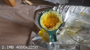

Just giving this a bump. Since I've received my new 2 liter beaker I decided to return to this project. I took out the old 104 grams I made and I decided to do a full re-recrystalization of them in order to get some consistent crystalize sizes. I dissolved them in 2000ml of water and I boiled it down to 400ml and I am just letting it cool. there are next to no impurities that I see (the water is supposed to turn red when you heat it up, correct?) so I am just going to let it cool down on the mantle to see what lovely crystalize sizes I get. I also really hope that the heat didn't degrade any of the picric. I just want to make sure... when you boil something in a solvent (like water in this case) the whole thing doesn't go hotter than the solvent, am I right here? I feel like I should know this already.
For the latest synth I made. I noticed that the paper towels because fully saturated with acid. I mean FULLY. When I changed them, those paper towels became saturated as well, I changed them about three more times I believe and they much dryer. This is a long way to get rid of excess acid (and I am assuming most of the sludge is picric acid infused sulfuric acid) but it seems like it did get rid of most of the unwanted sulfuric. I will obviously need to be a touch more careful when recrystalizing this one and I will leave around 100ml of water from that to throw away and I am banking on that bit having the last of the excess sulfuric acid.
Edit: After boiling the water from 2000ml to 400 ml the crystals that were leftover took on a reddish color. I assume this was due to the heat. Is my picric decomposed or is it OK? It seems that the crystals were quite pure. Some may have melted down during the heating as my heating is wonky (it have been the boiling point of water but also the melting point of picric).
I am convinced now that this is as pure as they will ever get.
I took the remaining water (around 350ml) and I will evaporate it down until it is around 150ml or so, filter off whatever crystals I find, then discard the remaining liquid.
