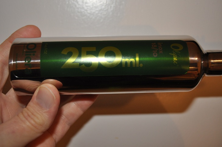

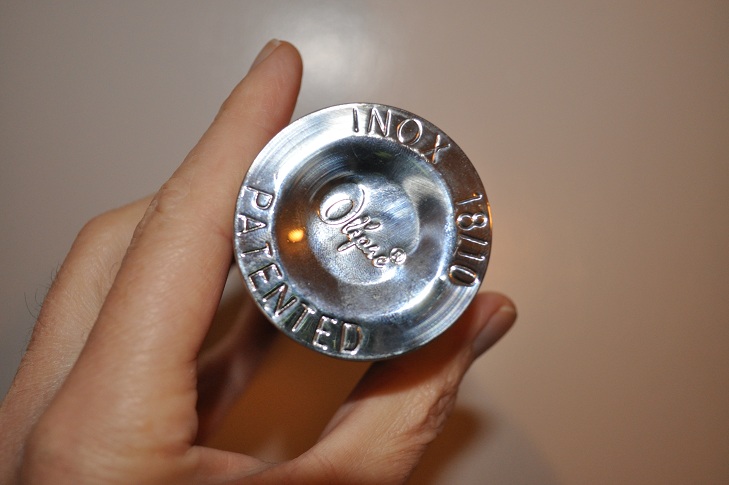

I bought a couple of these bottles today at a store called TJ MAXX. They are an 18/10 INOX stainless steel. The ones I bought are for dispensing olive oil with a spout and ribbed silicone stopper. What I like about them is how light they are with a mirror polish.
http://www.cookishop.com/olipac/11763-burette-inox-coffret-e...
http://www.olipac.it/gallery.html
http://www.cultivarplus.it/prodotto.htm
http://www.cultivarplus.it/bottiglia.htm

Just a tidbit I ran across when reading about 18/10 stainless steel used in the 250ml olive oil bottles I bought. They were $6.99 and just something to toy with or repurpose maybe.
"18/10' is a designation used on some cutlery and holloware as an alternative to '18/8'. This designation is claimed to indicate a better quality steel than '18/8', and is essentially the same as the '304 (1.4301) grade . In practice the "10" does not indicate an actual higher Ni content and is purely a marketing ploy."
http://www.bssa.org.uk/topics.php?article=91
"Chromium and nickel are more expensive than iron. There is a loophole in federal law allowing manufacturers to claim "18/10" if they are at least 8.3% nickel. Many take advantage of this to shave costs, even the high-end brands, so a lot of 18/10 is actually 18/8.3 which is basically 18/8."
http://chowhound.chow.com/topics/926275

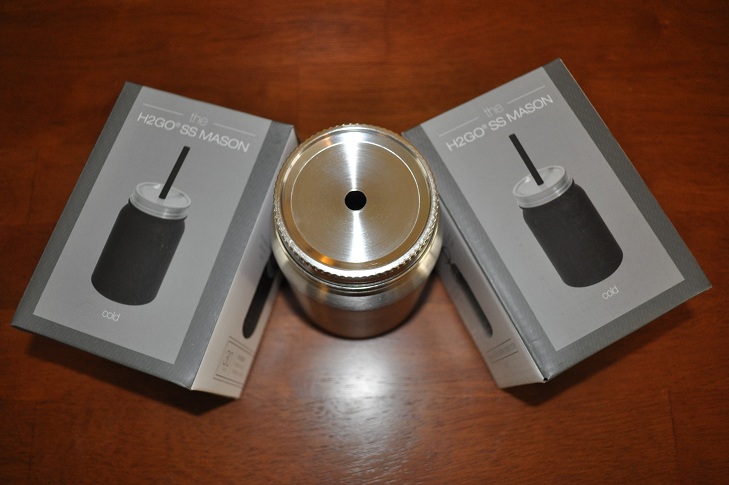

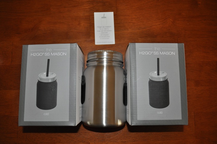

There's these Mason jars made of stainless steel with a silicone gasket - not all that exciting. I recall blowing the lid off one jar having a little too much confinement with a short length of tubing bolted to the lid and some methanol in the jar, sort of a sustained whoosh bottle attempt. The hole in the lid was enlarged somewhat by drilling it and adding the length of tubing via some threaded pipe and conduit nuts. Oddly the lid flexed enough during the "overpressurization" so that the lid still screwed back onto the threads of the jar tightly again without damage. Suffice to say the jar and single piece lid are very thin steel and if you blow the lid off, it makes a nice bang. ha
http://steelysdrinkware.com/product/steel-mason-jar-30-oz/
And some straws to go with it.
http://www.amazon.com/gp/product/B00AJG5E1U/ref=pd_lpo_sbs_d...
