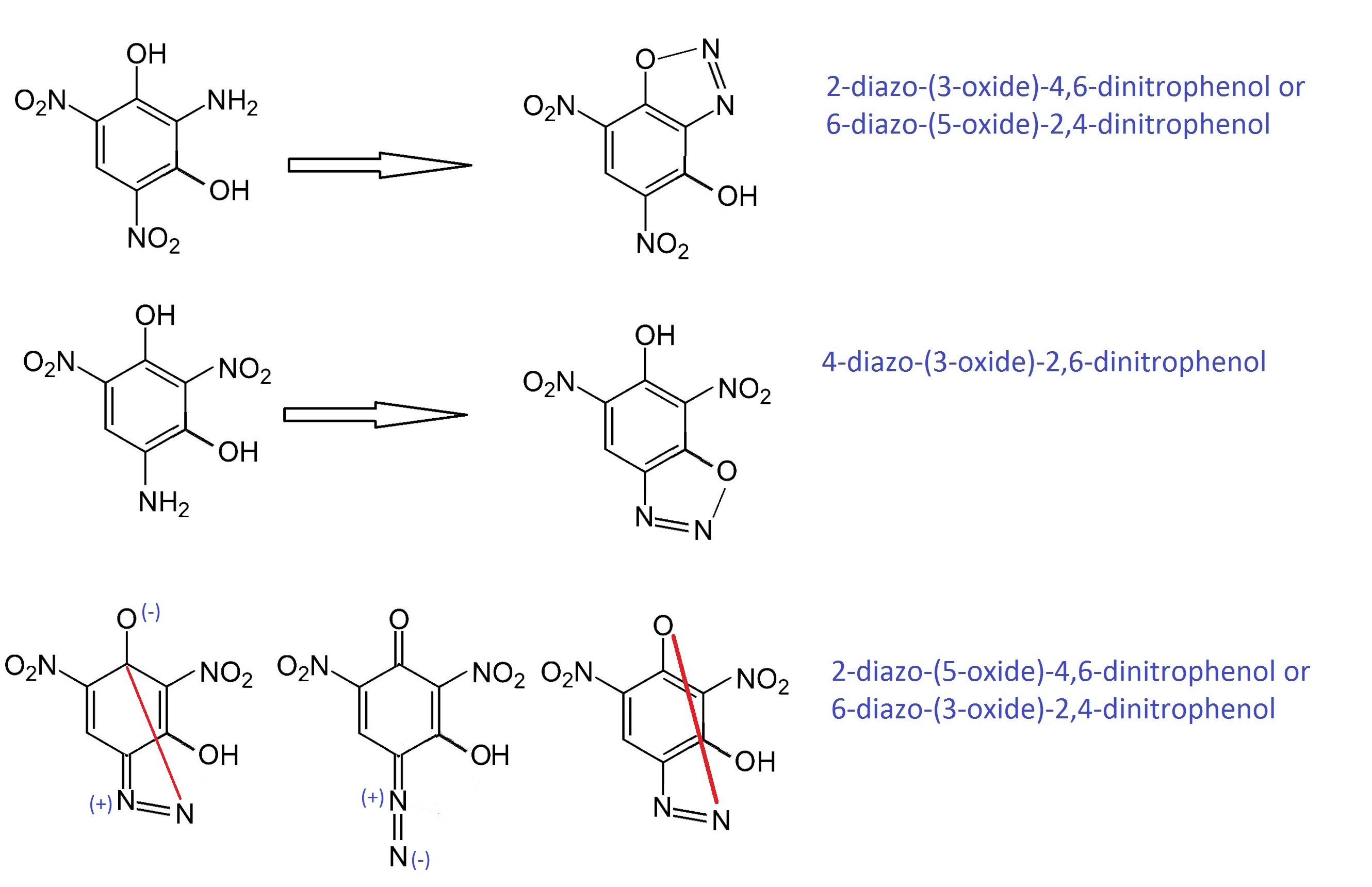

I'm really confused. If the argument is what I think it is...
Klapotke thinks the structure is 6-Diazo-3-hydroxy-2,4-dinitrophenol
aka 6-diazo-2,4-dinitroresorcinol
...and this fits the NMR...
Rosco thinks the structure is 4-diazo-2,6-dinitroresorcinol.
How is this different?
PHILOU Zrealone
Posts: 2894
Registered: 20-5-2002
Location: Brussel
[*] posted on 20-2-2017 at 17:23
You don't know? And stil you wrote correctly the two isomers...if they have different names...there is a chance those are two different molecules or there must be a reason...
A little drawing is better than a long speech so...
DDNRs.jpg - 218kB
Do you get the difference now?
Are they superimposable by flipping or rotating...?
No --> different compounds.
[Edited on 21-2-2017 by PHILOU Zrealone]

Rosco also believes that for DDNR the diazo-oxide forms straight across the ring as a para structure, not bonding with the hydroxyl that is ortho, adjacent as occurs for o-DDNP, but like the structure of the diazo-oxide found with p-DDNP. The tension across the ring bends the entire ring structure like a hexagonal spring wave washer being bowed by tension across its opposite vertices at para positions 1 and 4, and the diazo-oxide structure is the bowstring.
[Edited on 2/21/2017 by Rosco Bodine]
Simply ask and voilà added :D
The structure of trans-diazo is stil a bit mysterious...in reallity it must display a trans quinonoid structure so that both sides can bend onto the same side of the paper plane while the diazo connects to the opposite side...but connectivity is a bit hard to figure out. Into the book Traité de chimie organique Azoiques-diazoiques,.... they mention that the probable connectivity passes via a direct link between the N2 and the Cs on both sides thus without the oxygen being involved...a bit a cage structure related to DABCO(DiAzaBiCycloOctane) but with the Ns at other places and with unsaturations...anyway this is highly stressed...
DDNRs.jpg - 363kB
