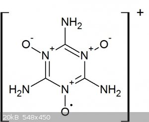

Yes, it does seem too good to be true, but that said, melamine definitely reacts even when very diluted in water. It might just be that melamine is 'special' in this regard.
/speculation
I have a sneaky suspicion that the melamine-hypochlorite oxidation proceeds via formation of cationic amine oxide radical on the melamine's ring nitrogen position (stabilised by delocalisation), hence the extreme bright red colour and very high solubility of that intermediate (thinking of TEMPO here). i.e. something like this:
melamine oxide cationic radical.jpg - 20kB
I think when you add more oxygen to that molecule, it simply can't hold itself together anymore and starts to break up with the fragments oxidising fully.
/speculation off
So yeah, while urea's carbamate nitrogen groups would probably be far more inert, I think it's worth a shot since I did get the melamine-hypochlorite oxidation to work.
