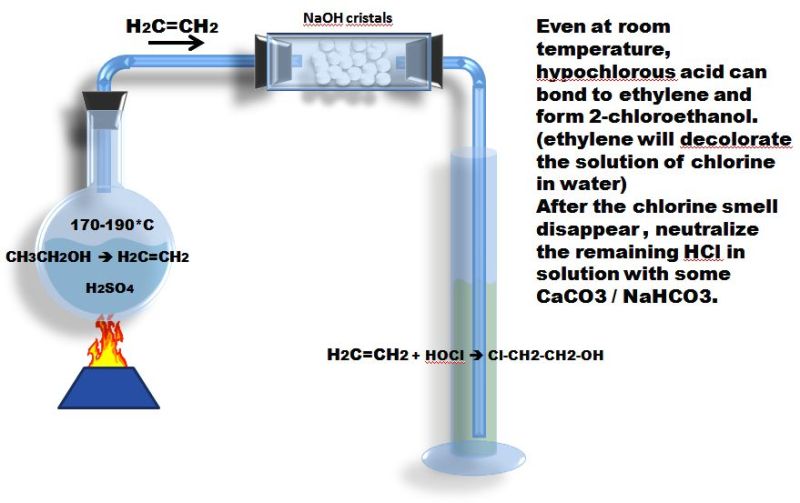

I tried something else with less expensive metals/compounds as silver and aluminium oxide:
reduction : CH3CH2OH --(H2SO4(>150*C)/-H2O)--> H2C=CH2 (ethylene)
oxidation : H2C=CH2 + Air --(Ag powder deposited on active charbon/azbest at 200-300*C)--> (CH2-CH2)O (ethylene oxide)
transposition : (CH2-CH2)O --(Al2O3 powder deposited as silver, at 200-300*C)--> CH3-CH=O (ethanoic aldehyde)
and seems to work...
also I can obtain ethilene oxide, through this process, wich is a extremly useful reagent :)

[*] posted on 17-4-2014 at 09:55

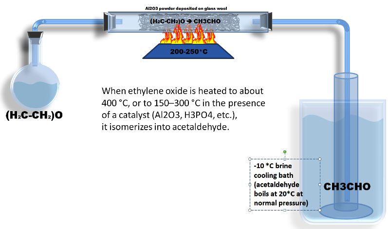

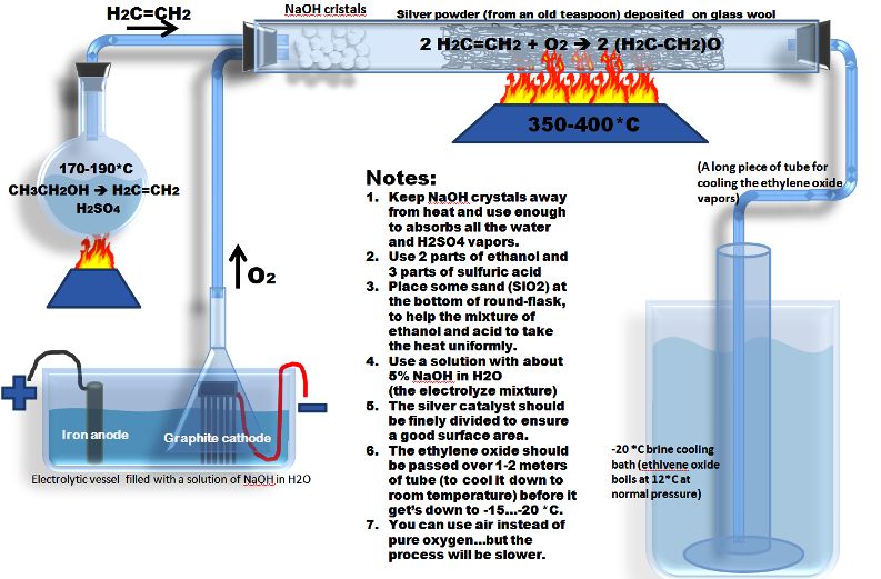

Here is a process of making acetaldehyde:
New Picture.jpg - 87kBNew Picture (1).jpg - 48kB
Crypto
Posts: 50
Registered: 18-11-2013
[*] posted on 17-4-2014 at 12:07
After reading the whole thread I must say that the above procedure seems to be the most practical for an amateur chemist. One could prepare the aldehyde practicly in any needed quantity during just one run. No toxic chromates are used which is nice and I guess that the catalyst beds could be placed one after another to omit the condensation step.
Thanks a lot Z. How did you deposit the catalyst on it's support?

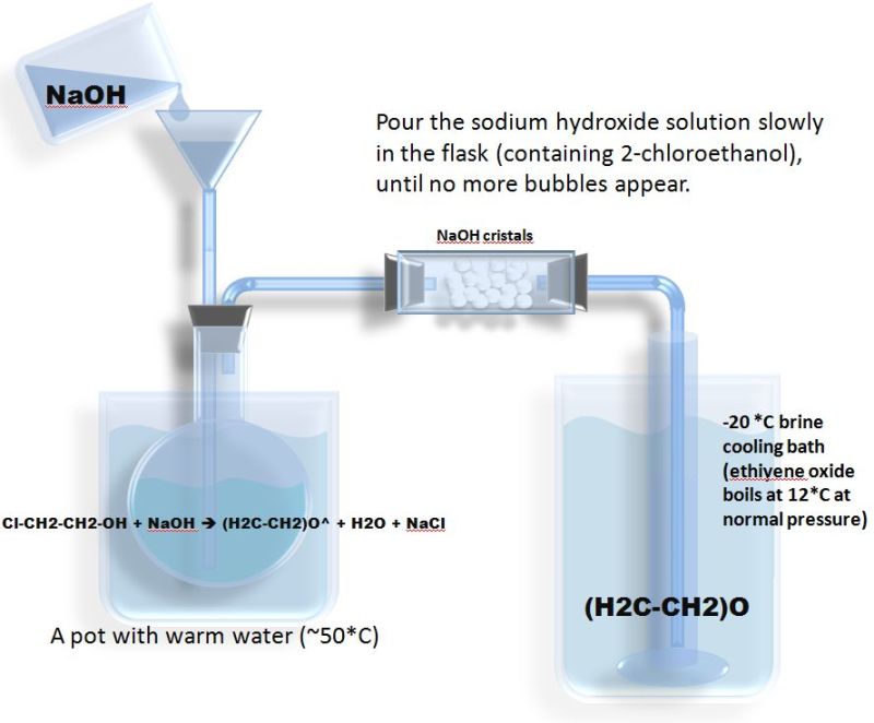

[*] posted on 17-4-2014 at 13:22

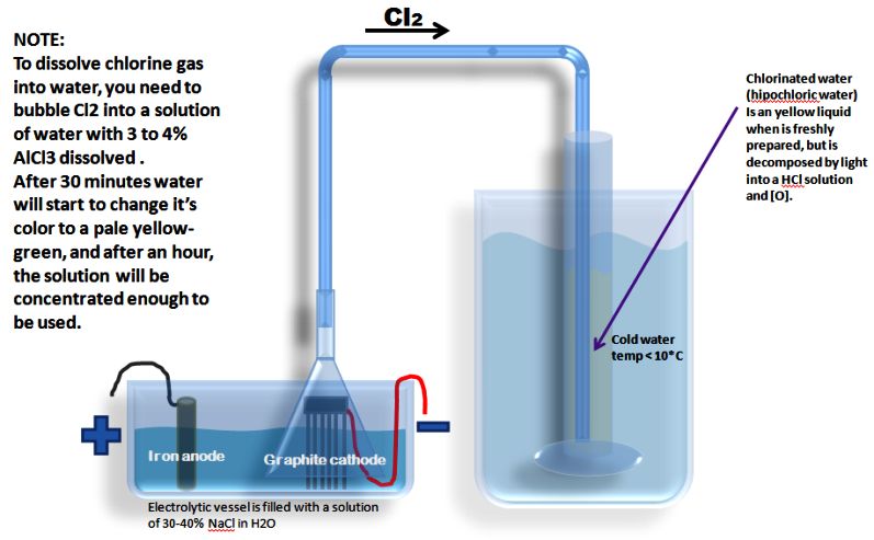

And here is the another process:
New Picture.jpg - 55kBNew Picture (1).jpg - 51kBNew Picture (2).jpg - 48kB

And the Ag powder / Al2O3 powder can be easily spread in the glass wool:
Take a piece of glass wool and pass it over hot steam. Then put it into a closed jar with some catalyst powder and give him a really good shake.
If you have problem with the silver powder (I remember that I have actually some problems, because silver must be powdered, not granules)... try this:
Put a piece of silver into nitric acid.
After it dissolves, wash in the solution of AgNO3 some copper wool (from electric wires) until a silver film start to form on copper.
Now you have the silver powder on copper wool ;)

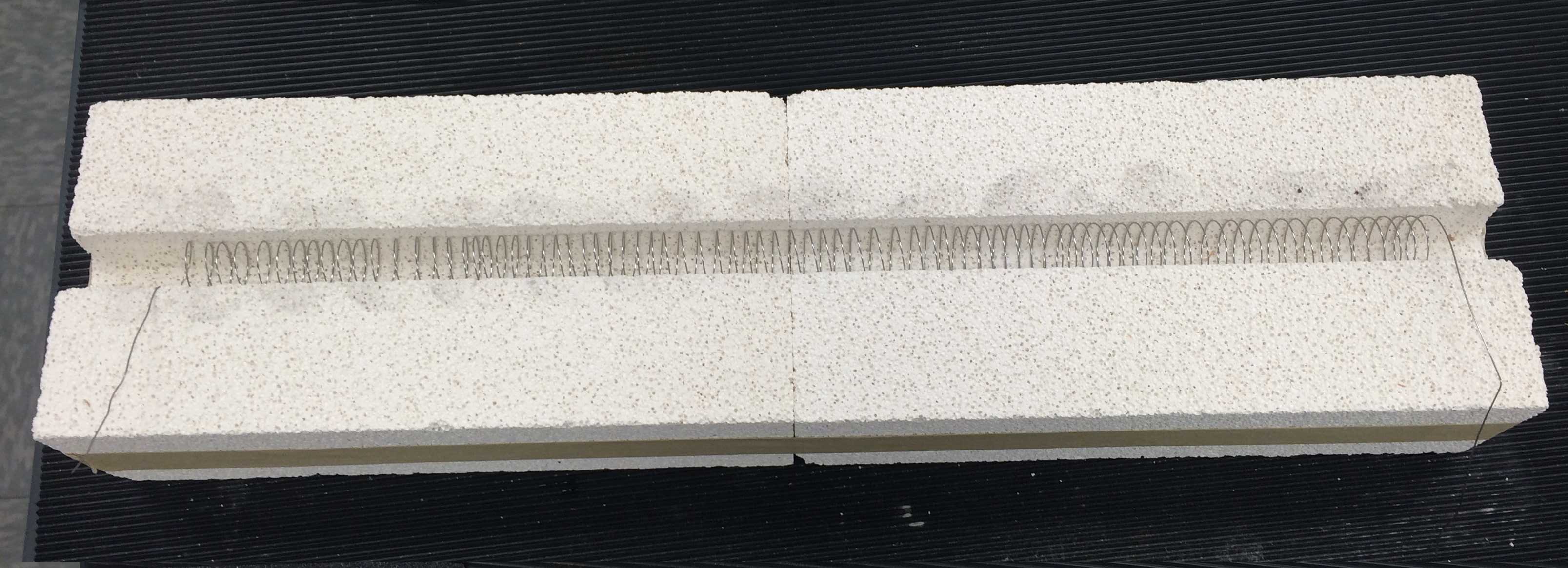

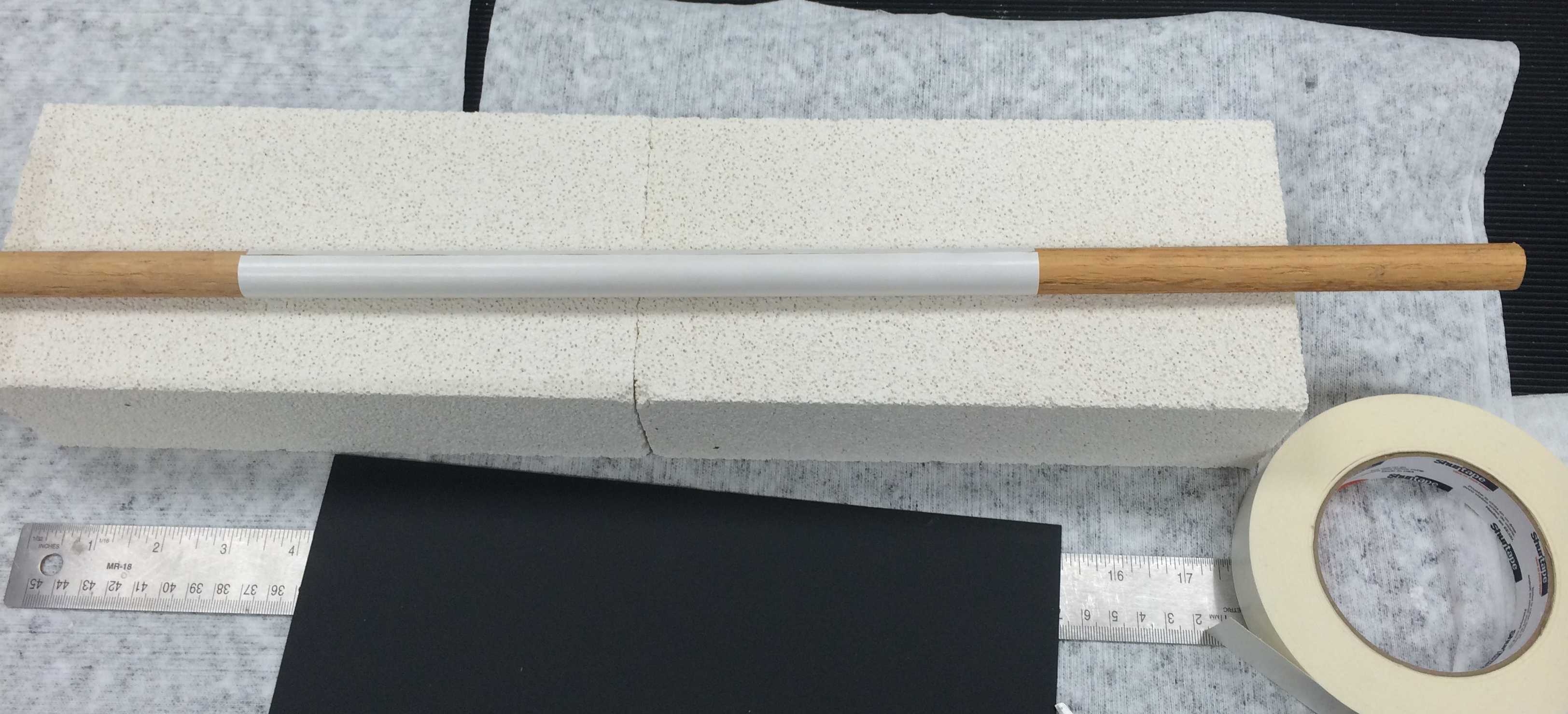

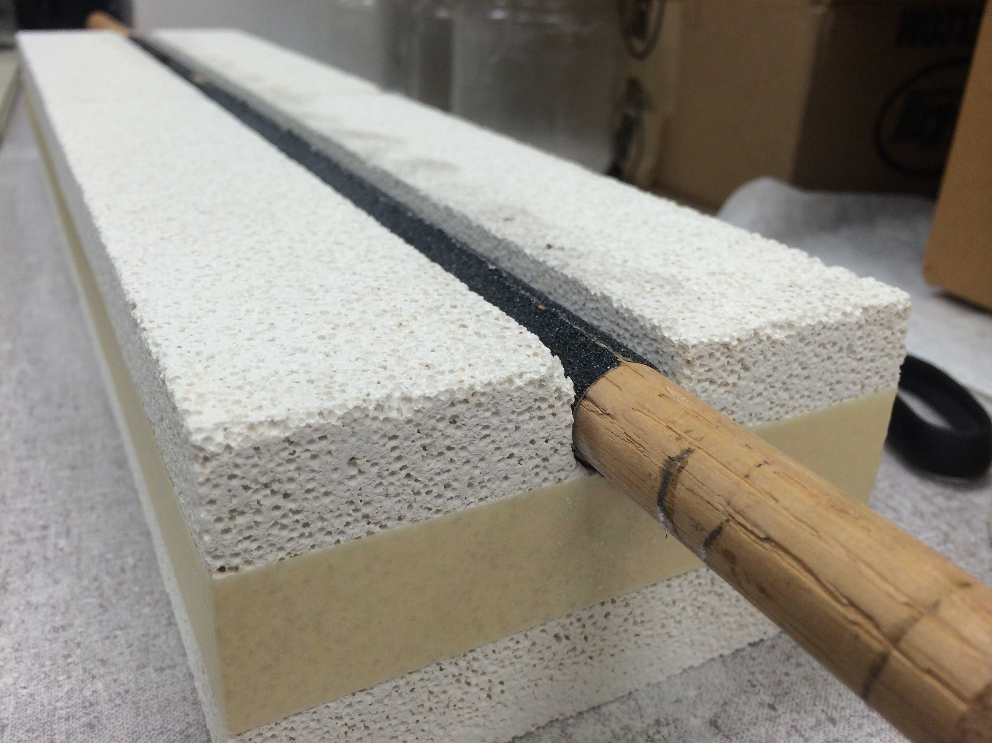

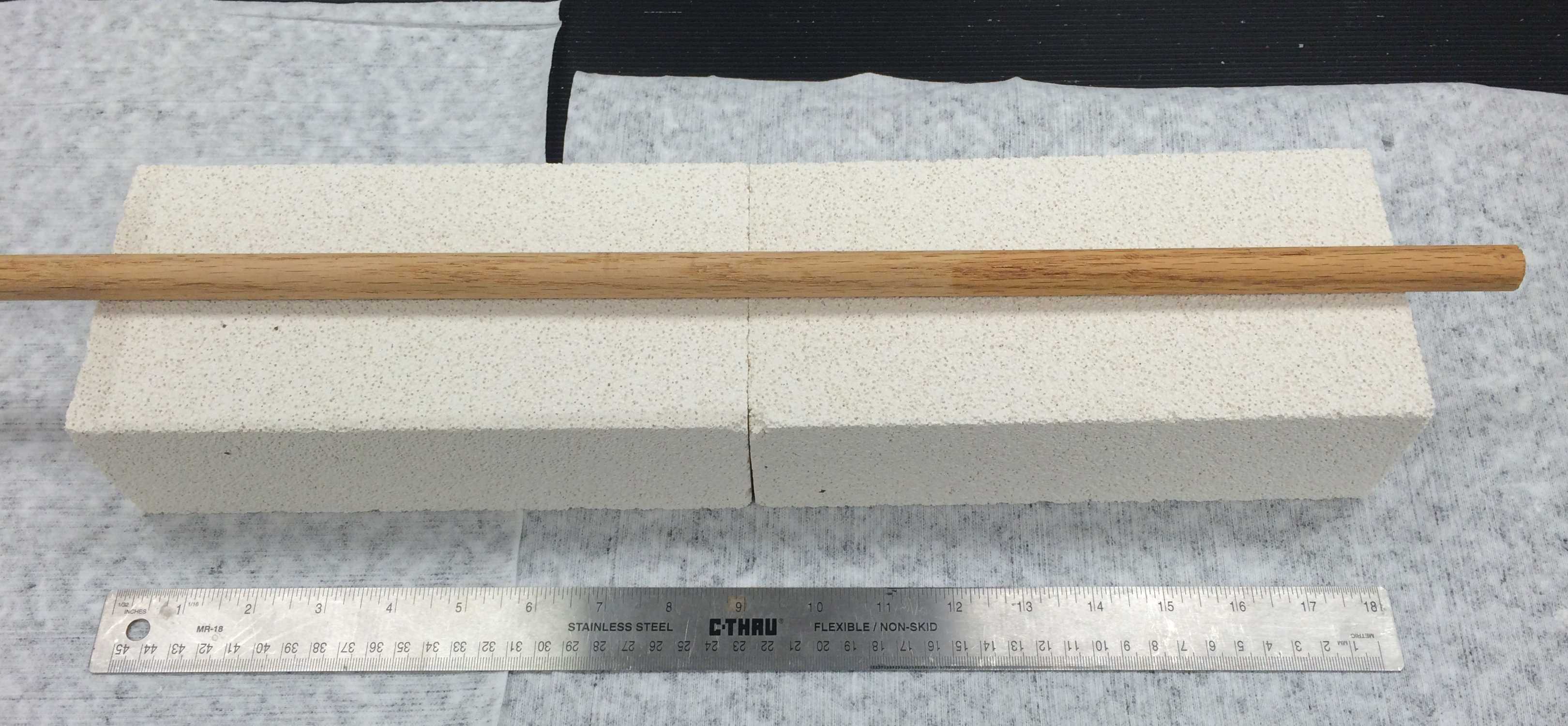

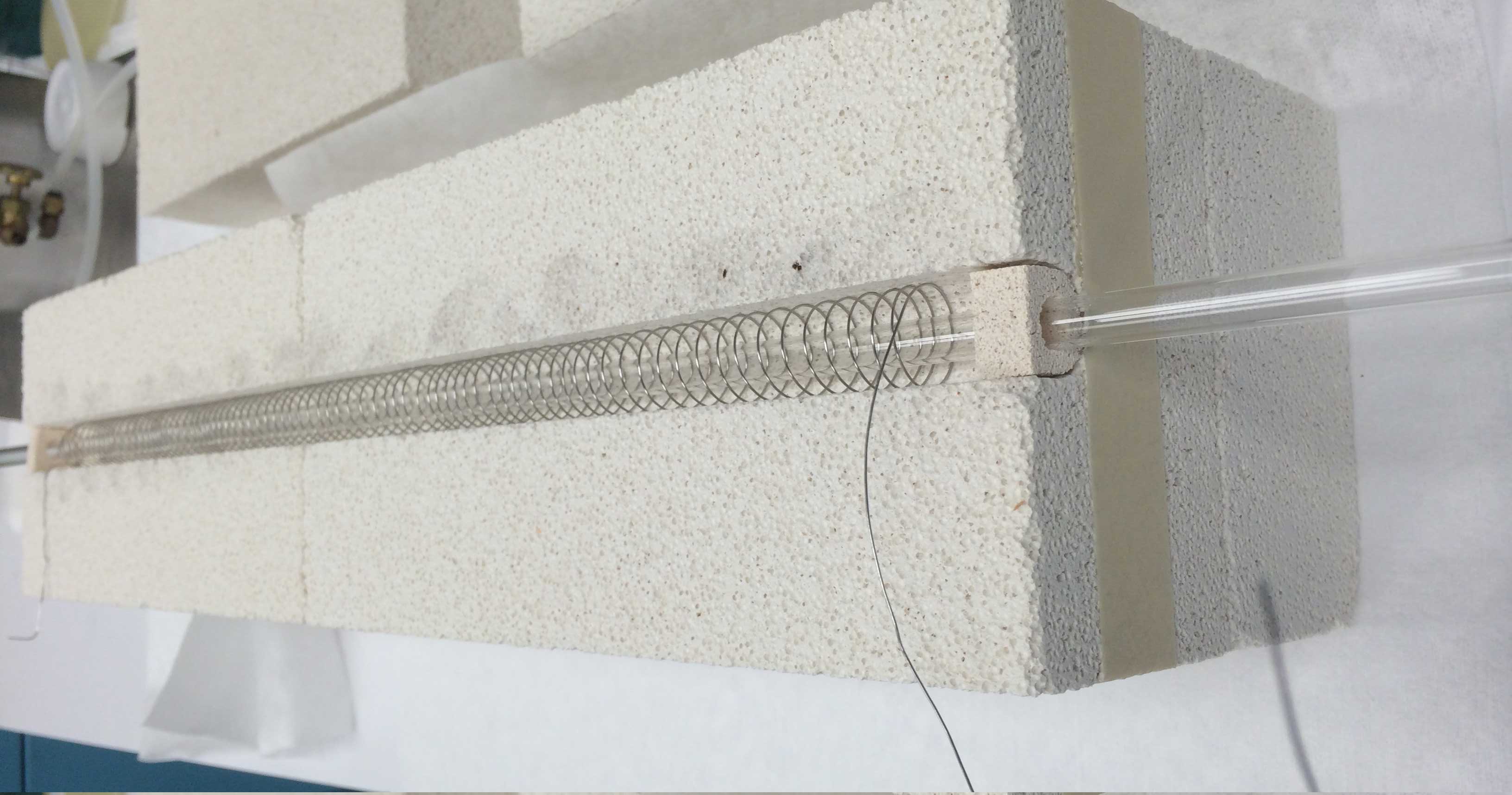

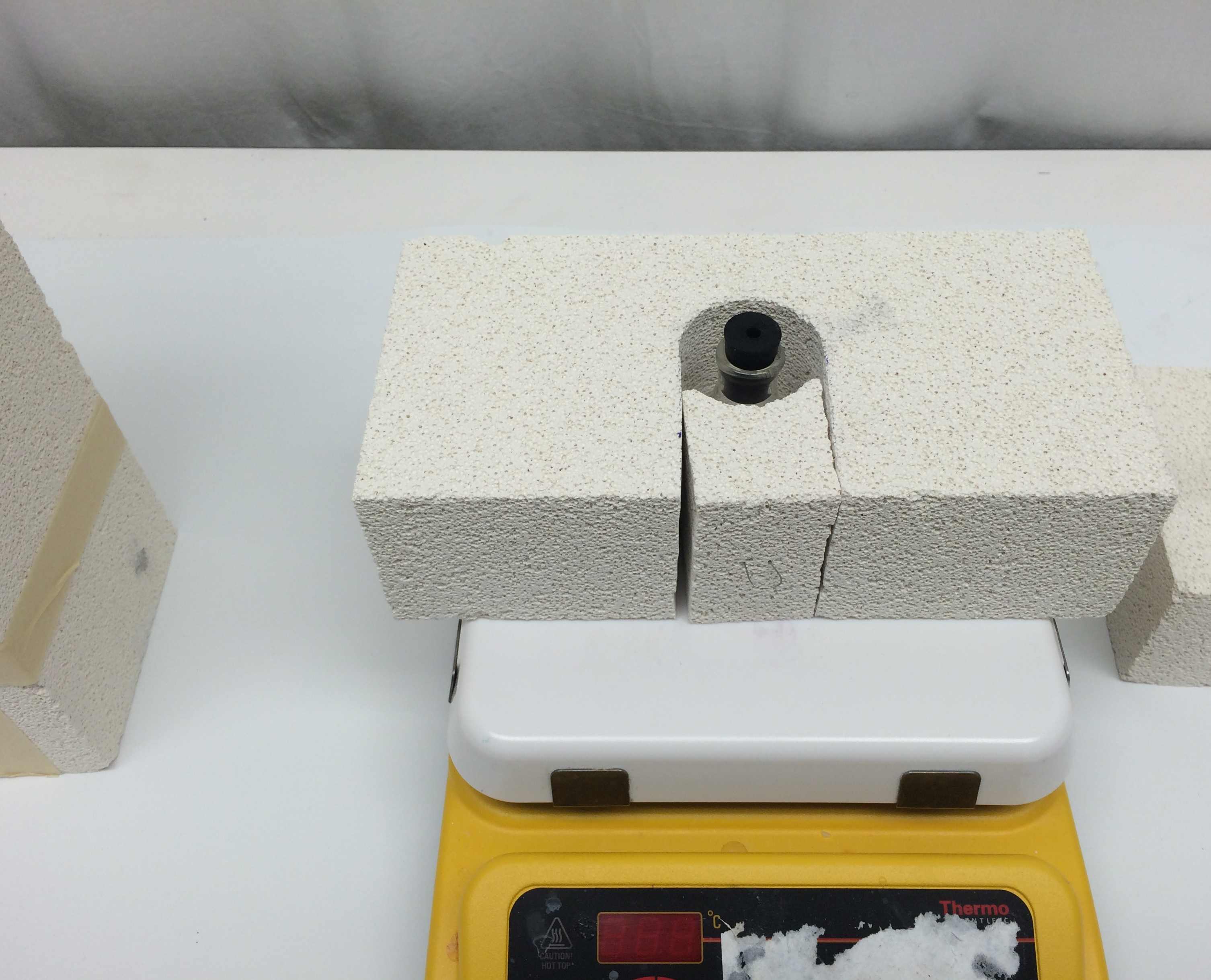

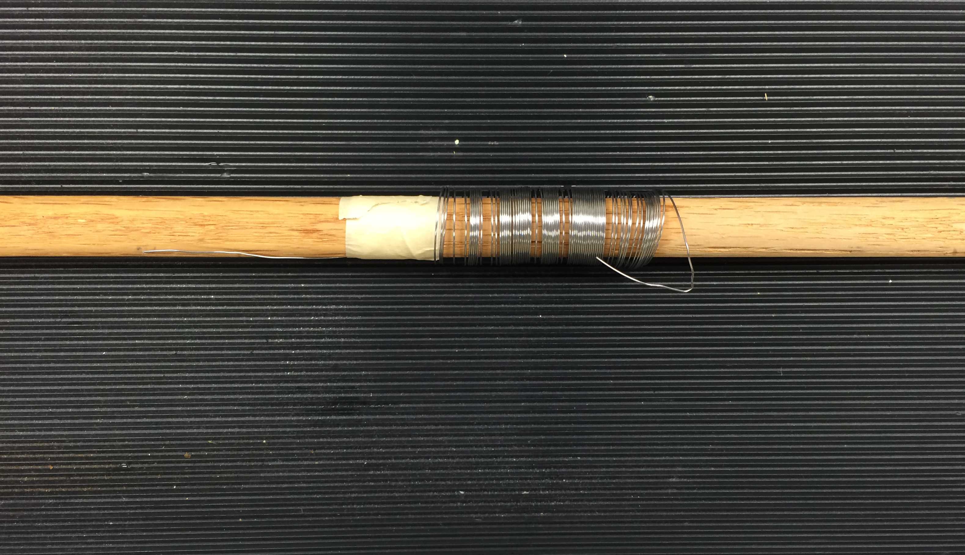

As the end of the school semester approaches, I find myself with less and less free time in the lab. For this reason, this project is not documented as well as I would like to have it. Along the thread of ethyl alcohol direct dehydrogenation, I'm posing some pictures of how I assembled a single bead string reactor. It has some issues. For one, I would probably choose to replace the glass reactor tube with a similarly sized stainless steel one. Stainless has a bit more elasticity, and is easier to bend safely. Like glass, stainless has low thermal conductivity for a metal. Also, I can more easily braze stainless fittings together than I can fuse borosilicate glass. Thermal shock is not as hazardous with stainless, either.
I tried some initial experiments dehydrogenating alcohol with this set up. The reactor and catalyst are doing their respective jobs, but a better configuration is needed in order to vaporize the alcohol (without superheating the liquid), as well as a better set up to condense and separate the product from the excess alcohol. The excess alcohol also needs to be automatically sent back to the vaporization unit. As such, this design mainly serves to give others ideas; it is not a finished project intended to be used as a cookbook design.

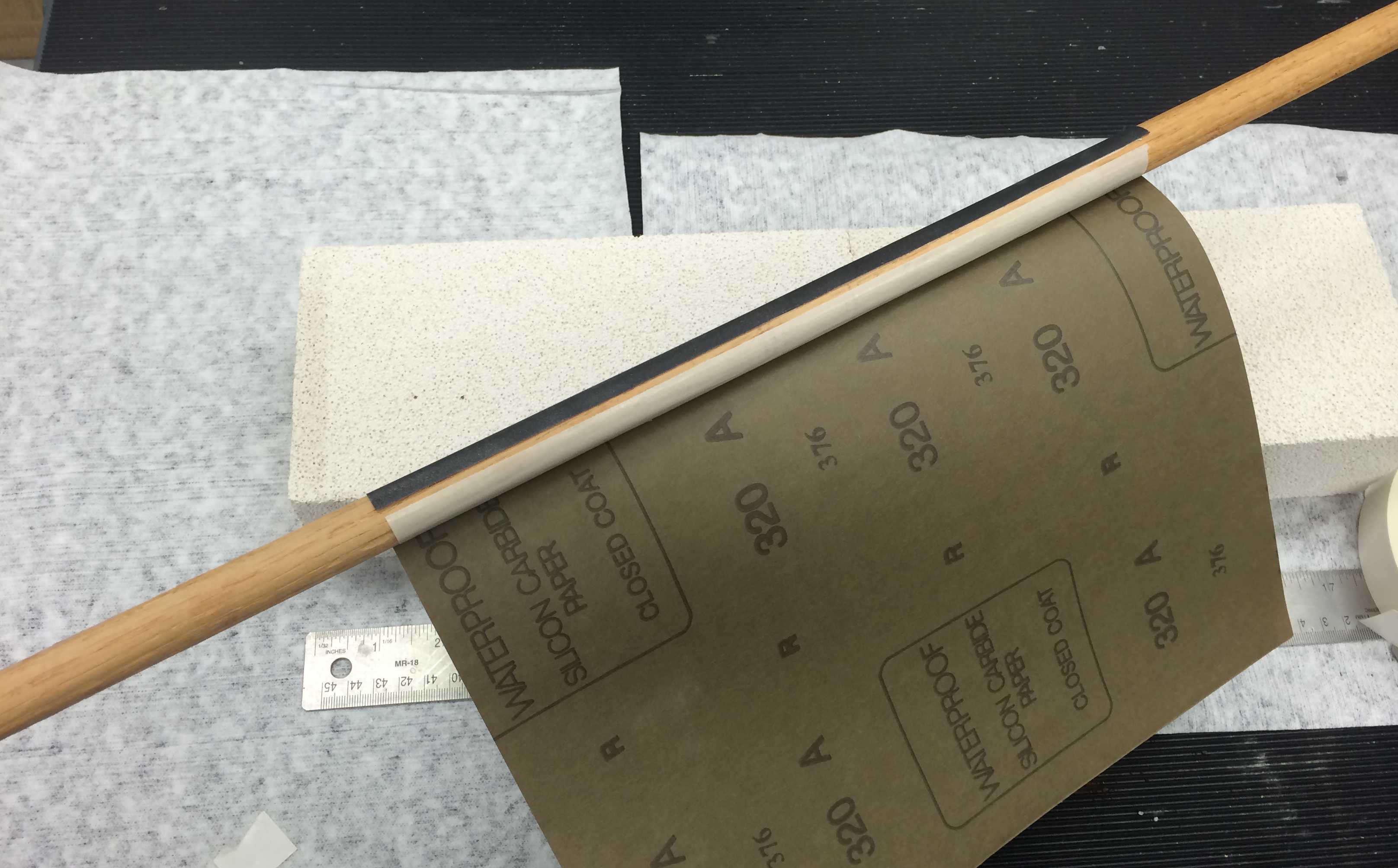

A wooden dowel is covered with two-sided adhesive tape, and sandpaper is wrapped around the dowel one time (80 grit is used instead of 320 grit; 320 grit is unnecessarily slow):
IMG_0321.JPG - 394kB IMG_0323.JPG - 321kB IMG_0324.JPG - 343kB

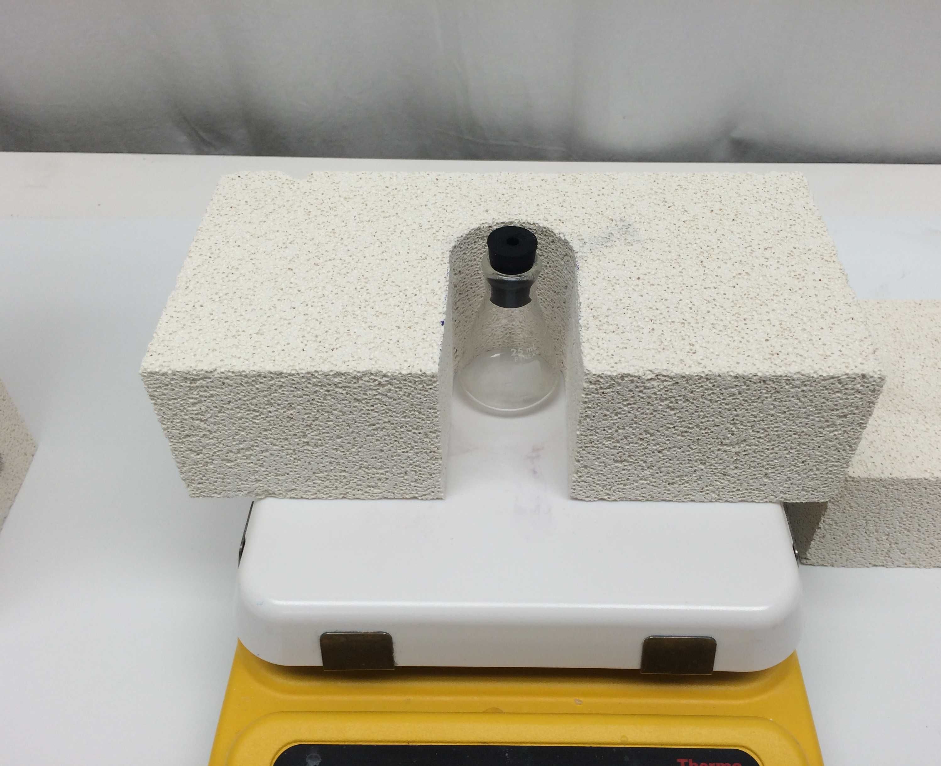

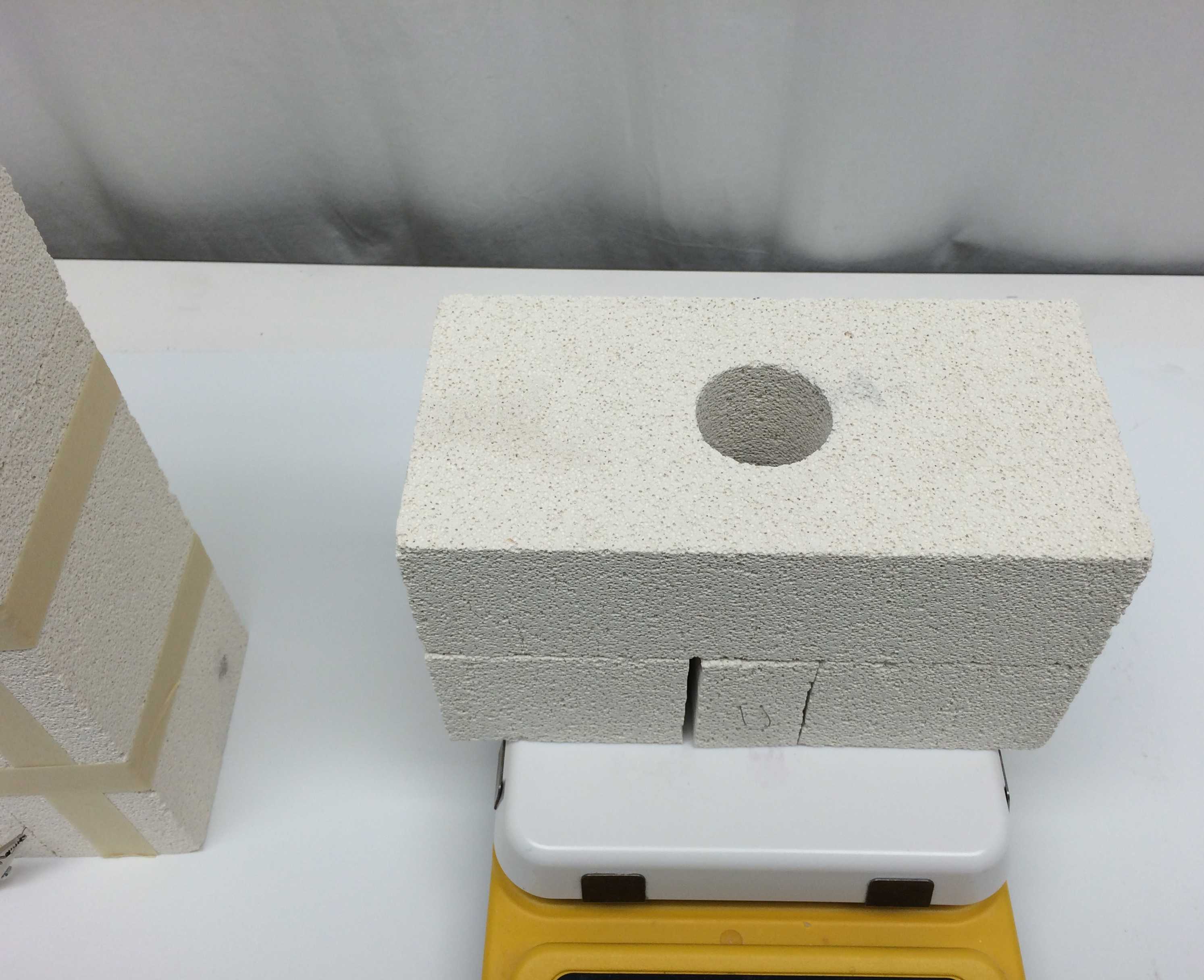

The finished dowel with 80 grit sandpaper is used to sand a groove into the fire-bricks (2300F type), pausing to vacuum the dust from time to time. Afterwards, Kanthal resistance wire is wound tightly around the same dowel.
IMG_0328.JPG - 359kB IMG_0330.JPG - 353kB IMG_0332.JPG - 523kB

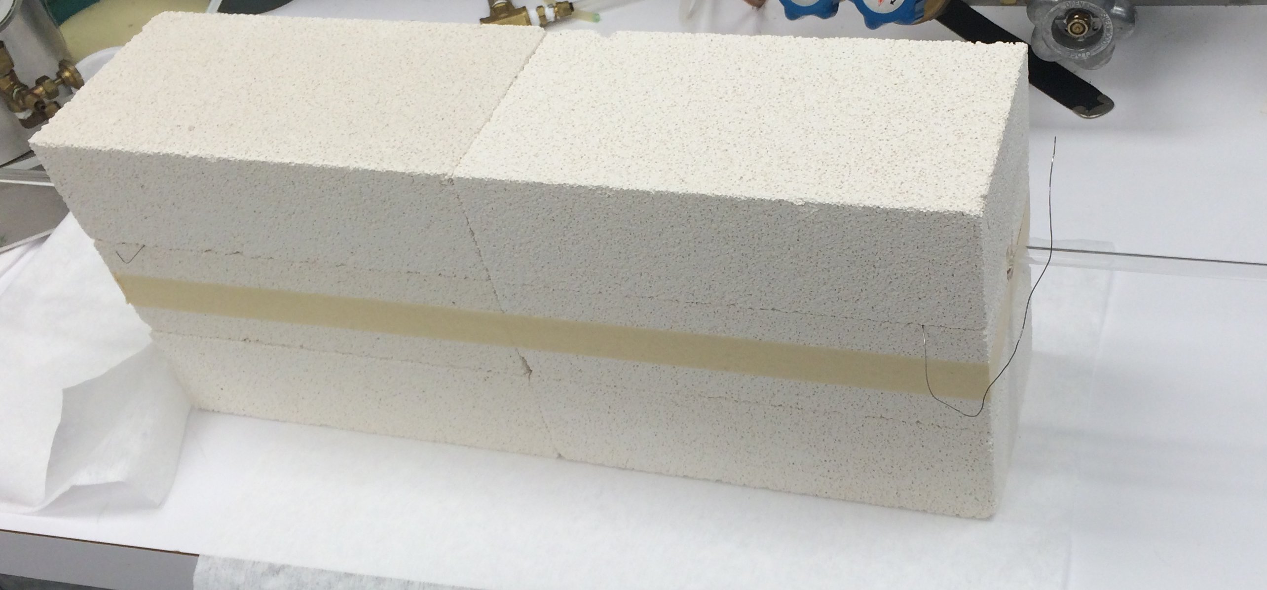

The wire loosens up once tension is removed from it. The coil is grasped on either end, and carefully stretched out to the correct length. The coil will be a little loose on the dowel, and will not fit into the fire-brick. To remedy this problem, one end of the coil is taped to the dowel, and the other end is held loosely to the dowel with one hand, while spinning the dowel with the other hand. This easily tightens the coil around the dowel, and it can now be fit into the fire-brick. Once the coil is untaped from the dowel, it will expand out slightly in the fire-brick, unspinning a few times. Space out the turns a little if this is necessary. Finally, two more fire-bricks are placed on top, leaving the wire ends hanging out from in between the bricks.
IMG_0333.JPG - 318kB IMG_0335.JPG - 268kB IMG_0336.JPG - 324kB

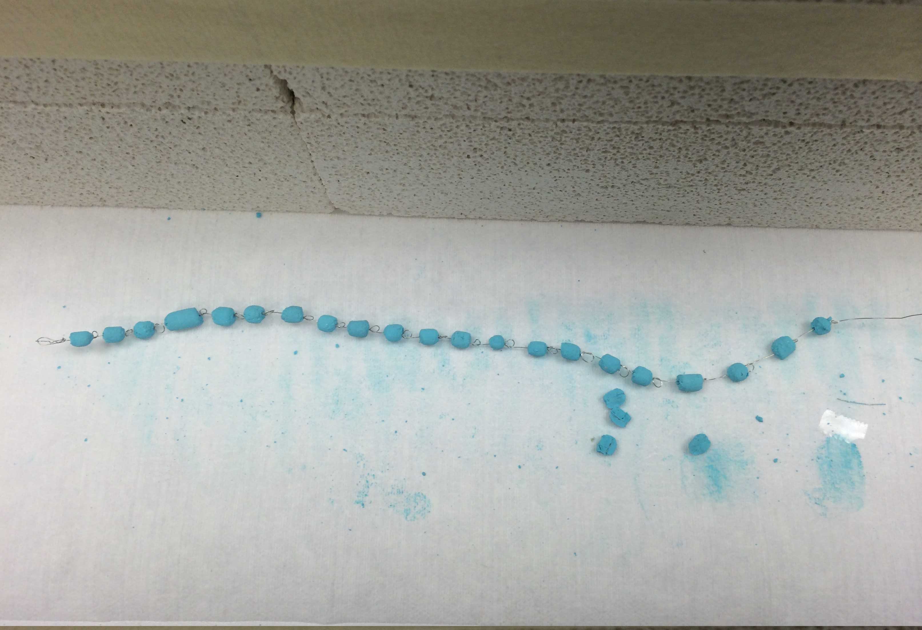

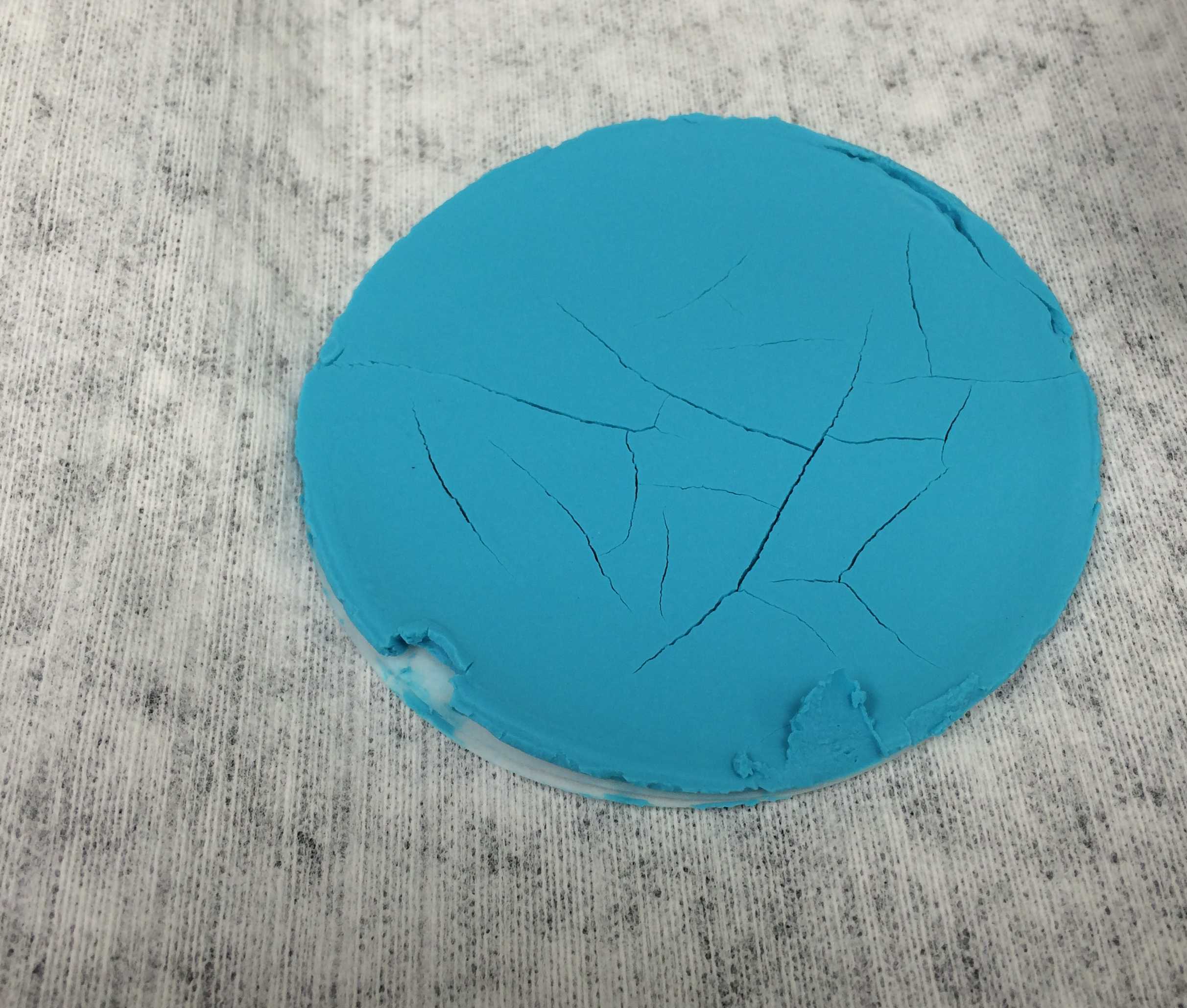

Copper sulphate pentahydrate and magnesium sulphate heptahydrate (Epsom Salts) have almost the same molar mass. Prepare a supported copper catalyst by weighing out 5 parts of copper sulphate pentahydrate to 1 part of magnesium sulphate heptahydrate by weight. Dissolve this in cold water with heavy stirring, and precipitate the hydroxides with a stoichiometric amount of sodium hydroxide. Filter and wash the blueish precipitate on a Buchner funnel with vacuum. Don't allow the precipitate to dry fully. While still damp, form small beads with the precipitate. Thread the beads on thin copper buss wire like a necklace, leaving small loops in between each bead to space them out. When dry, the beads will shrink roughly 50%. The dried beads should be about 70-80% the inside diameter of the reactor. Experience (and a mold) will help determine the correct size of the wet beads.
IMG_0338.JPG - 360kB IMG_0341.JPG - 295kB

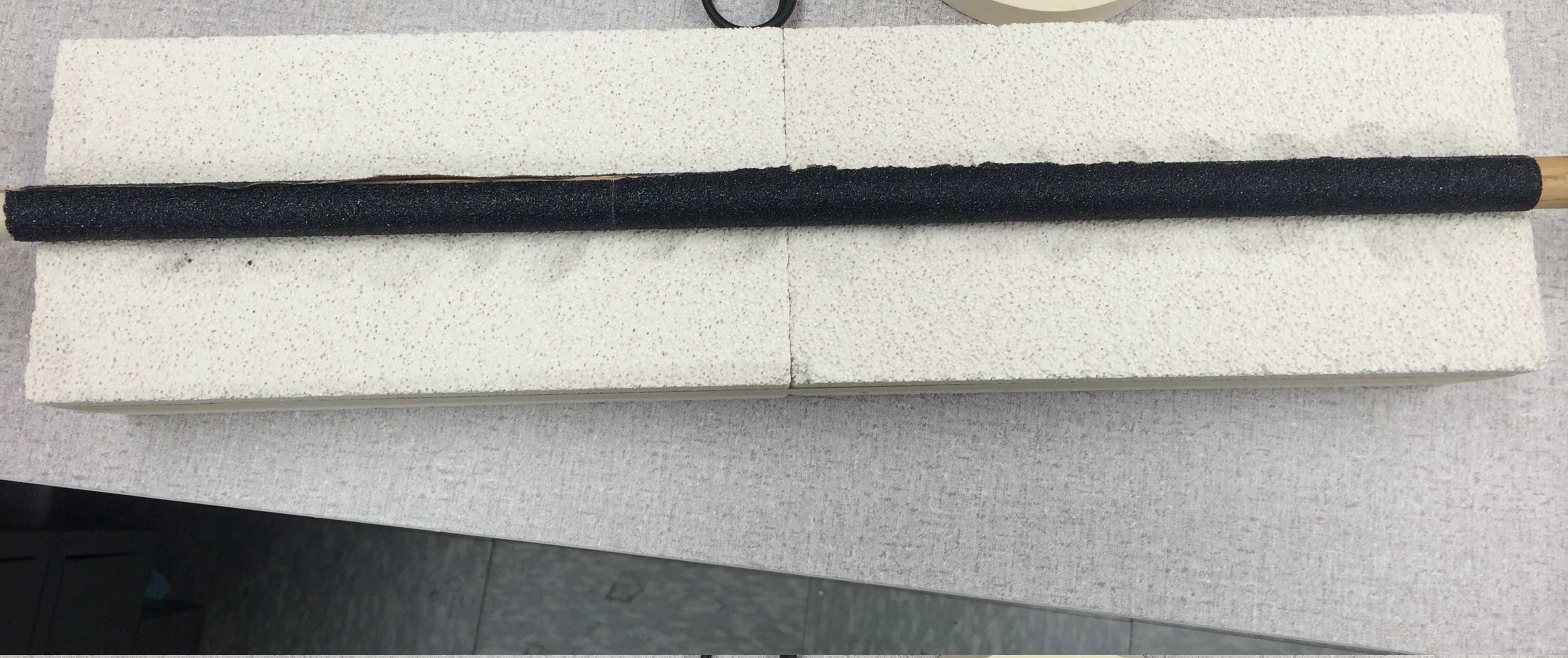

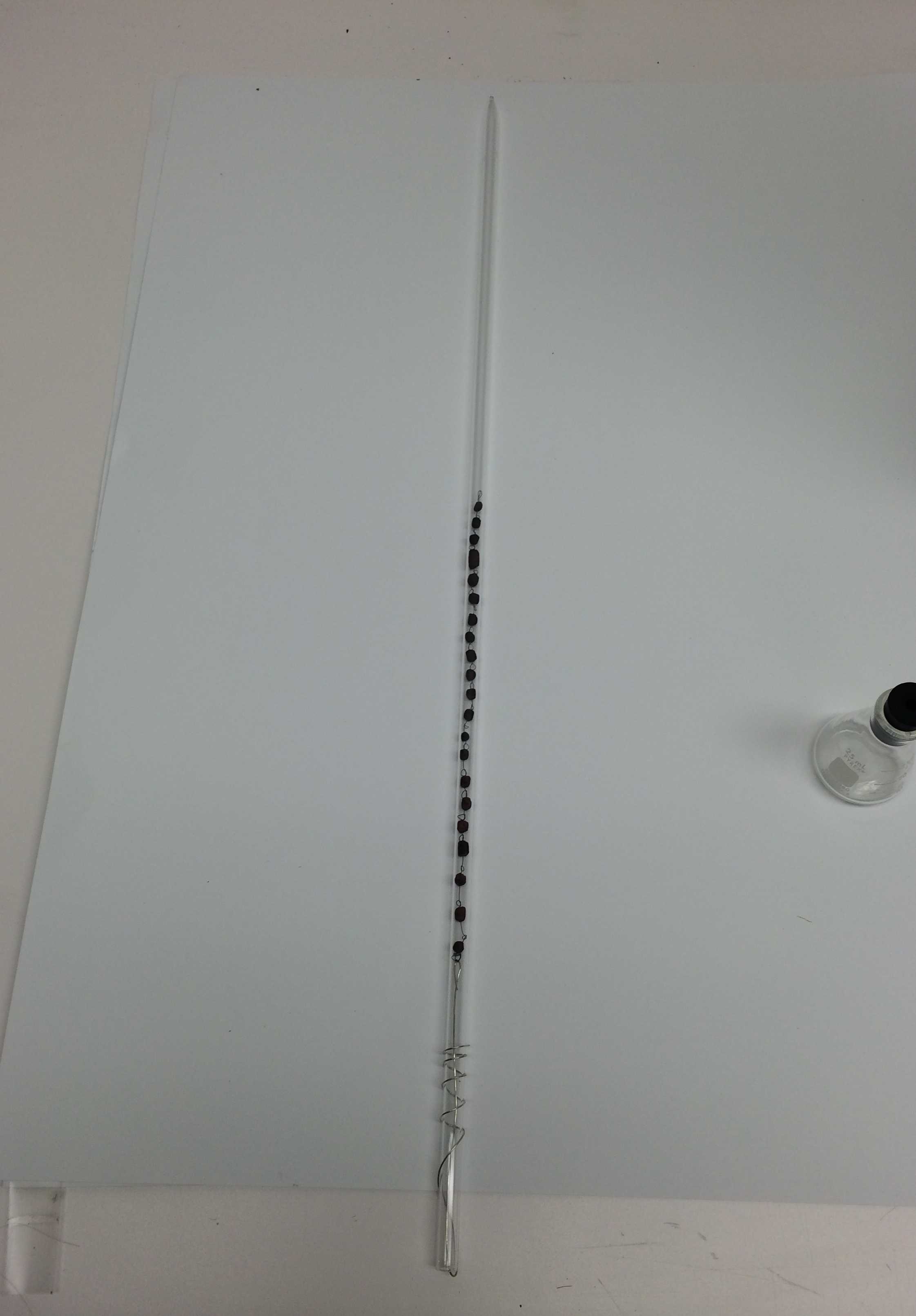

The following set up was not very effective in actual operation, but photos will be posted to document the process.
IMG_0346.JPG - 356kB IMG_0347.JPG - 344kB IMG_0348.JPG - 369kB
With a couple of hundred watts input to the reactor coil, temperatures in the tube averaged about 300C. This is about the temperature needed for alcohol dehydrogenation with this catalyst, while also allowing for long catalyst life. Higher temperatures work better, but the catalyst sinters, becoming ineffective as its surface area decreases. The finished "stack", as well as the reduced (and re-oxidized by room air) catalyst is shown.
IMG_0350.JPG - 278kB IMG_0353.JPG - 151kB

I understand the linked paper as following:
- First in solution are dissolved nitrates of Mg, Ca, Sr and Cu, then mixed in Silica gel, then stirred, filtered, dried and calcined.
- Then nitrate of barium is dissolved ontop of the all previous, and stirred, filtered and finally calcined all over.
-Then the catalyst is flushed with hydrogen for 2 hours at 300C to produce active catalyst.
How can calcium, strontium and other be calcined at 450C from their nitrates while their decomp temperatures are way over 600C? Both temps are somewhat easy to achieve with normal gas burner with insulated container, but that would bring some low-decomposing oxides, like copper, into such high temperature, could we be afraid of heating them "dead", as some mentioned CaO can be done?
Is the strontium necessary, or should it work with Ca+Cu+Mg+Ba only?
How should the catalyst be protected from air, or should it be prepared in situ for each dehydrogenation reaction? Once the cats are applied on the SiO2 substrate, it don't have to be done again anymore, but most likely all the metals will be coated by an oxide layer the second they meet the atmosphere.
Should one use pure copper only for formaldehyde dehydrogenation if the reactivity is too large for previous metals?
It has been demonstrated that pure copper tube heated to dull red was capable of dehydrogenating ethanol into acetaldehyde in Versuchschemie forum. They got from several hundred ml's of ethanol a 100ml of acetaldehyde. They never tested how long would the catalyst live.
