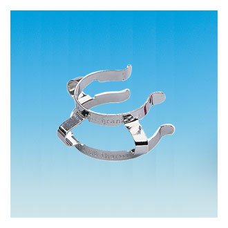

I've been so disappointed in the Delrin clips that I've been slowly changing over to those made of ptfe. They are more expensive but are a much stronger clip and are good for up to 200°C. VWR sells them (see photo below). They come in an Ace Glass package but I couldn't find them on Ace's website, which is somewhat cumbersome.
The Ace site did list a ss clip good for 500°C, however. I've been looking for those for a long time. See photo below.
Thanks for posting this. It may inspire me to install a fixed fire extinguisher system capable of shooting CO2 into my fume hood duct - something I've long thought of doing. I agree with you that a good fume hood draft is a great asset when you've got a smoky fire going.
ptfe clip.jpg - 5kB ss keck clip.jpg - 15kB

United glass tech carries metal Keck clips.
Look under glassware accessories.
[*] posted on 25-12-2014 at 10:23
Yes, and at a much better price than Ace. Thanks.

If you need to use them, use those solid steel ones. Otherwise, simple lube with a set little clamp solves the problem.

Try these: http://clipox.de
Stainless steel joint clamps. Better than Keck or any other plastic clamps :)
