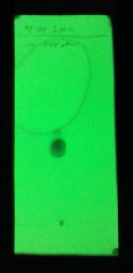

DDT synthesis by the procedure above
4.2 mL (4.662 g, 41.4 mmol) of chlorobenzene and 4.0 g (24.2 mmol) of chloral hydrate were mixed in a 100 mL 1N RBF and heated until chloral hydrate had dissolved. 36 mL of concentrated sulfuric acid was added slowly and the flask was closed with drying tube. Subsequently, a white turbidity appeared and this was set to be magnetically stirred over the weekend, however at some point the stir bar got stuck.
White solid spheres were formed over the weekend and the reaction mixture turned brown. TLC of the solid shows two spots (Developed in n-hexane, detection UV). Reaction mixture was poured into a 400 mL beaker half filled with ice-cold water. A fairly exothermic reaction was observed. After cooling, water was decanted of the solid and the solid was first washed with 50 mL of 5 % sodium bicarbonate solution then with 3x25 mL of water. This was vacuum filtered and left to dry on air. Still slightly wet solid was transfered into a clean 100 mL Erlenmeyer flask and dissolved in 25 mL of hot isopropanol (Used too little!). After cooling, a fine white crystalline solid formed which was then vacuum filtered and dried under vacuum. Yield 3.23 g (44.0 %) of white powder that has a slight apple odor, mp 100-103 °C.
Theoretical mass is 7.34 g (20.7 mmol) and the literature mp is 108.5 °C.
TLC of the final product shows traces of the second spot, presumably o,p isomer. 1H NMR shows the o,p isomer as impurity.
Is there a way to purify the product to get rid of the o,p isomer or any DDE/DDD in there?
I checked pubchem and a recrystalization might be possible?, maybe in like benzene or something
Practically insoluble in dilute acids, alkalies. ... Freely soluble in pyridine, dioxane; solubility in organic solvents increases with rise in temperatures.
Solubility, g/100 mL solvent: 58 acetone; 78 benzene; 42 benzyl benzoate; 45 carbon tetrachloride; 74 chlorobenzene; 116 cyclohexanone; 2 g/100 ml 95% alcohol; 28 ethyl ether; 10 gasoline; 3 isopropanol; 8-10 kerosene; 75 morpholine; 11 peanut oil; 10-16 pine oil; 61 tetralin; 50 tributyl phosphate.
But this still makes me uncertain if the impurities would recrystallize out with it (especially the o,p isomer)...
Of course i'd imagine doing a column would work but thats pricey and quite involved lol so idk
