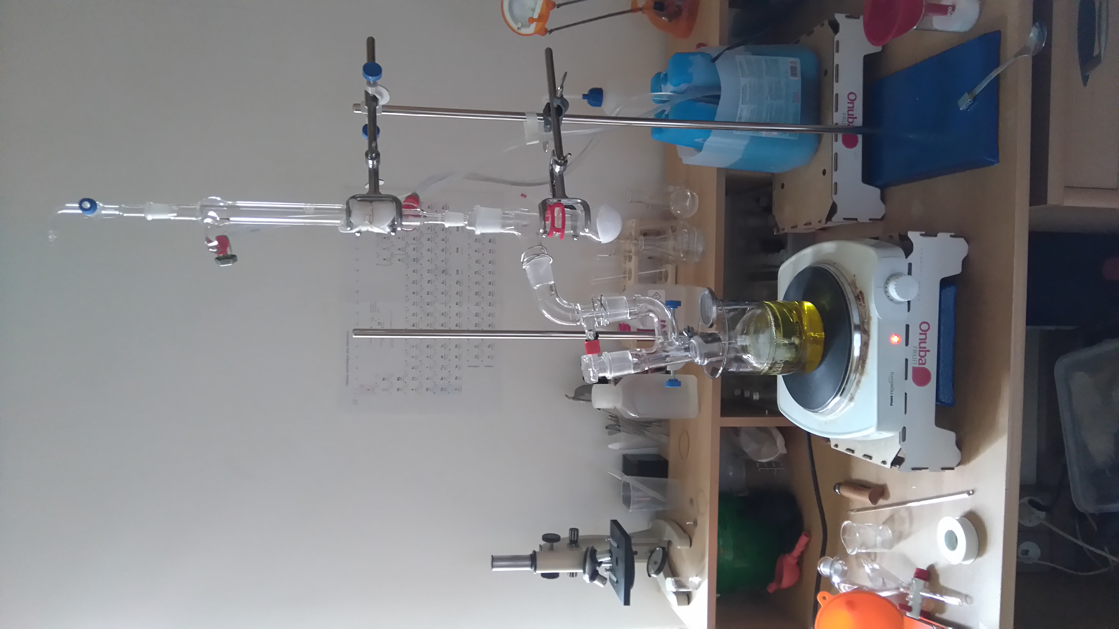

Fellow chemists, i present you the magnificent derp-stark :p
I tested it on a citric acid/IPA esterification: the system works pretty well (no leaks or whatever) but I didn't get the expected separation (salting out) in the trap. Maybe there was too much IPA for the amount of water generated.
I used about 20 g of citric acid (monohydrate) and an extreme overkill of 150 ml IPA, knowing at least 70 ml were required to fill the trap ( + 3 drop of conc. H2SO4) The trap was half filled with table salt.
Refluxed it for 4 hours.
I then tried to neutralize it with NaHCO3, but it fizzed way too much for the amount of catalyst used. Either caused by unreacted acid and/or free carboxyl group in the mono/di isopropyl citrate...
tmp_23903-DSC_0134622243575.JPG - 2.3MB
UC235
Posts: 565
Registered: 28-12-2014
[*] posted on 2-6-2016 at 19:18
NaCl will only salt water out of IPA up to about 90%. After that point, the salt just sits there and stronger dessicants are needed.
