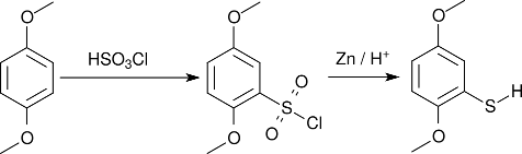

The 2,5-dimethoxy-4-alkylthio substitution pattern of phenethylamines has two representants in Shulgin's magical half-dozen [1], making it a highly fascinating synthetic target. Shulgin himself used various ways to achieve this substitution pattern.
  1. Aiming for 2C-T (the 4-methylthio compound), Shulgin went via sodium hydroquinonethiosulfate, the product of the addition of thiosulfate to benzoquinone [2]. The thiosulfate was reduced with Zn/H<sup>+</sup> to mercaptohydroquinone (scheme 1). Mercaptohydroquinone was then permethylated with dimethylsulfate. Besides the general nuisance of dissolving metal reductions, this scheme features one significant drawback making it unsuitable for amateur settings, namely copious evolution of H<sub>2</sub>S. Indeed, Klute reported a serious poisoning by going this route [3]. As an alternative Klute suggested acidic hydrolysis of the thiosulfate [4], but to my knowledge no success has been reported up to now.

In summary, the procedures performed by Shulgin are not very amateur friendly. Luckily, then came around Ullmann and reported a Duff formylation using sulfuric instead of trifluoroacetic acid [7]. The thread was lauded for this OTC breakthrough, but it also contained fascinating sulfur chemistry. Two points raised in this thread are of special interest:

Draco_440, deactivated 1,4-benzoquinones give only 3-substituted products:
http://www.sciencedirect.com/science/article/pii/S0040402001...
http://www.sciencedirect.com/science/article/pii/S0968089603...

[*] posted on 1-7-2015 at 14:43
I see in your successful run in reacting benzoquinone with thiourea you added additional aq. HCl and heated for a further amount of time.
When I did this as described by Shulgin under 4T-MMDA-2, it was heated at 93-96°C. The benzothioxolone was obtained in excellent yields of 94% as large off-white needles. Subsequent runs were similar. IIRC the yield was better than Shulgin's reported yield.
The only difference in the quantities used was the benzoquinone needed a bit more AcOH solvent to dissolve due to somewhat low ambient temperatures.
Methylation of the hydroquinone though was done in DMF with MeI (18hrs @75°C) and only got yields in the ballpark of 60% of the dimethyl-ether for various alkyl groups on the sulphur atom.

Turd, thanks for the excellent report. I don't have much to say about your work other than it was a pleasure to read about it.
I'm attaching the review article Angew. Chem. Int. Ed. 1967, 6, 544–553, DOI: 10.1002/anie.196705441 (Klute cited it in his thread and I think it is worth making it more available). I also think the reductive cleavage of Bunte salts is not yet as well researched as it could be. There are chances that it could be performed under basic media with inexpensive and available sulfur-based reducing reagents (Na2S2O4, thiourea dioxide, Na2S, etc.). Transthiolation with sacrificial mercaptanes (e.g., thioglicolic acid) could also be another possibility. Direct nucleophilic substitution with NaBH4 in a proper solvent could also do the job. In principle, there is potential for amateurs developing new methods for this reaction.
On a Bunte salts related context it might be worth mentioning that 2,5-dimethoxy-1-propylthiobenzene could potentially be made by coupling a propyl Bunte salt with 2,5-dimethoxyphenylmagnesium halide (DOI: 10.1021/ol500067f). Though in my opinion, directed ortho-lithiation of 1,4-dimethoxybenzene followed by the reaction with elemental sulfur might be a much more practical route to 2,5-dimethoxyphenyl alkyl thioethers, particularly if it turns out that the so formed lithium thiophenolate could be S-alkylated in a one-pot fashion, thus avoiding the isolation of the thiophenol intermediate.
Attachment: The chemistry of Bunte salts.pdf (365kB)
