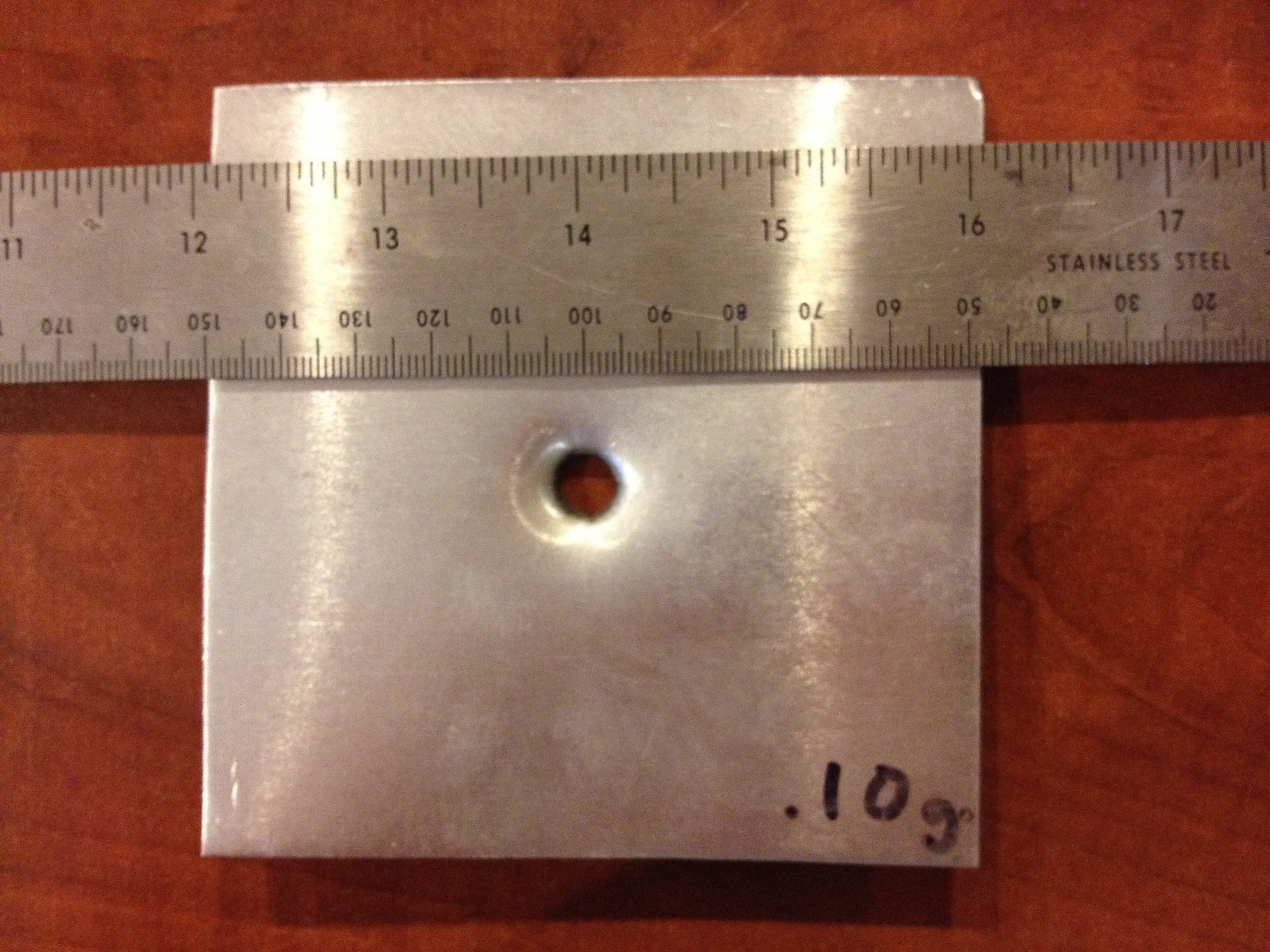

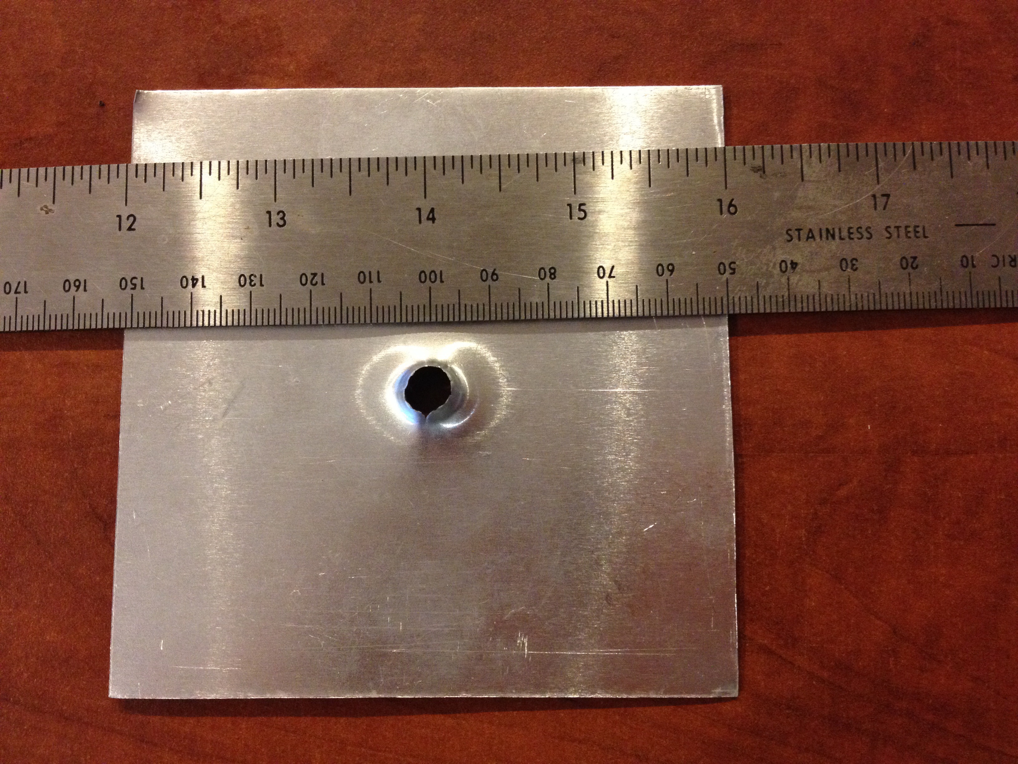

I wanted to demonstrate that sunlight can be used to ignite things very easily when it is concentrated with a magnifying glass. In order to make it look spectacular I took appr. 500 mg of KClO3 and half of that of red P. Outside, I put the KClO3 on a concrete tile in a small pile. Next, I put the red P on it. I took a dry little twig from a tree (10 cm length or so) and intended to use that for coarsely mixing the two powders. I stick the little twig in the mix and nearly instantly I have a bright flash and have many tiny droplets of molten stuff sprayed around, also on my hand. This was painful!!! The magnifying glass was not needed in this "demo" ;)
