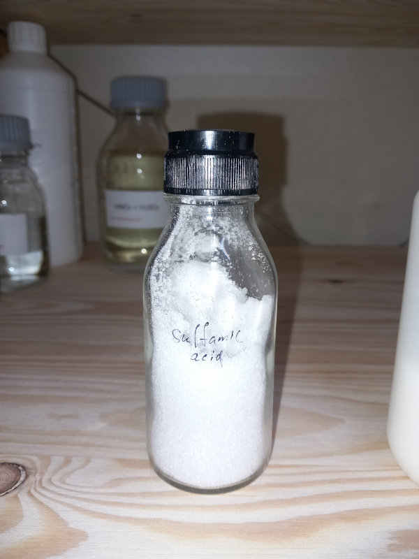

So, that's all for now. And I express my thanks to woelen for his old present - the bottle of the sulfamic acid I used for this experiment.
Bottle.jpg - 131kB
