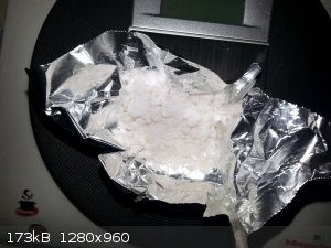

So I measured 6.5g of paracetamol tablets and ground them into a fine powder. Then I dissolved them into aprox. 100ml of 95% ethanol and filtered the undisolved particles. Finally I evaporated the ethanol down to 30ml aprox. After about an hour or so the acetaminophen began to crystallize. I put the solution on the fridge at -7 °C and let it repose for about 30 minutes.
20160126_204201.jpg - 121kB
20160127_173852.jpg - 212kB
My yield was 5.8g of acetaminophen (89%)

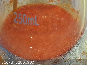

I let the solution react for 2 hours and it went from a yellowish colour all into a deep red one.
20160128_193945.jpg - 138kB
20160128_201719.jpg - 136kB

To be honest I haven't had time to continue this procedure. after allowing the mixture to repose for a day or so a black precipitate was noticed... I'm not sure what it is, under the light it seems to be some kind of crystalline substance but it surely looks absolutely evil haha... any ideas on what could this be?
20160131_205058.jpg - 133kB
Looking on the internet I think it could be some kind of hydrolysis product. Sigma Aldrich says that 4-amino-3-nitrophenol has a deep violet color... I will do some tests when I have time to determine what this may be.
Also, yes. I was working with a suspension... later in the reaction most of the aminophenol did dissolve but just a little bit remained in suspension, like a gram or so.
