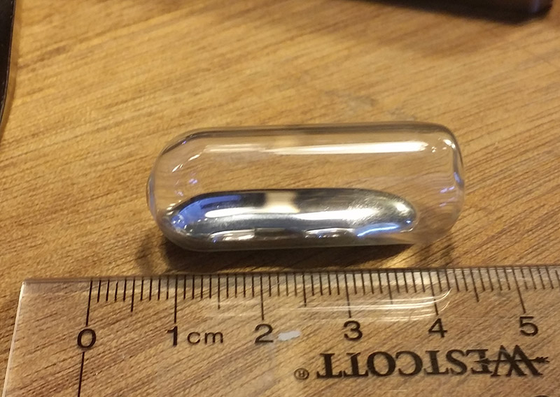

To give an idea of what I'm trying to accomplish, here is an "ampoule" of the sort I'm trying to make. It's just glass tubing sealed off on both sides with the sample inside, in this case mercury.

How did you seal it and how do you plan to recover the Hg without having glass bits in it? Most ampules are twisted into a point at the top end, which can easily be snapped off. The design you have shown would be better for an something that is not intended to be removed, like for an element collection.

Making an ampoule that is nearly full is harder because the heating is closer to your sample. I suspect that the one shown was done with solid mercury.

The mercury ampoule is not my creation, it's what I'm trying to replicate and reverse engineer. And, yes, it is actually for an element collection so a one way trip :-)

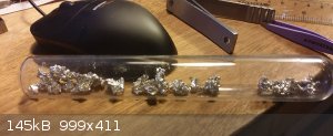

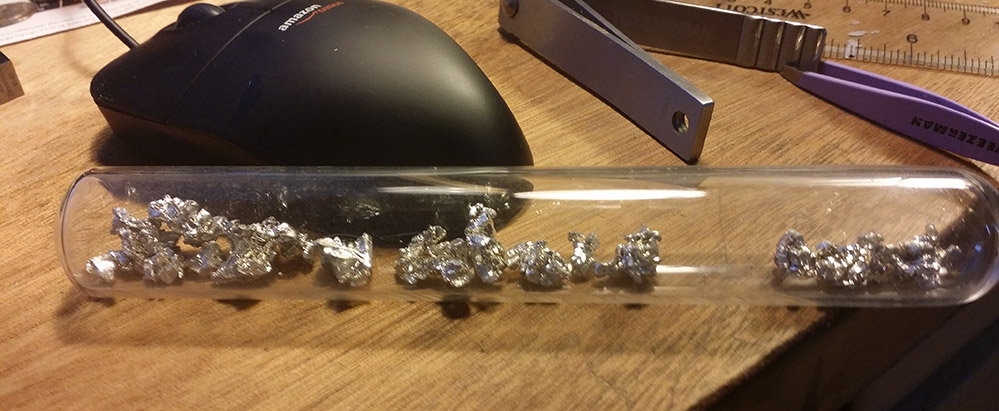

In the case of mercury no need for argon since it's air stable. I want to do this for other elements that aren't. Like this calcium below; to transfer it from a huge ampoule into little ones each holding what looks and feels like metal popcorn.
