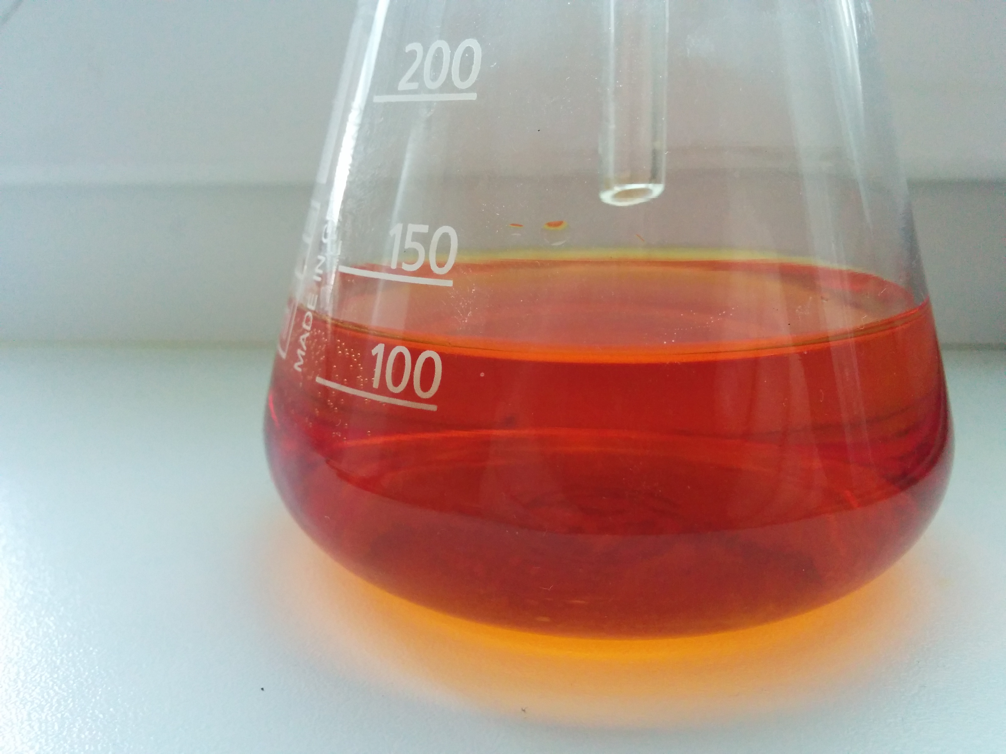

I've tried to add more H2O2, but nothing happens (maybe it's a bit darker now, but even adding alot of it doesn't make the difference).
I'll add the picture...
IMG_20160227_095557.jpg - 1.4MB
PS: What if I'd try to boil off the water?
[Edited on 27-2-2016 by xfusion44]

[*] posted on 27-2-2016 at 02:14
If I add more HCl it becomes brighter orange...

[*] posted on 27-2-2016 at 02:19
What is pH of the final solution? How does it react to addition of bleach+acid?
I don't think filtering of iodine through the paper is a good idea as far as iodine forms complex with cellulose.
Dichloromethane or similar solvent can be used to extract the iodine.
