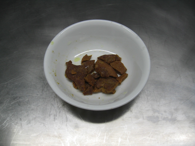

The solidified oil was removed in large chunks and placed in a mortar for grinding:
solidified α-nitronaphthalene from oil

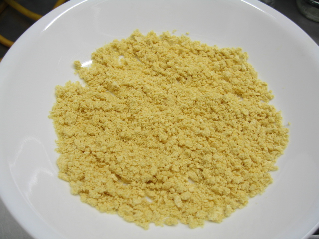

The mp of this crude product was was unacceptably low so I recrystallized it in 275ml of 90% ethanol. The recrystallized product is shown below where
you can see that the color is much improved. Ideally it would be a light yellow.
α-nitronaphthalene recrystalized

After the first solidification the yield was 24.9g, or 92.1%. However the mp of 45°C, and the color, indicated that it was significantly
contaminated. Therefore a recrystallization was performed. This yielded a product with a much improved mp of 51°-53°C. However, the yield then
dropped to 11.8g, or 43.7%.
The mp for α-nitronaphthalene indicated in internet sources varies considerably from 53°-57°C (Sigma-Aldrich) to 61°-63°C (Jean-Claude Bradley).

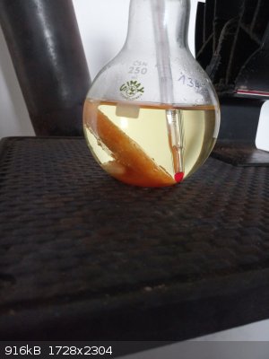

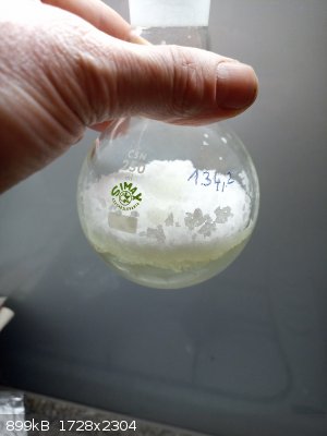

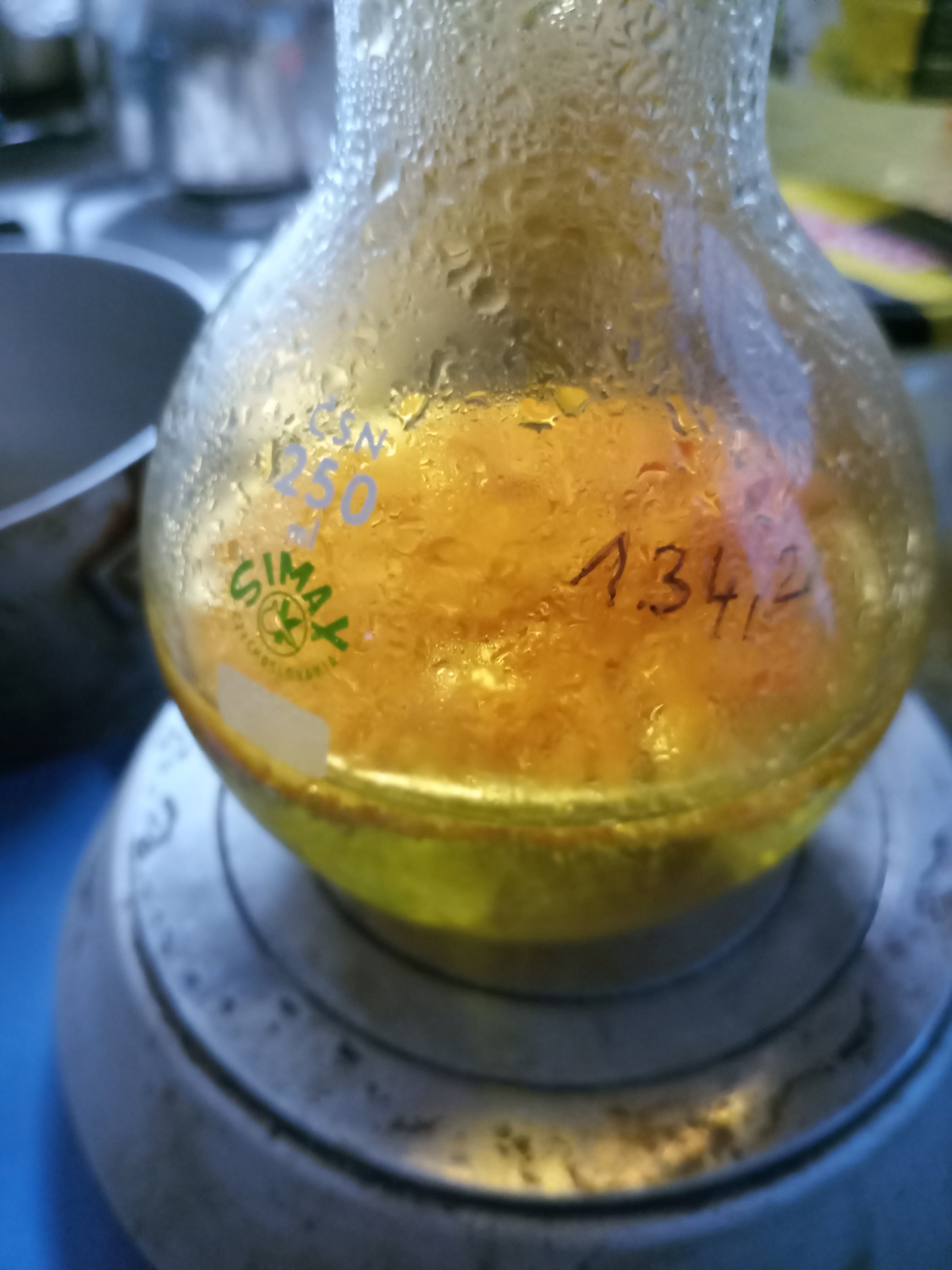

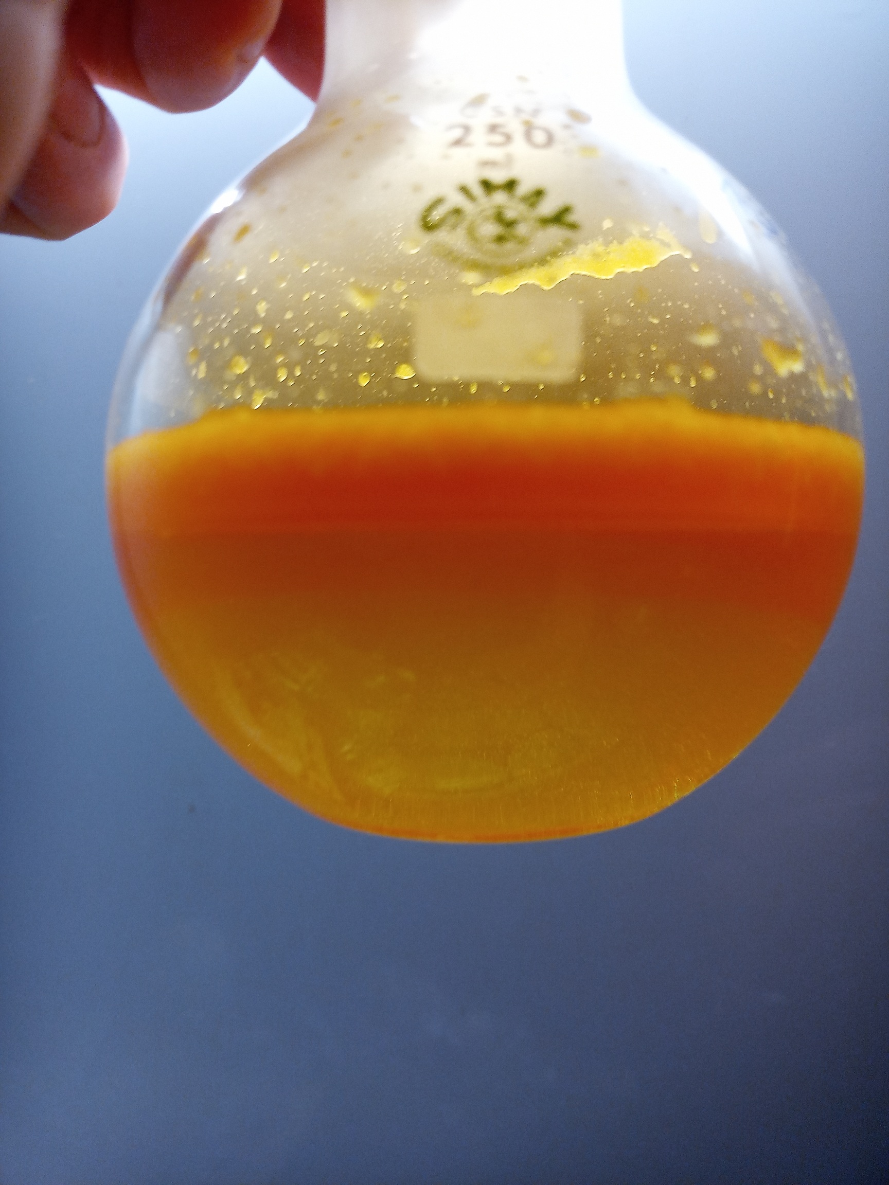

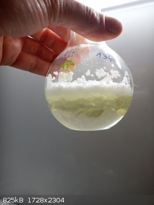

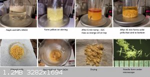

I did this same prep a couple of weeks ago(based on the same paper), on a 2x scale. The crude product looked essentially like dirt, so I
recrystallized a small portion from ethanol first to see how well that worked. What followed was several hours screwing around, trying various ways
of recrystallizing it to prevent it from oiling out(originally I thought that a bit of the product which was oiling out was tar), and trying to
maximize recovery. I ended up with four different products, all different colors and MPs, totaling around 35% yield, and another 10-15g of dark solid
product which oiled out and needs to be recrystallized again. I believe that methanol is a slightly better solvent than ethanol due to it's lower
boiling point, but Purification of Laboratory Chemicals 6<sup>th</sup> Edition recommends heptane or ethanol. The procedure on PrepChem is interesting, as it recommends xylene or high boiling ligroin. Seems like I've got another several hours of trying
various solvents to see.
Let me know how the Piria reaction goes. I've tried it once already with some of the crude product to get a feel for it. After two hours of
refluxing, the nitro compound had fully dissolved, so I cooled and acidified it, but nothing came out of solution. There was a substantial color
change though, to a darker red color. I've been meaning to try it again, but haven't had time as of yet, I was planning on doing it next week
sometime if I have time.

PHILOU Zrealone
Posts: 2894
Registered: 20-5-2002
Location: Brussel
A long time ago, (about 23 years ago), I did perform nitration of mothbal naphtalene with HNO3 69% only.
Thus without H2SO4.
I did put the ball into a test tube, and I added about 4 times the volume of HNO3 69%.
The mothbal was floating on top (test tube was thus about half full)
Then I allowed a common 75W lightbulb (yes one of those old tungsten wire ones) to heat it up from above by holding the tube close to the lamp (with a
woden clamp).
When molten the naphtalene was a clear transparent liquid (so T° was above 80°C (the mp of Naphtalene) but below the boiling point of 69% HNO3).
I did put a cap on top when hot to avoid too much smell of the sublimating naphtalene.
While heating the HNO3 was turning the clear phase above it yellow...then after a good while (1 hour), it turned deeper yellow.
I let the all test tube cool down and repeated the heating of the same test tube from time to time one day on two days, then cooled again.
After about 3 treatments (one week --> about 3 hours), the solid was nearly orange and had a very distinctive smell totaly different from initial
naphtalene...from which smell had disapeared (or was covered/masked).
This orange waxy solid was heavier than the initial naphtalene...almost sinking into the used HNO3.
It was very different solid...with a different kind of crystalinity so to speak.
It was washed with boiling water and hot bicarbonate water and dried then used with KClO3/NaClO3 for Cheddite experiments.
What is interesting here is that just like for my toluen experiment (yielding nitrotoluen and nitrobenzoic acid), no H2SO4 nor concentrated HNO3 was
used ...only 69% azeotropic HNO3!
Nothing else could have been formed since only mononitration can occur in such media and naphtalene is like benzene quite resistant to oxydation (less
than C6H6 of course but more than C6H5-CH3).
Sadly I didn't perform at that time a sublimation test to be sure there was no more naphtalene present inthere nor did I made a melting point testing.
If I have time and no ex-girlfriend at home (sadly can take monthes), I want to redo that fast experiment and confirm those old datas with more
detailled results.

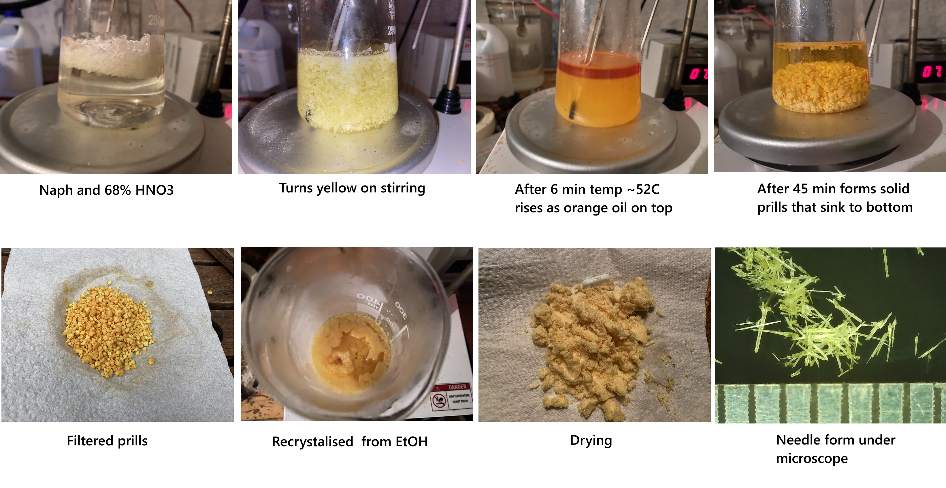

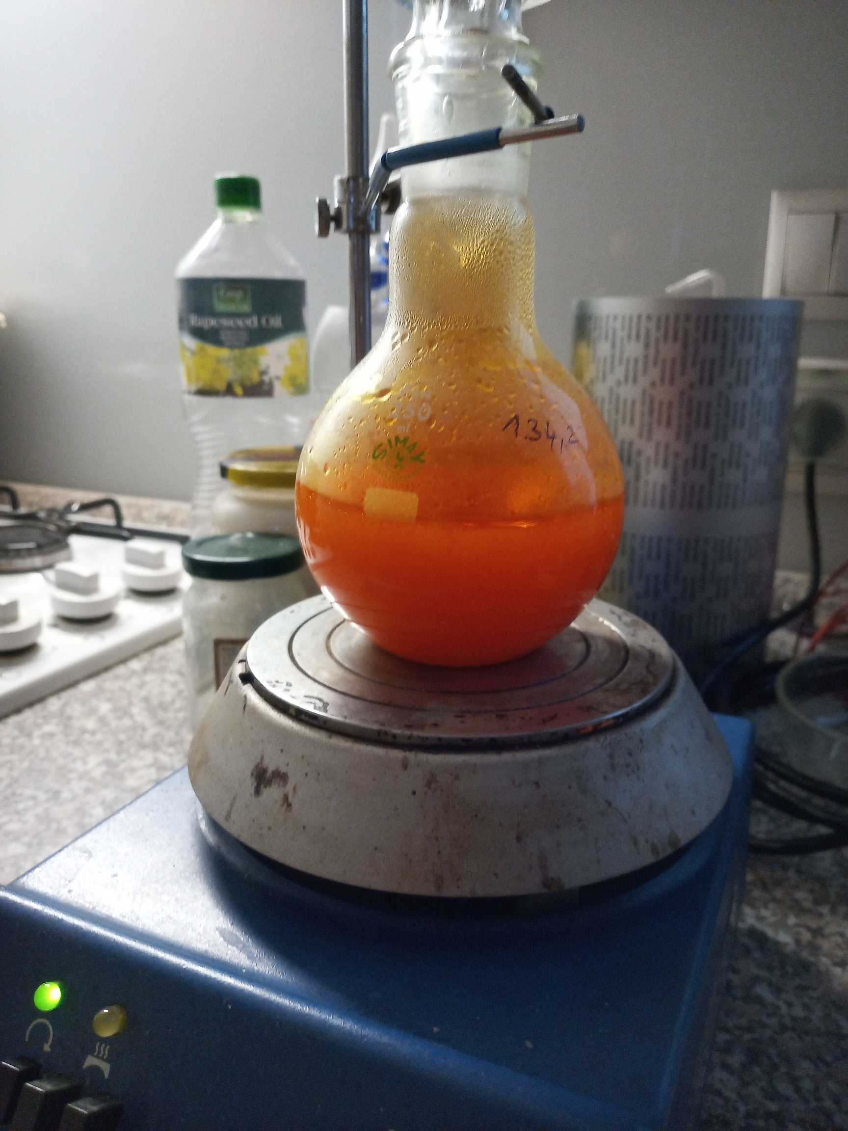

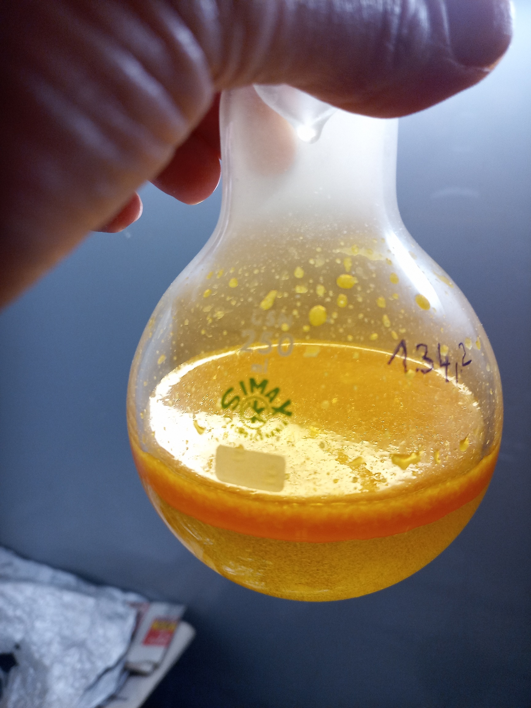

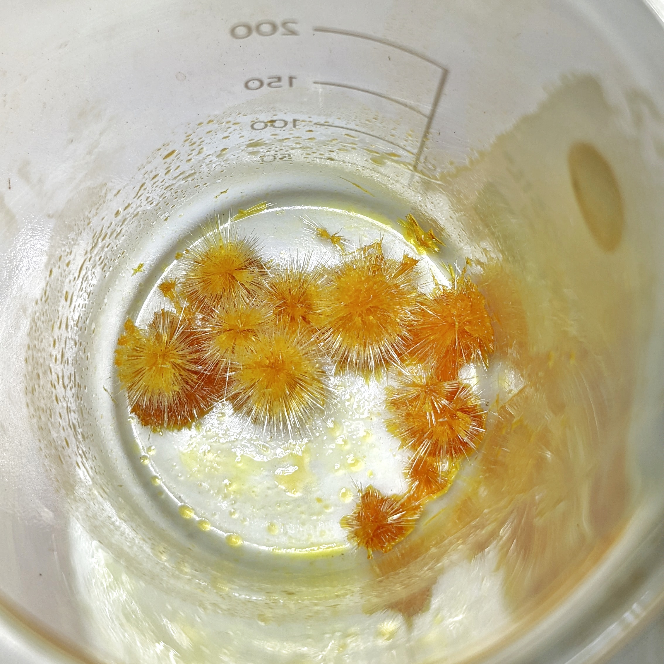

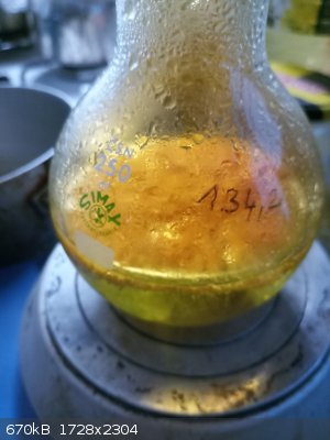

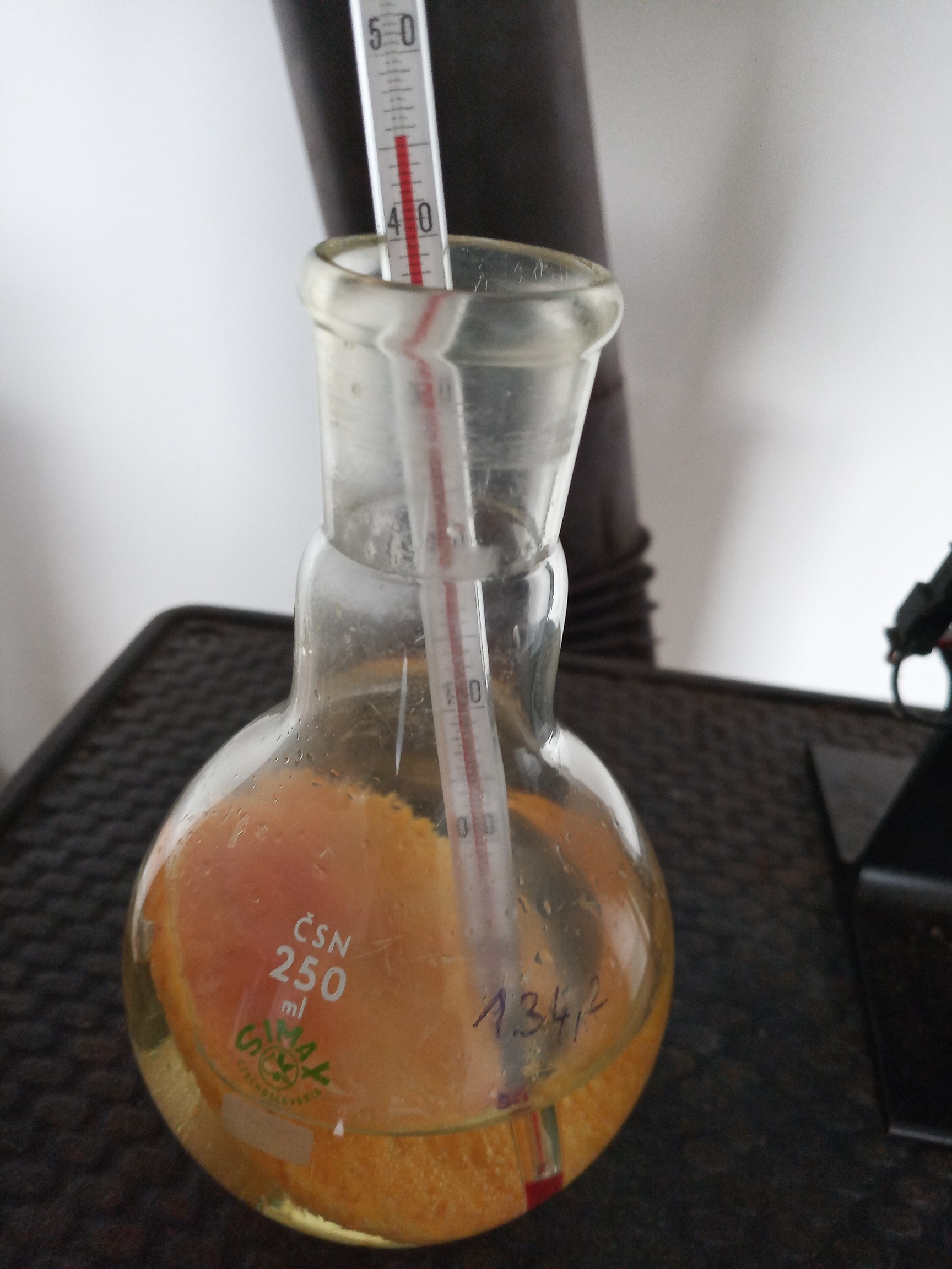

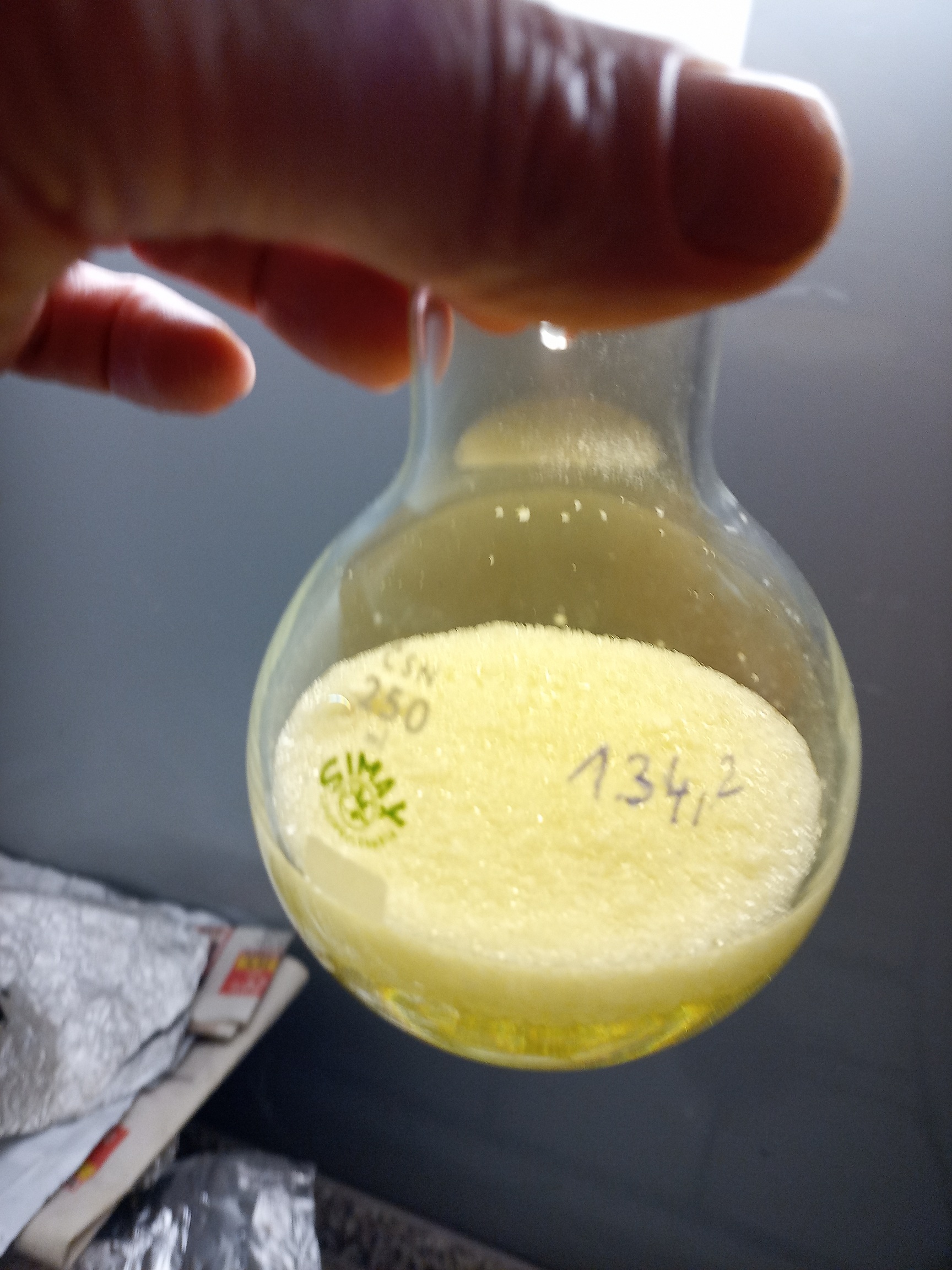

The napthalene mothballs have finally arrived !
Let's see if i can replicate Magpie's experiment.

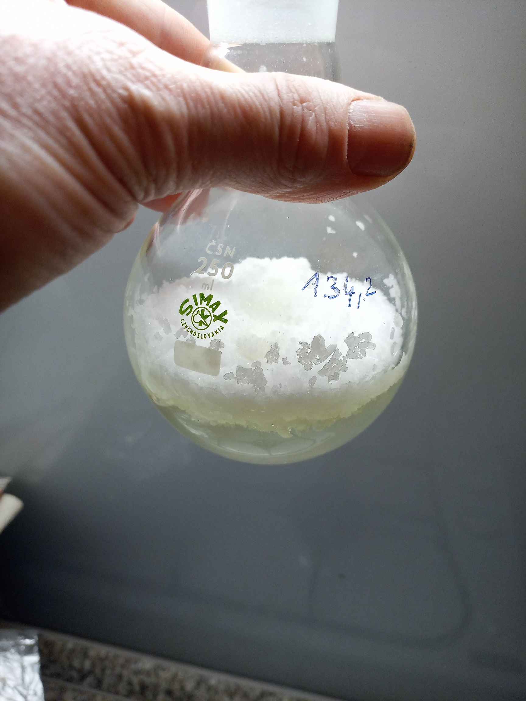

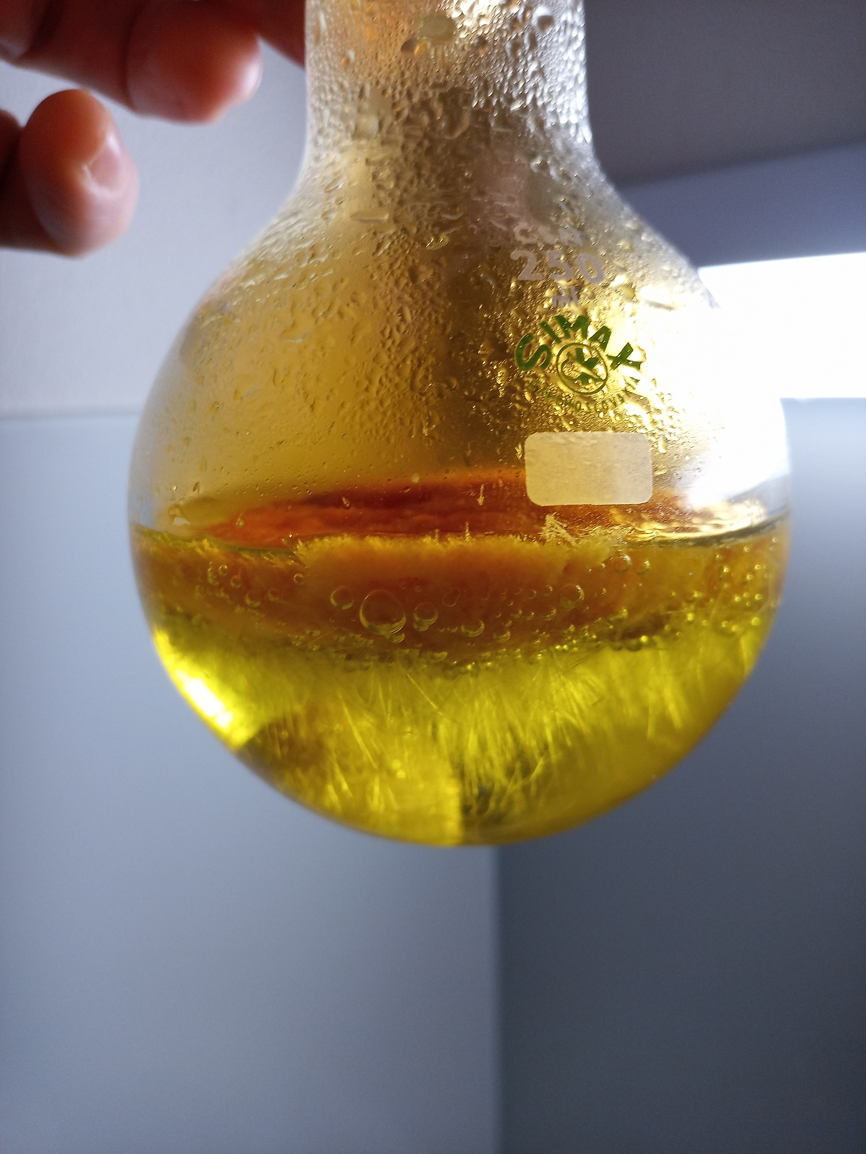

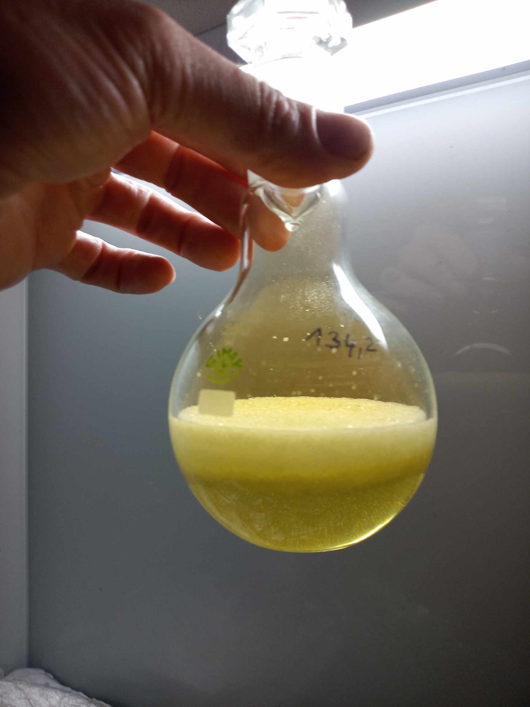

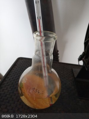

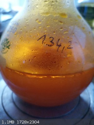

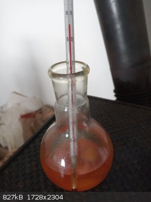

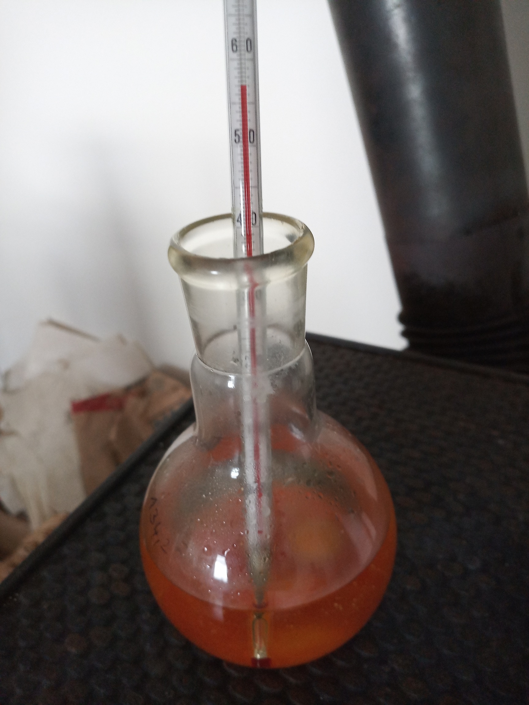

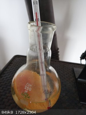

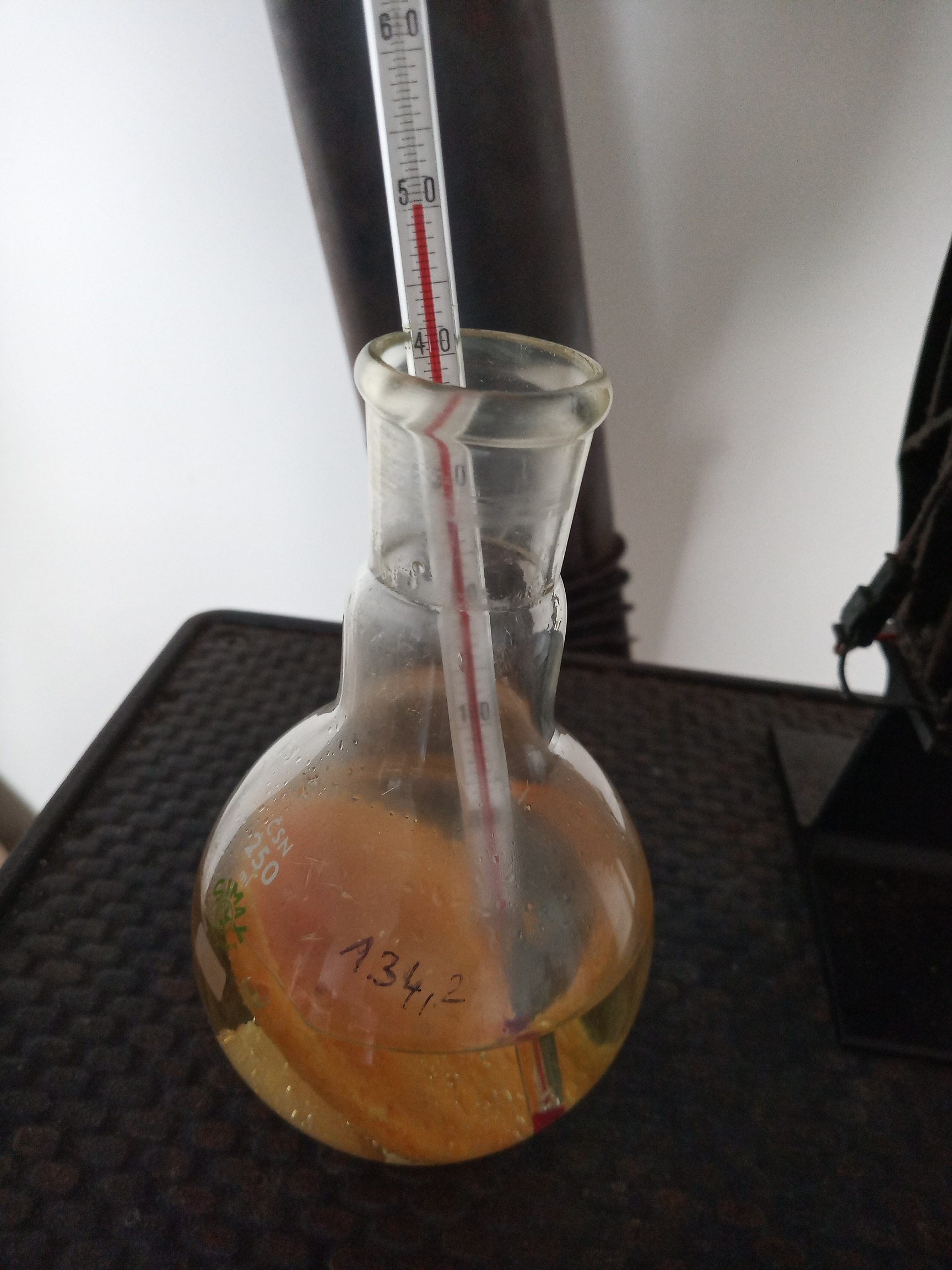

Posts: 1057

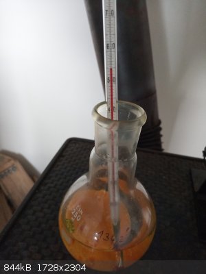

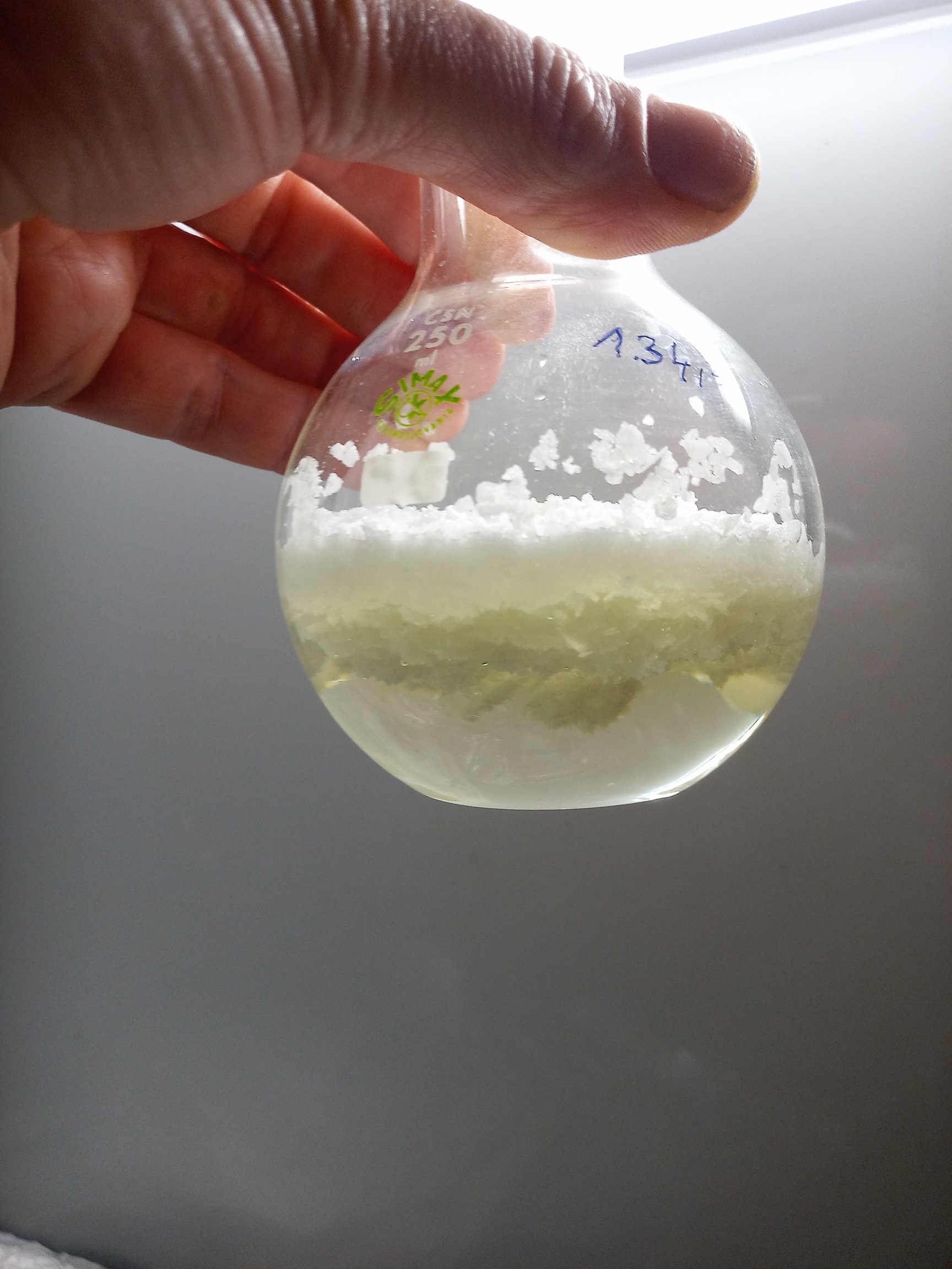

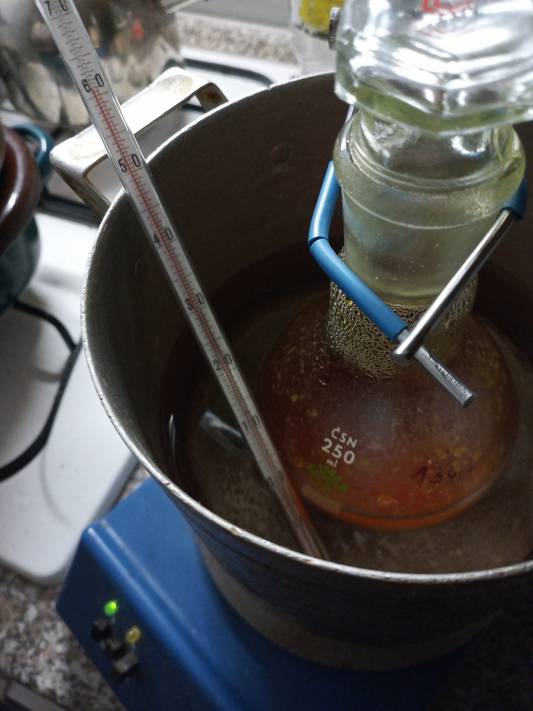

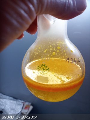

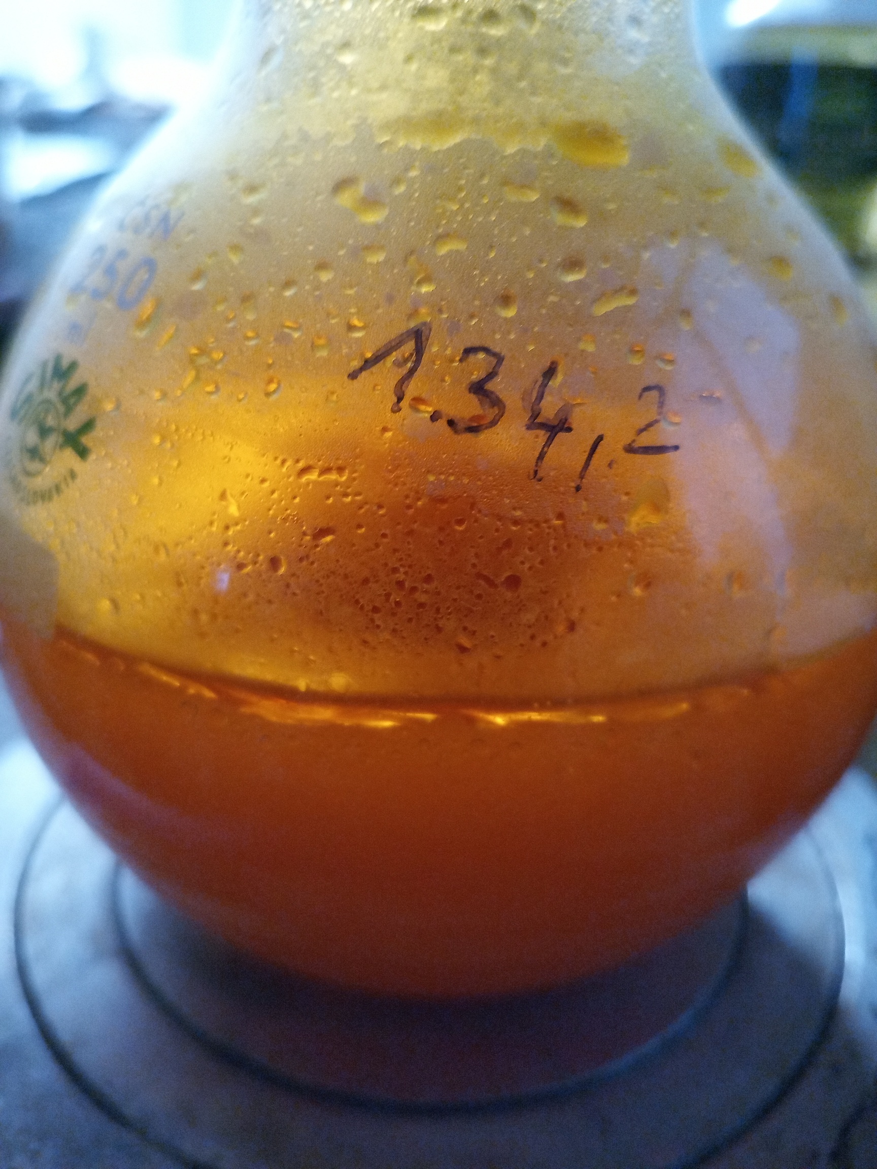

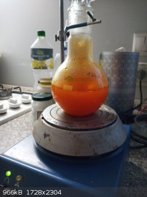

Recently I performed this nitration and tried to minimize acetic acid use (I used only 1/3 of the amount) and also maximize nitric acid use (I did not
use HNO3 excess like 0,20 mol HNO3 for 0,15 mol of naphthalene as the excess could lead into dinitration although low temperature may effectively
prevent it)
H2SO4 is present to utilize all the precious HNO3. If using only HNO3 without H2SO4 substantial amount of HNO3 will stay unreacted.
I will report more after the workup is done (only the nitration part is already done).
Meanwhile I would like to share my theoretical thoughts and some calculations.
I performed the synthesis at 1 mol scale.
1,00 mol naphthalene (128.2 g) + 1,00 mol HNO3 (97,0 g 65% = 70 ml) + 150 ml 96% H2SO4.
I used only 150 ml of glacial acetic acid as a solvent (instead of suggested 60 ml for 20 g of naphthalene) in which even after dilution with water
(from nitration mixture and reaction water) enough naphthalene is certainly dissolved at every moment to be reacted with nitration mixture from
dropping funnel. There is only 18 g of reaction water = 1 mol and 34 g = 2 mols of H2O from 65% HNO3 which is bound by 275 g H2SO4 = 2,8 mol.
Separation of possible unreacted naphthalene seems to be trivial by steam distillation. Separation of dinitro from 1-nitro by crystallization may be
more challenging (oiling out).
Here calculations of steam distillation.
Info obtained from here:
https://sci-hub.ee/10.1021/acs.est.6b06364
For sake of simplicity assume only binaries during steam distillation: water + naphthalene, water + 1-nitronaphthalene (in reality it will be ternary
H2O + naphthalene + 1-nitronaphthalene)
log10 P = A - (B/(C+T))
P is the saturated vapor pressure in kilopascals (kPa) and T is the temperature in kelvins.
1-Nitronaphthalene
Antoine III (liq) A = 7.8959, B = 3468.4, C = 0, dev = above 5.0, range = 332 to 580
Naphthalene
Antoine IV (liq) A = 6.19487, B = 1782.509, C = -65.637, dev = 0.1, range = 352 to 500
using the Antoine equation and constants the vapor pressure of naphthalene at 373 K is P = 2.486 kPa so the water vapor pressure is 98.8 kPa (so the
water will distill at a temperature little lower that 373 K but that could be neglected)
so the distillate contains 2.5*128.2 = 320.5 g naphthalene with 98.8*18 = 1778.4 g of water
1-nitronaphthalene vapor partial pressure 0.03956 kPa at 373 K and H2O partial pressure 101.3 kPa
so the distillate contains 0.03956*173.2 = 6.852 g of 1-nitronaphthalene with 101.3*18 = 1823.4 g of water
if I assume that the nitration did not proceed quantitatively and there is 32 g of unreacted naphthalene (25% of the reactant due to side reactions
wasting the HNO3 or according the fact that I did not use HNO3 in excess) that would require 178 g of water for distilling it out and in such amount
of steam 6.85 * 178 / 1823 = 0,67 g of 1-nitronaphthalene is distilled out
during steam distillation loses of 1-nitronaphthalene are acceptable low and such a naphthalene with a little of 1-nitronaphthalene
could be used in repeated 1-nitronaphthalene synthesis, by my opinion having unreacted naphthalene in the crude nitration product is much easier
situation to deal with than having there dinitronaphthalene
so a steam distillation will be certainly a part of my workup procedure to remove unreacted naphthalene as I used reactants in 1,00:1,00 molar ratio
instead of the ratio 0,15 mol naphthalene (20 g) : 0,20 mol HNO3 (14 ml 65% HNO3)
even distilling 100 ml more water after all naphthalene is distilled out would lose only less than 0,5 g of the product (that would ensure that
unreacted naphthalene is separated out even more thoroughly)
also the point when naphthalene stops to distill out with steam should be well visible as the amount of aromatic compound in the condenser should drop
approximately 50 times
I'm also missing a washing step with something like 1-2 % NaOH or at least Na2CO3 or at least NaHCO3 to remove acids, but maybe repeated washing with
hot water is sufficient. I will perform such a washing step in my workup certainly. There could be also some phenolic compounds (1-naphthol,
2-naphthol, naphthoquinones etc, look at the dark color of the crude nitrated product) as a side reaction products of oxidation so alkaline washing
(NaOH or Na2CO3) should remove them in a form of water soluble naphtholates.

Thanks to magpie and his notes , I was successfull in attempting the synthesis of 1-nitronaphthalene and got exactly the same yield as he did. This
video is also a tribute to his efforts
https://youtu.be/oRN9ExHEdcY
