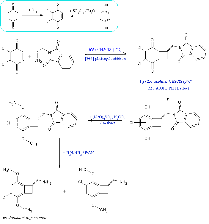

[*] posted on 21-10-2006 at 13:55
Hi :)
Thanks for the input... Sorry but I don't have p-benzoquinone-specific references, I posted what came to mind while looking at the formulas :o. However, 3-methyl-2-cyclohexenone reacts smoothly with ethylene[1] as does plain cyclohexenone (90% yield), undesired Paterno-Büchi heterocycle is formed only in 3% yield[2]. Another procedure[3] uses electron-rich olefin (note also interesting fragmentation). I did consider acroylnitrile, but wouldn't the use of isolated alkene minimize side-reactions (dimerizations), since in that case only enone can be light-excited? I see no frontier orbital obstacle to have isolated olefin as one of the components.

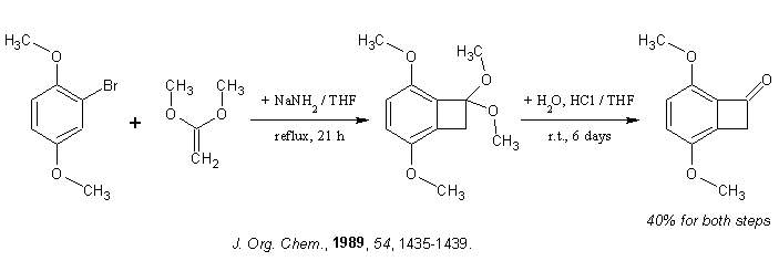

Anyhow, another option is to go via aryne corresponding to 2-bromo-p-dimethoxybenzene. Once generated, this species
a.) may be able to undergo a [2+2] with, N,N-dibenzylallylamine* or N-allylphtalimide** to give protected amine directly
b.) may for sure undergo a [2+2] with 1,1-dimethoxyethylene, ultimately giving cyclobutanone[4]. Treatment with TosMic yields nitrile. But b.) involves much more work...
*: If BuLi is used since it will cleave the phthalimide
**: If LDA is used since it dosen't attack phthalimide
Nichols et al. use 3 different starting materials in Scheme 1, 2, 3, more efficiently one could go from indanones to make both five-membered (IMO, TosMic is preferable for nitrile introduction) and four-membered carbocycles. The ring contraction to the latter can be done in two ways, in order of conveniance:
(1) Lead(IV) acetate method. 1,2-dihydro-cyclobutabenzene-1-carboxylic acid has thus been made directly from 1-indanone in 75 % yield.[5]
(2) α-oximation of the indanone, α-diazo ketone and photo-Wolff rearrangement of it to carboxylic acid.[6]
Resulting carboxylic acids can in turn can be amidated and reduced with NaBH4/I2.

[*] posted on 21-10-2006 at 15:58
Another question that comes up to mind concerns the stability of cyclobutabenzene derivatives (I have no practical experience with this type of substances). They are also used as precursors for o-quinodimethanes, and as such are a valuable type of compounds for pericyclic reactions. To do so, the cyclobutabenzene is subjected to an electrocyclic ring opening. Some substances require heating, others nothing more then room temperature. The main problem here is the stability of the o-quinodimethane: it is highly reactive. If there are no reaction partners, there will simply be an equilibrium between the cyclobutabenzene and the o-quinodimethane, but if there are, I suspect it will become a mess. The o-quinodimethane will happily react Diels-Alder style. Among others, I see a benzoquinone offering itself for reaction.
I haven't read the complete article yet, but perhaps you can also ask yourself whether the substance analyzed after synthesis, the compound put on the receptors, and the dust that one day will inevitably will be subjected to gastric inspection by the hippies are the same compound.
Perhaps you should just try, and if it doesn't work out as you hoped, just come back and read what might have gone wrong ;)
I was wrong about benzoquinone being a possible reaction partner, since I assume you do the aromatization in at least a second step. Nevertheless, the o-quinodimethane intermediate remains a theoretical possibility.

[*] posted on 22-10-2006 at 00:42
I come to like this idea of photocycloaddition (BTW, great idea, Sendmayer!). However I don't have Beilstein/SciFinder access during the weekend. The only references regarding [2+2] photoadditions on p-benzoquinone I was able to find using keywords are all at the RSC publisher that is currently offline due to maintenance.
The HOMO/LUMO energy difference is satisfactory even though the N-allyl-phthalimide is not electron rich, but the Paterno-Büchi side reaction is still possible (I think saw preparative examples on p-benzoquinone as well, but more on this when I will be able to get the papers).
As Sergei noted there might be a problem with the stability of the resulting cyclobutabenzene. Would they survive methylation and deprotection with hydrazine? From Nichols we know they survive BH3 and Br2, so they are not that very sensitive, but here we would have a phenolic form first.
Synthesizing an analogous 5-HT2A agonist from p-naphtaquoinone would allow for skipping the bromination and the synthesis would require only 3 steps (with the possibility that the photoaddition works better on naphtoquinones?).
Originally posted by Sandmeyer
It's highly likely that α,β-unsaturation of the formed intermediate into benzoquinone can be done in one step under very mild conditions...
I think you and Sergei both neglected that the resulting intermediate of the [2+2] photocycloaddition tautomerizes to the already aromatic compound (that's the beauty of working with quinones – see scheme). So there is no need to do anything else to it than simply methylate with dimethylsulphate.

Hi Caribou. I didn't see the advantage over Nichol's route since one has to make these propanenitriles, quite a formidable task.
Anyways, someone please get this paper:
Oda, Masaji; Kanao, Yoshinori; Chem. Lett.; 1981; 37-38.
bicyclo[4.2.0]oct-3-ene-2,5-dione (the cycloadduct between benzoquinone and ethylene) --THF/RoomTemp--> 1,2-dihydrocyclobutabenzene-3,6-diol (beloved hydroquinone) Yield: 84%
In SMILE code:
O=C(C=C1)C2C(CC2)C1=O ----> OC1=C2C(CC2)=C(O)C=C1
[Edited on 22-10-2006 by Sandmeyer]

Nicodem
Super Moderator
Posts: 4230
Registered: 28-12-2004
[*] posted on 22-10-2006 at 07:35
That Chem. Lett. paper is really cool, though it surprises me that the tautomerization to the aromatic form needs to be catalyzed by DBU. I was convinced it occurs spontaneously in the slightest presence of any acid or base (I was wrong). Someone with full Tetrahedron letters access please upload the reference 4.
Caribou, thanks for the interesting papers. That nitrile ring closure is a viable option, but I have to agree with Sandmeyer on this - it is too much work. Nevertheless, here is another paper relevant for such a route, probably the oldest one:

What is the problem with the same route than the authors but generating the aryne from bromo-dimethoxybenzene and NaNH2 or LDA? It is much easier to get this precursor than the anthranilic acid they use. Their route is viable and short only three steps from 1,4-dimethoxybenzene and they are easy steps, if you can get the acrylonitrile and strong base this is the best way to do it IMHO.
Anyway altough i didnt found a ref with generation of a beta-amino cyclobutane compound from benzoquinone i have found a ref about the alcohol analogue protected by an acetate group, starting from allyl-acetate.
It is online from the same site than above, check : chem. Lett. 1986 (12) 2113-16

[*] posted on 22-10-2006 at 09:29
That paper (from the same authors) does not use p-benzoquinone but 5,6-dichloro-2-cyclohexene-1,4-dione. Nevertheless, this would be just perfect if there is some simple way to prepare this dichloro, or preferentially dibromo, compound (Could it be as simple as a halogenation of p-benzoquinone under conditions where no HX elimination or tautomerization occurs? These stupid Letters, they never have the needed procedures!).
Unfortunately Nichols' method limits the formation of the benzyne intermediate to neutral media since there is no way to prevent acrylonitrile degradation/polymerisation in NaNH2/NH3. As for using the benzyne method with substrates such as N-allyl-phthalimide or N,N-dibenzyl-allylamine, I'm not sure whether it would work. I'm not familiar with benzyne chemistry involving [2+2] cycloaddtions. Anyway, here is paper on the usage of 2-bromo-1,4-dimethoxybenzene as a benzyne source for further reactions (in case someone finds it inspiring for anything else but a banal 2-(2,5-dimethoxyphenyl)acetonitrile synthesis):
Yu Xin Han, Misa V. Jovanovic, Edward R. Biehl. Reaction of 2-bromo-1,4-dimethoxybenzene with various nucleophiles via aryne reaction. J. Org. Chem., 1985, 50(8), 1334-1337.

[*] posted on 22-10-2006 at 13:23
Seems like the photocycloaddition does not work on p-benzoquinone or else the Japonese authors would have referred to it. So we are left to find a simple method for the synthesis of 5,6-dichloro- and 5,6-dibromo-2-cyclohexene-1,4-dione.
The synthesis of 2-cyclohexene-1,4-dione as published in Organic Syntheses is not attractive at all!
(Another relevant OrgSyn link is: tert-Butylcyanoketene – I wander if the first step could be used on plain p-benzoquinone? That would be a winner!)
There can exist the possibility that p-naphtoquinone is on the edge of applicability in this photochemical method, so it would be worth to consider this option when doing literature research.
Ullman, I pointed out refs for that aryne route couple of posts ago, but I doubt one could use acrylonitrile under conditions required to generate aryne from bromoaryl.
Someone here around has a batch of 2-bromo-1,4-dimethoxybenzene to play with, so let's also research this route. In particularly, I would like to see references of [2+2] cycloadditions on benzyne formed from bromobenzenes. More particularly, on N-allyl-phthalimide or equivalents.
Ullmann

More literature for more hope...
I found more papers from Iyoda et al on the phtocycloadditions on 5,6-dichloro-cyclohex-2-ene-1,4-dione. In the Synthesis (1986, 322-324) paper (attached) they used many simple non-conjugated alkenes. There is thus little doubt that N-allyl-phthalimide would work as well.
As for the synthesis of 5,6-dichloro-cyclohex-2-ene-1,4-dione and 5,6-dibromo-cyclohex-2-ene-1,4-dione, it is just as simple as Ullman said. Iyoda et al used the method from Can. J. Chem., 1966, 44, 2869-2872. Other synthesis references follow:
  • 5,6-dichloro-cyclohex-2-ene-1,4-dione from p-benzoquinone:
    Tetrahedron, 2003, 59(8), 1349 - 1358.(SO2Cl2/Et3N/Et2O)
    Recl. Trav. Chim. Pays-Bas, 1954, 73, 5. (Cl2/CHCl3)
    J. Chem. Soc. Perkin Trans. 1, 1981, 2670-2676. (Cl2/CHCl3)
  • 5,6-dichloro-cyclohex-2-ene-1,4-dione directly from hydroquinone:
    Gazz. Chim. Ital., 1894, 24 II, 384. (SO2Cl2/Et2O)
  • 5,6-dibromo-cyclohex-2-ene-1,4-dione from p-benzoquinone:
    Zh. Obshch. Khim., 1960, 30, 2316. = J.Gen.Chem.USSR (Engl.Transl.), 1960, 30, 2296. (Br2/HCl(aq))
    Dokl. Akad. Nauk SSSR, 1935, II 244-248. (Br2/HCl(aq))
    Chem. Zentralbl., 1936, 107, I 2537. (Br2/HCl(aq))
    Tetrahedron, 1994, 50(12), 3709-3720. (Br2/CH2Cl2, obtained in mixture with 2,5-dibromo-p-benzoquinone)
    Chem. Europ. J., 2001, 7(8), 1619 - 1629. (Br2/CH2Cl2)
The resume of the general idea of what is expected to work based on analogous literature examples (modifications leading to the bromo version are applicable):
The idea of using ketene dimethyl acetal cycloaddition on arynes formed from bromoaromates, already described by Sandmeyer, was actually tried on 2-Bromo-1,4-dimethoxybenzene as well:
3,6-Dimethoxybenzocyclobutenone (5e). 1-Bromo-2,5-dimethoxybenzene (10 g, 0.046 mol), 8.1 g (0.092 mol) of ketene dimethyl acetal, and 3.6 g (0.092 mol) of sodium amide were refluxed in 20 ml of THF for 21 h. The crude ketal was isolated and hydrolyzed for 6 days at room temperature in 100 ml of 10% HCl with 20 ml of THF cosolvent. Chromatography on a 100 x 5 cm silica gel column with 25% ethyl acetate in hexanes and then recrystallization from hexanes gave 3.3 g (40%) of yellow product. Mp: 104°C (hexanes) ... + IR & NMR data...
Taken from (attached):
Lanny S. Liebeskind, Leonard J. Lescosky, and Charles M. McSwain, Jr. Synthesis of Substituted Benzocyclobutenediones J. Org. Chem., 1989, 54, 1435-1439.
Whether or not acrylonitrile is applicable and if it can be used in the presence of NaNH2 is still a mater of literature research...

Originally posted by Drunkguy
This is kinda related to the Diels Alder reaction? I have experience doing those. [I have an "Oxford Primer" book on pericyclic reactions but I dont use it at all. I will happily scan it if anyone wants an e-copy].
It bears some similarities with the Diels-Alder reaction, but it is mechanistically quite different. Diels-Alder reactions are [4+2] cycloadditions, initiated thermally while photocycloadditions are [2+2] and are not speeded up thermally. However the main difference is in the HOMO/LUMO interaction which is completely different. The Guidebook to Mechanism in Organic Chemistry (Sykes, 1986), (available as e-book) gives the very basics of the mechanisms of all pericyclic reactions. However, for more than just basics, you would need other sources – I don't know what is the book you have but scanned books are always welcomed here. ;)
You can make the precursor between phthalimide and allyl bromide, right?
Yes. The preparation of N-allyl-phthalimide is trivial, hence the proposal of its use. It can also be prepared from allylamine and phthalanhydride.
I read a little about 2 + 2 cycloadditions last night, you are absolutely right that the 4n + 2 rule means that UV light is necessary. However it also appears that this reaction must be done at sub-zero temperatures.
It is true that often they are being performed in dry ice/acetone bath temperature, but not always. For example, this particular 5,6-dichloro-cyclohexen-1,4-dion substrate is irradiated at 0°C. The cooling is needed also because of the heat caused by light absorption, thus to prevent any thermal side reaction.
In the reaction mechanism you showed 4 curly arrows. Just wondering if hv mediated process is free radical or if that was a typo.
No, I don't think you can consider them as free radical processes. The reason I used double half-arrows is because photochemical reactions of Pi-bonds are generally considered as biradical interactions, though in reality this is probably another simplified view. Besides, I still have to learn more about photochemistry in general as I know not much more than what was thought in the school.
