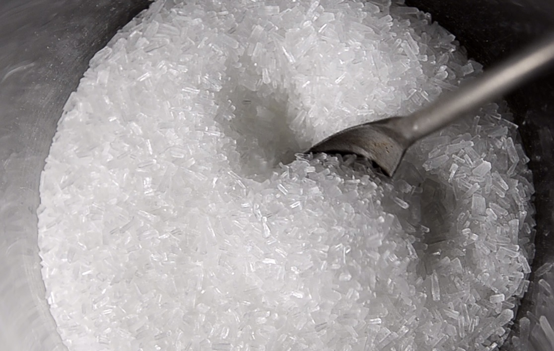

Some very weird and interesting news to report. With food grade (>99%) MSG at hand and some reagent grade c.HCl I had a go at preparing just the glutamic acid again (no proper glassware though, but accurate weights / measures).
The MSG used was 'Ajinomoto' brand (Japanese import) from a new 500g bag and was in the form of small semi translucent 'shard' crystals, some of which were quite spiky and pine-needle-like.
50g were dissolved in 90ml of water and then 25ml of c.HCl added. After a very brief pause (1 second perhaps) a thick white precipitate was generated, and a bit of heat generated in the mixture. The precipitate was then filtered and washed with difficulty.
Observations:
1. The precipitate was much finer than the previous one we captured on video, and formed a mixture more akin to 'plaster of Paris'. It didn't settle in the mixture as the previous one did.
2. Filtration was much more difficult than before and the solid very difficult to dry substantially. It also formed a 'gel' in the filter where no water would filter off (even with vacuum) but on agitation 'wetted' and then more water could be removed. This is totally different to what we previously captured on video.
3. The crystalline appearance of the starting material is very similar to the one we previously used, but is slightly different. The previous material didn't form the 'needles' and was more cubic in nature.
4. No hard evidence, but the MSG used on this occasion seemed to be slightly less water soluble than in the previous one. Dissolution seemed to be slower.
The only possible conclusion I can come to is that what we previously used in the experiment, although labelled as 'Aginomoto >99% MSG' could not have been what it said is was! I will try to track down and see if I can find any archive footage of the original bag and labeling to see if I can find the exact same brand again! This is somewhat disturbing...
I've checked our inventory list and we did retain the sample of what we thought was succinic acid from the previous experiment that we captured on video (it is in storage). So I will make an effort to get this out when the opportunity arises (probably the next week or so as chance would have it) and see if a melting point can be obtained.
Open to any other thoughts or suggestions!
[*] posted on 20-12-2016 at 09:40
Thank you chemplayer for pursuing this discrepancy!
Your observations on making glutamic acid are consistent with what I observed with 3 different OTC sources of MSG. The last was the Aji-No-Moto, a Japanese company brand, but made in the US. I presume the manufacturing process was Japanese.
You liken the paste to Plaster-of-Paris. I agree. To get a good wash I slurried the 20g or so of the paste in 1000mL of distilled water, then sucked it damp on a 15cm Buchner filter. The acid was then air dried and ground to a powder with a mortar & pestle.
So, it seems we have some evidence that the MSG you used in making your video may be different in some important way(s) to what is available on the US OTC market.
It may be worth the effort to obtain some Aji-No-Moto MSG directly from Japan.

[*] posted on 20-12-2016 at 17:16
Yes I trust the Japanese made brand to be what it says it is. I looked through the complete video footage archive and I can't find a shot of the previous bag of MSG that we used for the video, however I did find separate footage of another experiment (never turned into a video) using the same starting material (but a different reagent grade HCl source) where we dissolved it and acidified and the result was the same as in the published video - again, suggesting that it's the startiong material that is the anomaly.
I am intrigued now and might go and buy a few different 'local' brands of MSG powder and see if the results are consistent and if any of them reproduce the previous results.
Here are some quick photos / screenshots showing the 'mystery MSG' and the acidification product, and the Japanese one (where we are getting consistent results).
1. mystery msg acidification prod.jpg - 87kB 1. mystery msg.jpg - 62kB 2. japanese msg acidification prod.jpg - 148kB 2. japanese msg.jpg - 196kB

[*] posted on 20-12-2016 at 18:21
Here is some information which may help with the conundrum you currently face.
According to Greenstein and Dunitz in "Chemistry of the Amino Acids" V3, pp1929ff, the HYDROCHLORIDE salt of glutamic acid is formed in HCl solution and its insolubility "far exceeds" that of any other amino acid hydrochloride. It then stands to reason that what you isolate on acidification of MSG with a large excess of hydrochloric acid is the hydrochloride salt of glutamic acid. In fact the preferred method of isolating glutamic acid from protein hydolysates is to precipitate the HCl salt with excess hydrochloric acid. The above authors then go on to discuss the instability of glutamic acid (and glutamine) in aqueous solution as it readily cyclizes to pyroglutamic acid.
The melting point of pure, dry glutamic acid hydrochloride is reported as 208-9 C (dec).
The above authors give the following procedure for isolation of pure glutamic acid from the precipitated hydrchloride:
"36.7 g of the pure hydrochloride are dissolved in 200 ml of hot water, adding 20 g redistilled aniline, and quickly cooling to room temperature. Ethanol is added to 80% with stirring and the mixture allowed to stand at 5 C for 20 hr. The crystals of pure glutamic acid are filtered over suction, washed with 95% ethanol until chloride free, and finally with ether. When dry, the yield amounts to about 27 g; mp 211-213 C (dec)."
But wait, there's more:
For the isolation of glutamic acid from commercial Ajinomoto/MSG (also from the above reference, p 1938):
"the salt is brought into suspension in about 4 times its weight in hot water. Norit is added and the mixture filtered. To the clear solutuion, now brought to the boiling temperature, 4N hydroBROMIC acid [my emphasis] is added to pH of 3.0and the solution allowed to stand for several hours at 5 C. The crystalline glutamic acid is filtered and washed successively with ice water, ethanol and ether and should be halogen-free. The yield from 100 g Ajinomoto containing some 85 g of sodium L-glutamate may be about 50 g."
I gather from the above that some commercial MSG is less than 100% MSG, perhaps containing anti-caking material or just junk.
Clearly, the simple addition of hydrochloric acid to MSG is not giving you what you think it does thereby leading to a messed up synthesis of succinic acid. The isolation of glutamic acid is a bit more complicated than simple precipitation.
At this point I would simply buy succinic acid and , at the risk of snarkiness, suggest doing a bit more literature work before dragging out the test tubes (apologies in advance).
AvB
