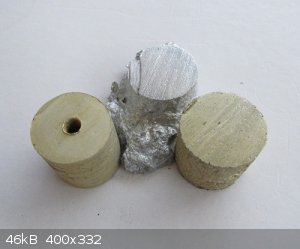

[*] posted on 20-11-2016 at 09:27
Amazing how easy anodising aluminium actually is !
Found this document :-
http://www.creative-chemistry.org.uk/activities/anodising.ht...
All i used was a car battery, a small sheet of Al chopped into strips (to make the wires & cathode) a bit of sulphuric acid and 1 litre disposable beaker.
A meter was used to measure the current, so acid was added until a decent current was flowing (~3.5A)
No actual dyes exist here, and all the shops are closed (without exception) on Sundays, so various things were tested without success.
Eventually dark soy sauce was tried out as the dye ...
side.JPG - 46kB
Gold ! (ish)
top.JPG - 46kB
All three bits of Al came from a 3/4" bar cast yesterday. The top one wasn't anodised just for reference.
With any luck i might get access to a lathe tomorrow and turn those bars into tiny crucibles, which can then be made Gold coloured with the soy sauce anodising trick.
Just the crucibles and the <u>.&nbsp;&nbsp; RG</u> baseplate to go, and a lot of sandpapering.
The baseplate will be another lost wax casting. Incredibly hard to make a flat plate, never mind an 'R' and a 'G' from wax candles.
dotrg.JPG - 51kB
The idea is to melt/stick those to the cast sheet of wax, dollop a plaster 'slip' all over them, coat in sand, then repeat a few times before burning the wax out in an oven (or over a fire).
When finished, the molten aluminium gets poured into the space, so you end up with a metal version of whatever shape the wax was.
