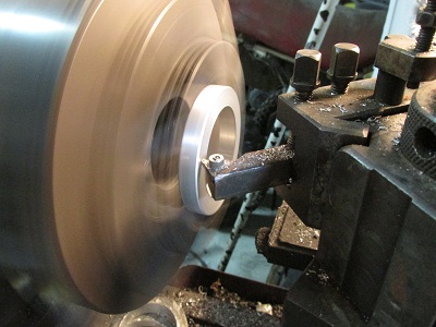

Today i got some delicious Lathe Time !
Hard to believe it has been 15 years since i last had any.
As it turns out, i have forgotten how a radius is turned by hand, hence the grotty crucible shape on top of the aluminium rod.
crucibleattempt.JPG - 91kB
Got more lathe time tomorrow morning so will try and get the shape better and hollow the crucible out.

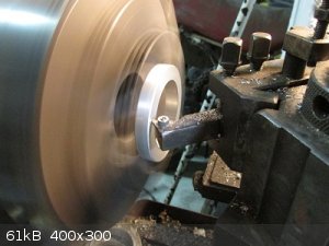

Trimming up the 'rings' was great fun. This lathe is Proper and has power travel and slide.
ring.JPG - 61kB
Nice optical illusion of a perfect Al ring - it is certainly an illusion !

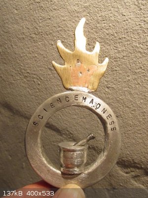

Penultimate update :-
Making these things has turned out to be great deal more convoluted than imagined.
The operations required (so far) are :-
<strike>Make polystyrene flames pattern
Cast bronze into flames
Cast copper into middle of flames
Chop flames into slices
Grind flame slices into shape
Make cylinder wax model
Make cylinder mould
Cast cylinder
Chop cylinder into rings
Drill holes & slot into ring
Fix flames to each ring
Stamp in lettering
Cast Al bar
Turn mortar-ish shapes into bar
Chop mortars from bar
Drill & tap mortars
Grind & chop steel rod into tiny pestles
Make baseplate wax model</strike>
Make baseplate mould
Cast base plate
Chop baseplate into slices
Drill & counter-bore baseplate
Anodise mortars black
Bolt together baseplate, circle & flames, mortar
Expoxy pestle into mortar
Optional: clean & Highly polish everything at all stages
Finally: Stamp in winner's sig, package & post.
pnm.JPG - 137kB
Might not get time to do the optional bit, although a Bonus piece of sandpaper can be included with each trophy ;)
With any joy they will all be as finished as they are ever going to get by this weekend.

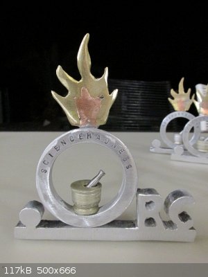

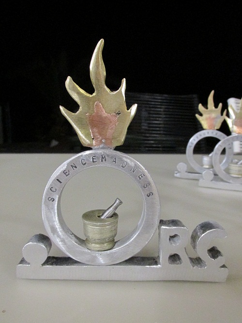

[*] posted on 30-11-2016 at 11:51
Beauty is always in the eye of the Beholder ...
In order of Weight :-
141g
141g-small.jpg - 116kB
156g
156g-small.jpg - 117kB
163g
163g-small.jpg - 120kB
168g
168g-small.jpg - 119kB
Materials :-
Recycled aluminium for the ring, mortar and .RG baseplate.
Steel for the pestle, fixing bolt, flame-fixing pin.
Brass plumbing fittings for the larger flames.
Copper pipe for the centre flames.
Lead/tin solder for any filling required on the flames.
Some epoxy cement to fix the pestle.
Edit:
Forgot 'mine', 130 g, plus the SI reference guage for size.
130g-small.jpg - 81kB
[Edited on 30-11-2016 by aga]
