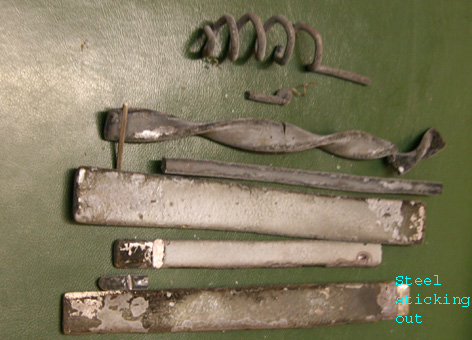

Some cooked iron pieces.
Some of the pieces are broken as I broke them to see of the iron was all gone.
All the iron is gone on the spiral shaped piece (a 2.5 mm welding rod) and the iron that has a slow twist to it.
The run was about 14 hours, less would have probably done the job.
Another piece shows a piece of the original iron sticking out as the oven broke down after about 8 hours. It would have needed about 12 hours to cook
all the way through.

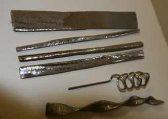

Picture a shows a selection of iron pieces before going into oven.
There are some defects on the pieces in picutre b. This is caused by the pieces being in contact with quarts tubes that I used to furniture in the
oven. The spiral I hung up using nichrome wire which can be seen stuck to the ends.
Even a piece of rustproof stainless steel was converted to magnetite. It was rustproof as it was in the open for a few years. It come from the inside
of the rubber of a car wiper. I should have tried some ss welding rods of known composition to see if they would hold up. Pure nickel holds up well
but is brittle when run is finished. Grade 2 titaniun is converted to a black crisp (very thin piece anyways).
Furniture for placeing the pieces is not easy to obtain. Fused quarts blends into the piece.
What could you use?
Nichrome wire used to hang the pieces up seems to work OK.
The magnetite is not very conductive.
Yob

What oxides do I actually have does anyone know?
Next Kookup will be an attempt at making a Magnetite retort.
Yob
