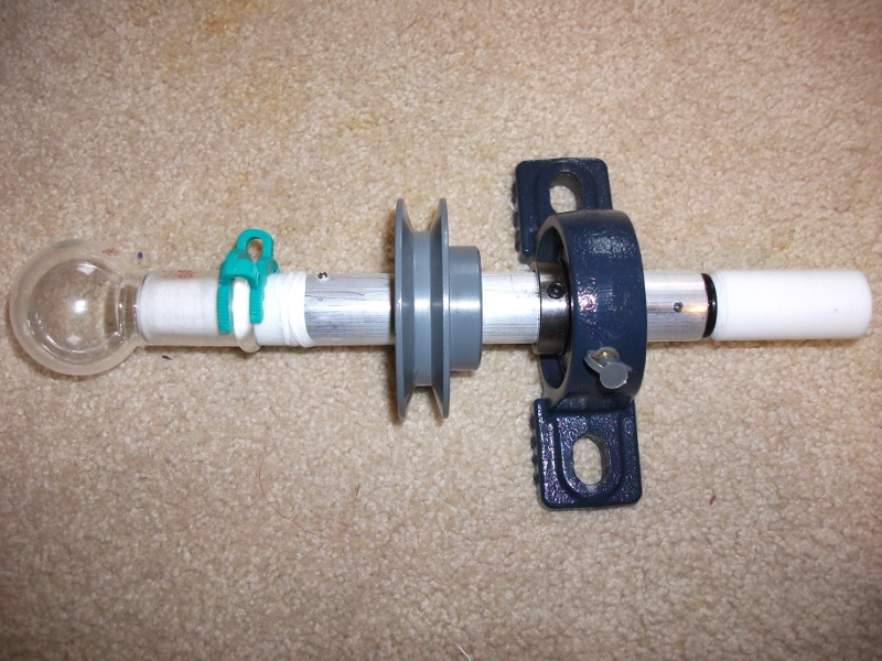

Making progress. I cut the aluminum rod by taking a piece of paper wrapped around the aluminum tube making sure it was straight. I taped the paper down firmly, and put the tube into a series of clamps and busted out the old hack-saw. Cut through it like butter, much easier then cutting through wood to be honest. I cut through a side, rotated the tube, cut through another, etc. Then handfiled the tubing smooth.
The pillowblock bearing was fit onto the rod the marks for the set screws were marked with permanant marker. Notches were filed into the tubing to match them and the bearing placed on and set screwed in firmly. This was repeated using the pulley. Both items are on firmly and even on man-handling attempts they do not move.
So glad I chose aluminum and not stainless steel. Was done in about an hour from tube to rotor.Tommarrow the teflon rod will be machined to fit firmly into the aluminum tubing. Screws will be put through and perhaps extra plumbers tape(PTFE) to keep the connection air-tight.
progress.JPG - 106kB

So I bought a tap (6-32) and a set-screw(6-32). Having no idea what I was doing I punched two holes into the rotor. Put the tap into a set of pliers with some PEG oil. Gently went back and forth until the tap could be screwed by finger in both holes. Put the set screw into both with an alan wrench. No issues. Whew. This should work out :) Machining the teflon 24/40 attachment now then I'll be back to post a picture or two(in this same post so I'm not post-whoring).
Edit/Update: Finished machining the teflon. Tried using PTFE tape to make an air-tight seal didn't quite cut it. No big deal that was pretty expected. Will scoop up o-rings soon, or something similar. Here's some more pictures I guess.
The set-screw seems to work as expected. 7$($6 tap+bit and 0.50$ set screw) fix whew. Feeling pretty good about this now.
DSCF0001.JPG - 89kB DSCF0002.JPG - 106kB
edit - update again
Stuffed an o-ring onto the teflon rotor with a bit of PTFE tape, lined the set screw with a bit of PTFE tape. It holds a vacuum!
[Edited on 23-12-2012 by smaerd]
DSCF0004.JPG - 123kB

What about using a glass stirrer bearing? for the end connection? They use them for air-tight stirring with teflon rotors right? Heating wouldn't be an issue because the application is low RPMs and ideally low friction.
Finding a spherical joint for this is looking to be very expensive and elusive. 35/25 is too big for 1" OD teflon rod, its either 18/9 or 18/7 and I can't find this size anywere other then for "glass-stock". I REALLY don't want to hand-carve two parts to a ball/socket joint to make this work but if that's what it comes down too I guess I'll have too(have plenty of left over teflon)...
I also figured out how to "polish" the PTFE smooth. I have been slowly grinding the material away with a sanding attachment on the drill-press(with a shop-vac to remove the fine dust clamped nearby and a dust mask + goggles). This makes the surface rough, good for the 24/40 attachment, bad for the ball-valve or other vacuum connection. All that needs to be done is take a small kitchen knife and gently peel away a layer of the stuff. Might take a bit of 'chipping away' but it creates a nice smooth surface. Figured this out by cleaning up some of my sanding work. :)
All that's basically left to do is carve the ball-joint(which I'll need a ball-joint for to make sure I do this right as I'm doing it all by hand), already have the air-tight end finished with the set-screw notch in place. Then hook up the motor assembly and mount.
and another picture just for kicks
DSCF.JPG - 208kB
[Edited on 24-12-2012 by smaerd]

Well the build works great or it did. I realized my rotor was slightly camming because I had accidently man-handled the pillow block bearing onto the shaft. It was still holding a vacuum but having the glass ball joint wiggle up and down slightly annoyed me. So I dismantled it and tried tapping the bearing back into place with a screw-driver and a hammer... Dinged the bearing shield pretty good now its a fair amount harder to rotate. So I need a new pillow-block bearing but, it does work. Holds a vacuum just fine and was ripping ethanol/methanol mixture no problem at all.
I'm going to conclude the building plan updates because the build is a success and work on a finalized write-up. Thanks for all of the advice along the way everyone it meant a lot and I couldn't have come this far without science-madness. After I make a finalized write-up I will only make updates as to the condition of the device over-time. Such as what parts have broken after 6 months.
