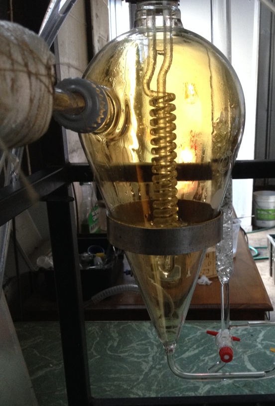

Benchtop Ostwald Pilot Plant Success
Here is the pilot plant.
It's a photo shoot of the unit in operation.
PilotPlant.JPG - 270kB
In a converted TV stand you can see the urea decomposer in the mantle front left. The black lump in the middle is the air compressor. The reactor tube runs into the converted 2L sep. funnel which admits air via the custom condenser fitting. The condensate runs into a reservoir where excess gasses run to an absorption tower.
PilotReactorSml.JPG - 124kB
This shot shows where the ammonia air mixture is fed into the reaction zone, the nice red glow is transmitted up the quartz.
PilotRedFumes3Sml.JPG - 177kB
Red fumes; condensation forms on the walls and the condenser. That's nitric, baby! You can see the tower behind it and the take off tap to collect the tower absorption.
PilotReservoirSml.JPG - 313kB
The condensate ends up in this collection flask and you can see the splash head type design to let the outlet gasses pass into the tower. There is still a lot of fumes, enough to be visibly red, but once they go to the tower there is no evidence of anything leaving the tower. Kind of important not filling the room with NOx.
PilotFizzSml.JPG - 199kB
Does it fizz with bicarb? You betcha!

Unbelievable!
Realy well done. I'm gonna examine those pix closely when I get on a larger screen.

Yesterday was it's first real run, I'll do some do some titrations soonish. But the air compressor might as well be an aquarium pump, it's a 24V dc thing that came out of something, I can't recall what, but it's low power and chugs along on 12V.
There's no real pressure in the system, just the back pressure of the small amount of water being bubbled in the tower which is open to the air. It's actually a simple system. Don't be put off by all the complicated glassware, I did it this way because I can. I'm sure this could be made with found items and a bit of creativity. No silica used, yet! I might find a use for it, but drying the gasses seems more effort than it's worth. Although the ammonia generator spits out a fair amount of water vapour and only dilutes the acid. I could put a condenser coil in the mixing flask to reduce that.

I modified the catalyst in the pilot plant. It's crushed and screened expanded clay balls used as a growing medium. I sieved out the fine stuff and used another screen to take out the bigger more irregular pieces. A spatula's tip loaded with Co carbonate and a little demineralised water and a good churning to get it coated. That's it! Better flow rates and seems to work at lower temperature, the current draw was only 1.7A at 24VAC in the heater
PilotEndShot.JPG - 203kB
This is the tower, packed with broken glass and a little water. The reservoir with the blue tap holds the concentrated stuff and the exhaust gasses pass into a vertical anti suck back column before running along a small tube to the base of the tower. The red tap can draw off the dilute acid as needed.
One other thing to note is the syringe attached to the reactor inlet. (not in this shot by the way)
Slowly draw back 10ml, disconnect the syringe and put a finger over the end quickly, then put the tip into some water. The ammonia dissolves into the water and the water fills the syringe to replace the volume. You now know what ratio of ammonia to air is being fed to the reactor.
I'll keep you informed of process specs and mods as I make them, the concentration of the acid is going to be the first test.

Carbon dioxide is also very soluble in water. Keep that in mind as you sample the gas feed, if this gas is present.
I'm very impressed with your setup; jealous, in fact, but in a good way. Good job!
What do you estimate the gas feed to consist of (even if you think the number isn't very accurate)? It would provide a starting point for future efforts, at least.
Chemetix
Posts: 376
Registered: 23-9-2016
Location: Oztrayleeyah
[*] posted on 24-12-2016 at 22:01
The syringe technique relies on the ammonia absoption being a good deal quicker than the CO2 absorption. Doing a quick dunk in water fills the syringe in about 30 seconds. I'd say leaving it there for an hour or more would take up most of the CO2. But the quick and dirty result came back with around 6% by volume. I think that around 12% in air is stoichiometrically balanced. It just meant that I turned off the air inlet to the oxidation chamber and let the excess O2 oxidise the NO. It was obvious that the air bleed wasn't needed at the oxidation chamber because the chamber went a much deeper colour without it turned on.
It does highlight that the rate of ammonia production is going to be the step that will allow higher production rates, and drying it will mean more concentrated product.
So far the CO2 doesn't seem to hinder the process aside from being dead volume in the reaction stream.
I think a future project will absorb the ammonia into water to get rid of the CO2 and use the saturated solution to generate ammonia, a passive recirculating system attached to the urea reaction will be the best way to go, and possibly use the waste heat from the reactor to generate ammonia from the saturated solution.
I'm liking the suggestions and I think this is going to get a few brains thinking of better ways. I'm really hoping to see some experimentals come to pass from other members.
It has struck me as I write this that I could do a kit of sorts.
If you PM me I can send a small piece of quartz tube with or without inlets to you for a few dollars US$40-$50. Shipping is variable so I could only guess at a value. I wish it was cheaper but quartz costs a bit and working with it is slow. (if you were a commercial customer the value would be easily 3 times the SM price.) I'll send some pre-prepared catalyst if you like.
Sorry if this setup is too much glass-porn for some of you, @WGTR. I work with it and I still love a sexy bit of glassware.
[Edited on 25-12-2016 by Chemetix]
WGTR
Posts: 972
Registered: 29-9-2013
Location: Online
Mood: Outline
[*] posted on 25-12-2016 at 02:15
OK, so the gas feed appears to be oxygen-rich...that's what I was wondering about.
I like working with glass, too, but i don't have all the fun, expensive, tools. I'm pretty much limited to working with tubing that I get from the science store in town. Soda-lime is pretty easy to join and work with various hand propane torches, and I can fuse boro if I'm careful. But quartz...I just can't! I would love to have a glass-blowing lathe!
The kit idea is a good one. My first thought, however, is to see if the reaction temperature can be lowered enough that borosilicate can be used. That's why I was thinking of preheating, and whether it would give better heat distribution in the catalyst, and hopefully allow a lower maximum temperature. Quartz, however, is the Cadillac of glass. It doesn't get any better. It's just, as you say, expensive and difficult to work with.
I'm wondering if the blue-indicating silica gel might work as a catalyst. It normally contains a cobalt salt in small amounts. Sorry, I keep obsessing about silica gel. For ethanol dehydrogenations, I've prepared the catalyst by co-precipitation of the active copper hydroxide with the inactive magnesium hydroxide support. I think cobalt could work the same way. Starting from a soluble salt makes the starting materials easier to define for a hobbyist, I think. Maybe something like this would work, and be easier to define and repeat. Just an idea. I'm trying to think of ways to minimize variables and avoiding the possible issue of "I just did it the way you did, and I couldn't get it to work". If something like "builder's sand" or clay particles are used, then ideally those materials need to be defined as to purity and provenance, so that others can duplicate it. I can try to prepare this precipitated catalyst if you want, to see if it has the structure that I hope it will. Let me know the inner diameter of the catalyst tube.
