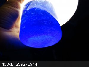

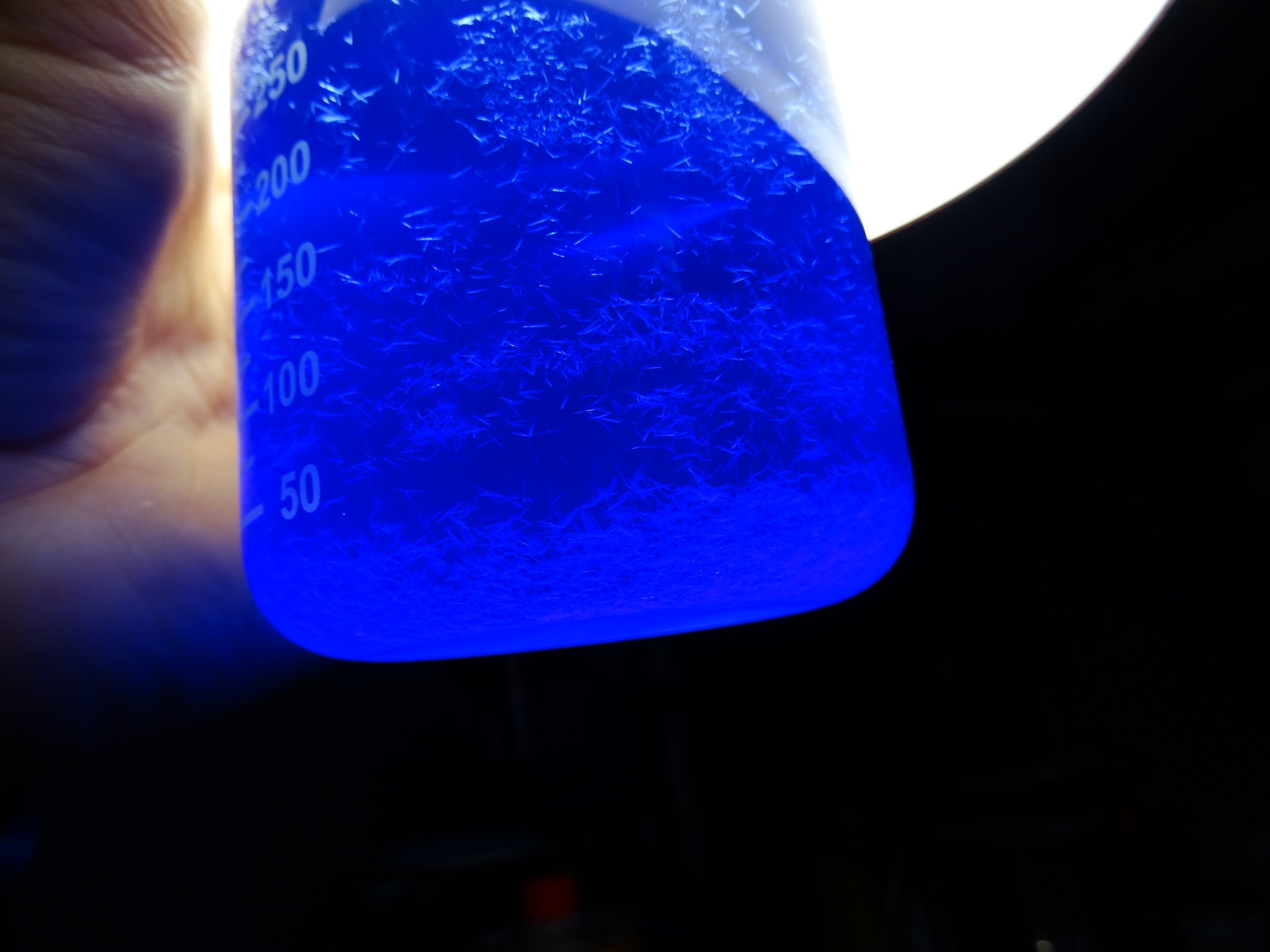

Hi!

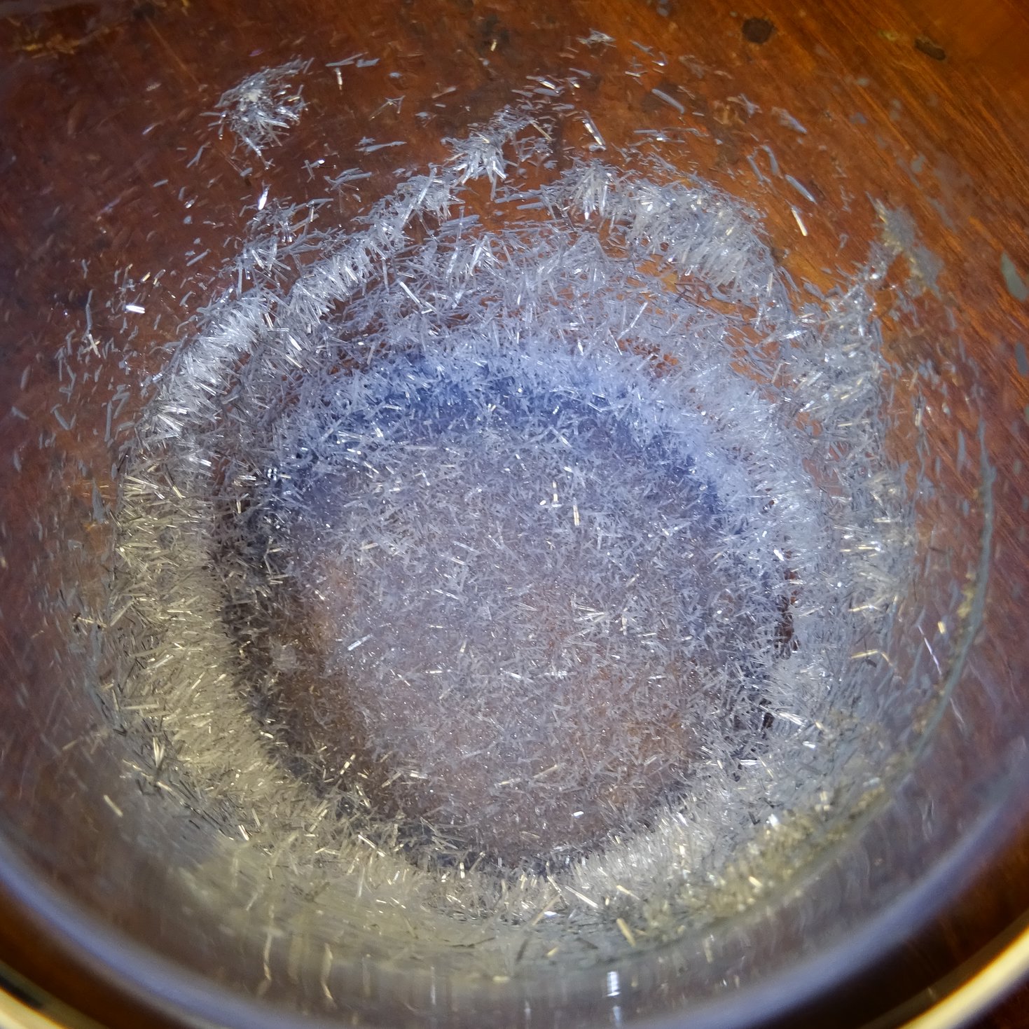

I've made some tetraamine copper sulfate (solution was clear and nice deep blue color after filtration of copper hydroxide). I tried to get rid of water by heating the solution on a hot plate - and that worked until it started foaming too much. Solution also became light blue (there was no more purple color to it). On the bottom of the beaker I've noticed some purple precipitate and also something white-ish (I think that's probably ammonium sulfate). There was also something greenish (maybe copper hydroxide? - but is it soluble enough?). However, I've used ethanol to force the remaining tetraamine copper sulfate out of the water and after filtering, the water is almost clear (only a bit blue) and on the filtering paper there's a lot of blue precipitate, but only a small amount of purple precipitate - is it possible that tetraamine copper sulfate and ammonium sulfate are somehow mixed, to give this blue color? And how to separate them?

I suspect that you drove the ammonia away as a gas. You should not have had any copper hydroxide left, if you did, you did not use enough/strong enough ammonia. The wikipedia page for this compound suggests to add alcohol to precipitate the purple complex.

[*] posted on 5-1-2017 at 01:56
Thank you all!
@pantone159
Yes, that's exactly what I did - I didn't use enough ammonia and I also didn't use enough ethanol to precipitate the tetraamine copper sulfate.
Here are some pictures :)
Those white crystals on the last six pictures are probably ammonium sulfate - they look nice, but how to get them out of purple complex?
