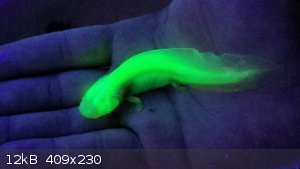

there are GFP axolotls you can buy....
9858357.jpg - 12kB
