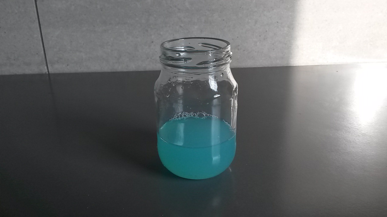

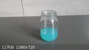

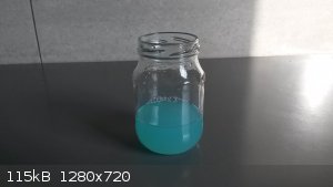

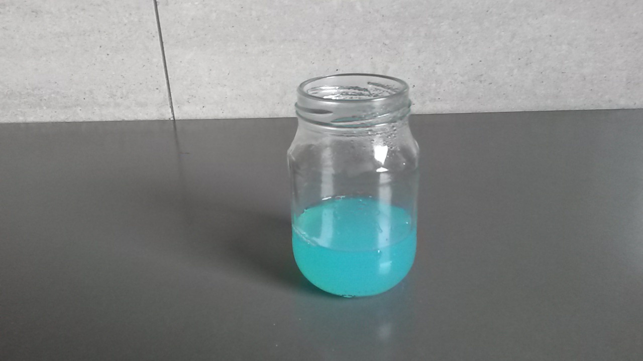

But to prove how crudely such a solution can be made, I used arbitrary amount of CuSO4, table salt and tap water. I just followed brief procedure I mentioned here: make green solution, dilute to blue. It worked. Here are the pictures:
The first one is before heating (room temperature).
The second one is after one and half minute in microwave at 300W.
The third one is heated solution after 15 minutes outside in snow.
Note that the solutions are murky, but that's due to table salt being impure - copper sulfate solution was clear before adding NaCl and diluting the solution to blue color.

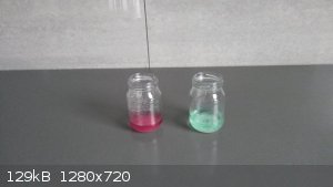

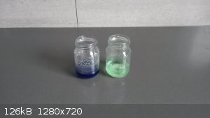

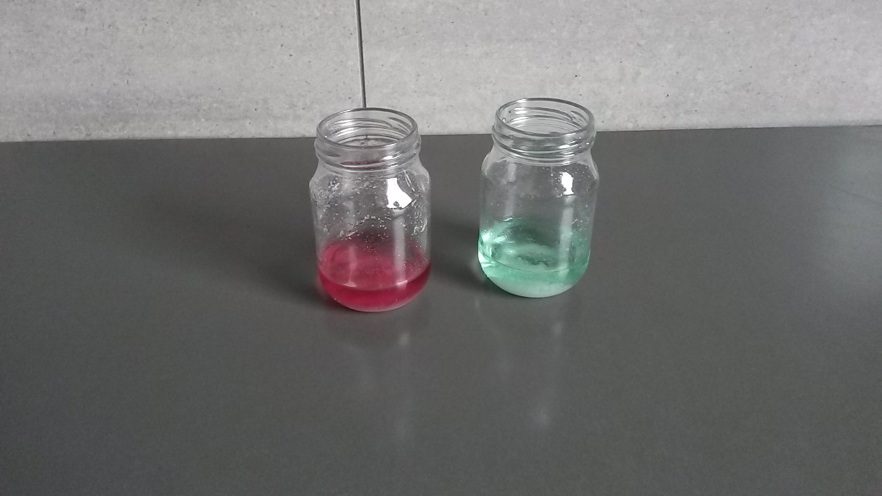

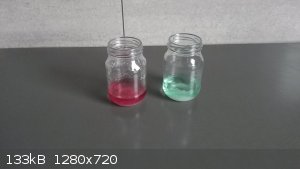

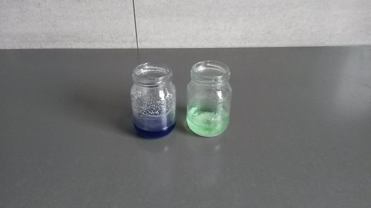

Left is CoSO4 solution acidified with vinegar, saturated with NaCl (some is floating on the bottom, solubility of NaCl is only slightly affected by temperature so it is ok) right one contains nickel acetate instead of cobalt sulfate.
First pocture is rt, second after microwaving (3min at 600W, both jars at once) last one after cooling outside in snow.
Sorry for such a long delay.
