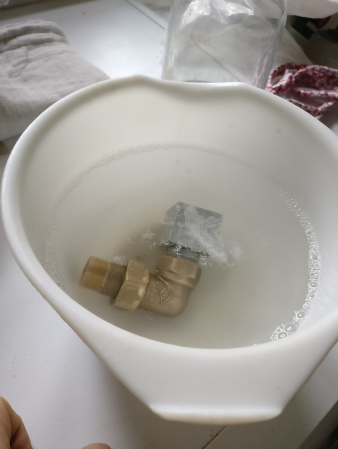

I am constructing an automated soxhlet unit for recreational use and one of the machine parts causes me some concern.
I have built an evaporation chamber out of spun aluminum that leads the vapour using a brass fitting to an electrically powered condensor. My concern is the brass / aluminium interface. In marine environments brass / alu interfaces are a nogo because of galvanic corrosion.
My system will however solely be used to distill ethanol and other alcohols and will not get close to salt water.
To test worst case conditions i have milled out and assembled a brass / stainless steel / aluminium system and submerged it into saturated salt water with a small amount of detergent in i. As seen in the attached image there is a slight evolution of hydrogen. I have repeated the experiment with the same metal system submerged in 90% isopropylalcohol. No results from the second experiment yet, but i will post it once it has had a little time.
My question is:
Do you think i can get away with using this metal interface when the machine solely is used for vapours with high alcohol content solvents? I need a 5-10 years lifetime of the machine.
Thank you greatly for any input!
Best regards
Bandil
corrosion.png - 456kB
[Edited on 28-4-2017 by bandil64]

[*] posted on 28-4-2017 at 09:12
I wouldn't recommend using brass in case someone decides to run vinegar through the Soxhlet or extracts an acidic material, although you could probably get away with it.

[*] posted on 28-4-2017 at 10:50
Good pont, altough the system is designed for ethanol and ipa extractions alone. I could however very well see the risk that people will experiment with acidic solvents.
What about a stainless steel / brass combination? Most pro coffee makers are made of these alloys. The element are pretty close in the reactivity system.
Ill conduct experiments on elevated temperatures with slightly acidic ethanol and see how the brass / alu system behaves and post results here. Alu and brass are awesome for manufacturing so it would be nice to get a stable and reliable system with.
Regards Bandil

[*] posted on 4-5-2017 at 23:17
As long as the part made out of the more reactive metal (the aluminum) is bigger than the other one, you should be fine. Particularly if running an anhydrous mix through it.
This is also why you shouldn't use iron rivets in a copper pot, but can do it the other way round without much trouble (at least from a corrosion point of view).
