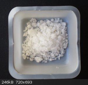

OK quick update on my prelimenary experiment. I mixed approximately 11 ml of acrylic acid (measured with a 25ml cylinder) with an equal volume of dichloromethane, they are completely miscible. To this mixture was added in 7.5-7.7ml of bromine in units of about 0.5 ml. The bromine is absorbed and the brown mixture turns colourless again fairly quickly, the reaction is only mildly exothermic but as the temperature rises the liquid decolourizes more quickly. Once all of the bromine had been added the mixture was left to stand in a warm place for about an hour and then filtered to remove a small amount of soft white gel (presumed to be a polymer). The filtrate was poured into a shallow bowl and left to evaporate. By this time the mixture had become almost colourless.
I'll be back.... with the results. Tomorrow.
OK I left it to stand overnight and the DCM has evaporated leaving a nearly odourless, colourless, thick liquid that doesn't want to crystallise, any ideas guys. Possibly triturate with ether or water?
[Edited on 5-5-2017 by Boffis]
Posts: 1910
[*] posted on 5-5-2017 at 03:31
I tried mixing 0.5ml of the thick syrup like liquid with an equal volume of ether, absolute ethanol and chloroform. All were miscible but no crystals formed.
However, in the mean time the residue has started to crystallise spontaneously!
Posts: 1910
[*] posted on 9-5-2017 at 07:26

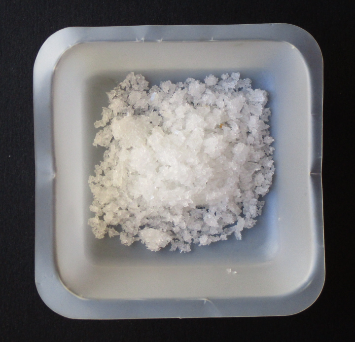

Well after 2 days at 11-13 C no further crystals appeared to form so I filtered off the crystals at the pump and then kept drawing air through the crystals until they were loose and apparently free of any liquid. I transferred the crystals onto filter paper and pressed them and then left them to drain for 2 days. The result was 11.74g of pure white, almost dry, prisms of an odourless compound that I have yet to investigate but which look promising. If this material is the dibromo acid then the yield was about 33% which according to the paper above is rather poor. I will re-crystallise it as described in the paper above.
The syrup residue was mixed with water but doesn't dissolve though the aqueous phase becomes acidic. The mixture was carefully neutralized with cooling with 40% sodium hydroxide, it became slightly cloudy but little other signs of reaction were visible. It was left to stand over-night when is separated into a mobile upper layer and a lower layer of gel. The upper aqueous layer was decanted and evaporated down slowly at low temperature. I am now waiting to see if any crystals form.
The gel was very insoluble in everything though hot dilute caustic soda decomposes it and render is water soluble very quickly, it was not investigated further.
It is fairly clear that the acryllic acid that I have, which is many years old, is rich in polymerisation products. I will repeat this preparation in the near future but before I do I will vacuum distil the acryllic acid.
2,3-Dibromopropanoic acid.jpg - 246kB 2,3-Dibormopropanoic acid?

I found for example that the best solvent is a volume of dichloromethane equal to the volume of acrylic acid, more solvent than this causes the formation of gummy lumps early on in the bromine addition whereas with the smaller volume of DCM the reaction mixture remain homogeneous. The acrylic acid must be freshly vacuum distilled to get a decent yield but gummy polymerisation substances are still present in the raw product. The amount of bromine required is only about 85% of theory suggesting that even the vacuum distilled acid still contains some impurities.
Recrystallisation proved difficult until I discovered that chloroform is the best solvent for this purpose and only 2ml are required to recrystallise 10g of raw dibromopropanoic acid!! Distillation of the residues and washings allowed the recovery of about 70% of the chloroform too. DCM is too volatile to be practical and various alcohols were tried but their solubility gradients are too flat. The mixed solvent advocated in the paper above offers no advantage, complicates recovery of the solvent and the alcoholic solutions become viscous if chilled.
I had 3 x 250ml of acrylic acid bought in about 2013 from Mistral NI, an ebay supplier at the time. I had 720ml which I vacuum distilled at 45-50mm Hg to give me 320g of freshly distilled acid. This should have produced 1030g of dibromo acid, however, I carried out the bromination in two goes and during the first I filtered off 121g of gummy material before even 20% of the bromine had been added so the yield does not look that bad at a little under 500g (376g of recrystallised acid plus material still being recovered from the washing and recrystallisation solvent experiments)
