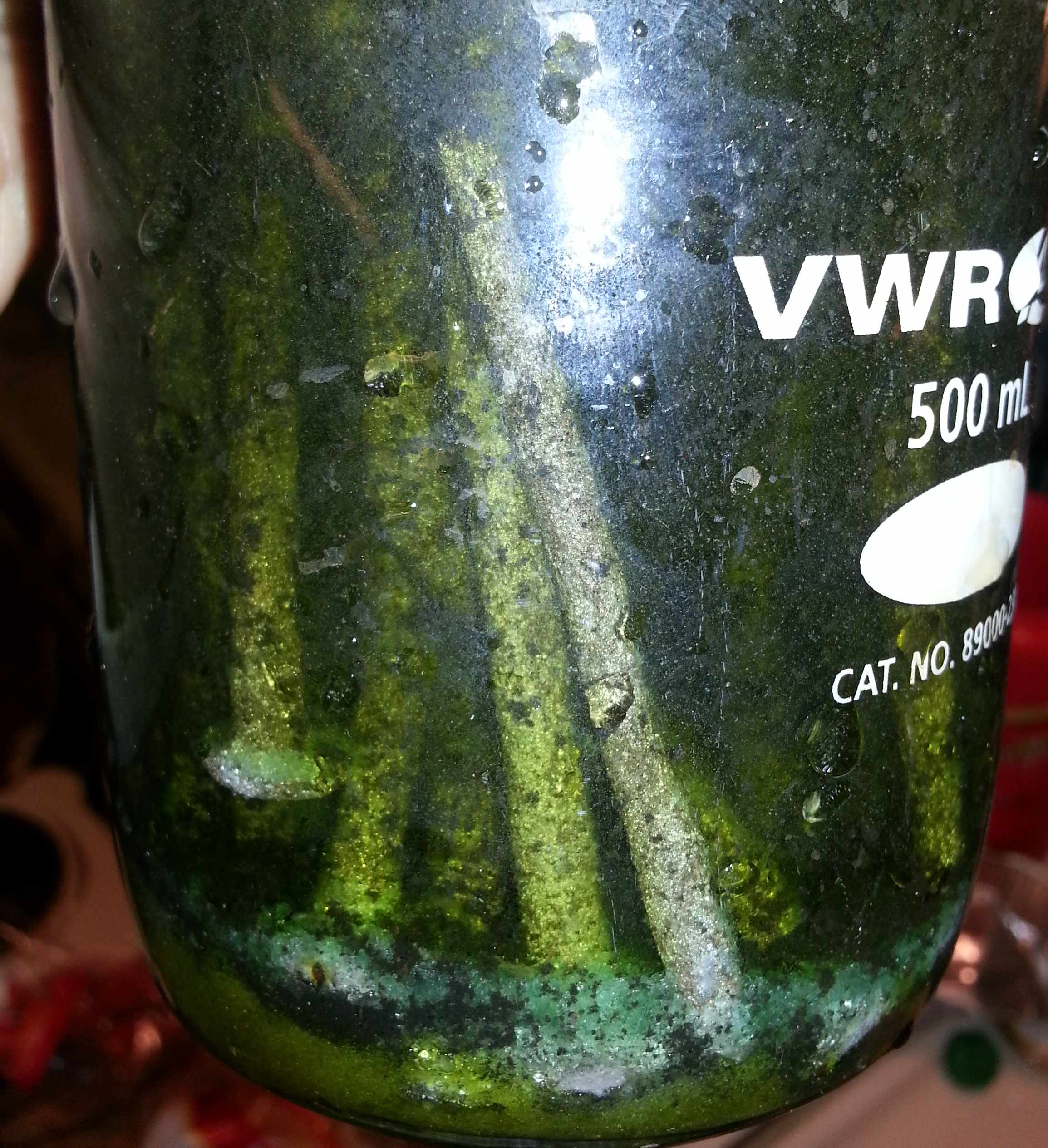

Here are some pics after the first addition of hot water. It has changes somewhat since then oddly enough with the crystals on the bottom changing color to a more sand color. I added near boiling water instead of just hot tap water and the bubbling increased by probably 400-500% from the 135 degree water.
FeCl2+3_1.jpg - 169kB FeCl2+3_2.jpg - 176kB FeCl2+3_3.jpg - 496kB FeCl2+3_4.jpg - 364kB
[Edited on 9-5-2017 by RogueRose]
FeCl2+3_5.jpg - 19kB

Yes, those pictures bring back memories; especially memories of that smell! The pale-blue green FeCl2.4H20 crystals is what I had tried to collect in my youth, but these crystals would quickly lose that bluish color and become more green, then yellowish green as they oxidized, exposed to air.
Maybe you could store the FeCl2.4H20 crystals under CO2 to preserve them if that's what you want to try. Propane, propylene, butane, 1,1,1,2-tetrafluoroethane (Dust-Off), N2 or Ar will all work as alternative inert atmospheres. Pick your most convenient/safest.
More regarding 'that smell'. I'm almost certain it's caused primarily by phosphorus hydrides, though not necessarily pure phosphine. Traces of phosphorus hydrides other than PH3 (eg., P2H4; the stuff that's actually spontaneously flammable) are probably generated.
Regarding collecting and characterizing this smelly gas: remember it's almost pure H2 with some HCl and H20 vapor. There is no way you will have sufficient phosphorus hydrides generated in this mix of vapors coming from your dissolving Fe nails to make them spontaneously flammable.
In any case, no steel product has that much phosphorus in it.
Best to avoid the stinky stuff and vent it out, unless you have a use for impure H2.
I agree with, MrHomeScientist. There is probably some S in the steel too and that will come out mainly as H2S in this acidic/reducing environment. Again, the amounts are miniscule, but it may contribute to the odor.

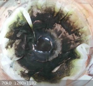

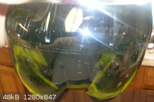

Here are some pics of more reactions. The first pick are what the water looked like after adding hot water and allowing the bottle to sit in it for about 3-4 hours (before the bottle was drained). The water was never closer than 1/2" from the cap and the liquid HCl/FeClx level inside was about 1.5" below the top of the bottle. IDK how it keeps getting brown. The next pic is the water settled after 12 hours.
Next 2 pics are from filtering the HCl/FeClx solution and then the filtrate (green)
Then the pics of what the nails looked like after being drained and rinses and then the yellow/green is with fresh HCl added - it has lots of bubbles that was vigorous for at least 12 hours but slowed after that until placed in hot water bath. The yellow color changed to a clearish grey after about 2 hours.
The final 2 are in a hot water bath after 4 hours and there is no brown color in the water. Again, the brown water happened in a plastic bath and a SS bath container.
dirty_waater.jpg - 19kB settled_waater.jpg - 33kB FeCl3 filtrate_1.jpg - 70kB FeCl2-3_filtered.jpg - 48kB nails after drained.jpg - 65kB naails with fresh HCl.jpg - 34kB nails after 24 hours - 2nd batch.jpg - 34kB nails 2nd batch with water.jpg - 45kB
Melgar
Anti-Spam Agent
Posts: 2004
Registered: 23-2-2010
Location: Connecticut
Mood: Estrified
[*] posted on 11-5-2017 at 04:56
The green color almost certainly is due to the presence of chromium in the steel.
Not just from a mixture of yellow iron III and pale blue iron II ions? After all, the yellow Fe(III) is being reduced by the metal to Fe(II).
In my experience, the cheaper the steel, the fewer metals it contains other than iron. Since no metals are cheaper than iron, alloying anything else with it would make it more expensive. I'm not actually seeing anything yet that can't be explained by iron, carbon, or the various nonmetal-based baths and pickling agents they use to treat steel.
A general observation I made in numerous experiments: When the color of a liquid/solution is brown, or has another color with a strong shade of brown (e.g. olivegreen, red/brown, orange/brown), then in many cases this means that you have a complicated mix of different colored species. Brown colors usually are not a good sign when it comes to understanding precisely what is going on.
With iron though, you'll start getting FeCl2OH and species like that if the pH gets too high, and iron hydroxides are typically red-brown. If you try taking some of the brown stuff out and adding acid to it, and then it turns yellow or a sort of clear yellow-brown, then you'll know your acid is nearing depletion. Another sign is if you start smelling sulfur species like H2S and SO2, from iron reducing sulfates.
RogueRose
Posts: 1597
Registered: 16-6-2014
[*] posted on 11-5-2017 at 05:22
Thanks for the replies! I didn't even see AJKOER's post (even though I looked many times) until just now...
I don't want to beat a dead horse, but I can't figure out how the water bath water turned brown and then the brown settled out to the bottom of the container. It seems that something must have come out of the bottle as a gas, and absorb into the water. Maybe while in the water it oxidizes (or as it moves up the bottle neck - reverses direction when it hits the cap - down/around the threads of the cap and then down to the surface of the water). It would come in contact with O2 once it exits the cap but it wouldn't have contact with O2 while inside the bottle.
Wiki states that an aqueous solution of FeCl3 is brown. The temps never got above 190F if that matters, so it didn't boil. I'm wondering if once in solution whether it would settle on the bottom like rust does, or other compounds like that (like MnO2, PbO2, etc..).
I'm going to save what is at the bottom of the water bath, it isn't a lot, let it dry and then see what it might be - but I'm open to speculation.
Melgar
Anti-Spam Agent
Posts: 2004
Mood: Estrified
[*] posted on 11-5-2017 at 05:34
My theory is that you got some Fe(II) chloride mixed in with that water, which is very pale blue in color, and then when it was exposed to oxygen, that oxidized to FeCl2OH or something similar, which would settle out as a brown precipitate.
Incidentally, this is what happened in the banded iron formations during the Oxygen Catastrophe, and is the source of the majority of our iron ore.
