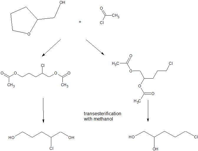

I have attempted the reaction with THFA, and obtained *something* with a boiling point around 110C at 0.05atm.
I am speculating that the reaction can go a couple of different ways;the figure below also shows the final desired vicinal diol together with a 1,5-diol. Comments welcome!

Paul, R C.R. Acad. Sci. Paris 211:645 (1940); 215:303 (1942)
I've found these two papers. There's some interesting tidbits in CR 215:303 (1942), they say that the mixture of 5-chloro-1,2-pentanediol and 2-chloro-1,5-pentanediol, obtained by the action of acetyl chloride on tetrahydrofurfuryl alcohol, was oxidised by lead(IV)acetate in diethyl ether to 4-chlorobutanal. They add that Pb(OAc)4 can be substituted by sodium periodate, but without significant advantages.
4-chlorobutanal is described as a colourless liquid with a penetrating odour, but more agreeable than butanal, bp. 51-53°C (13 mmHg), prone to polymerisation especially when heated.

To follow up, I have put the papers through Google translate and tidied up the English, enough at least to understand what is going on. I haven't transcribed the tables that were in the source docs. I have put both documents into the one translation.
For my purposes, it appears the oxidation to the aldehyde can take place directly on the mix of alcohols/diols resulting from the action of acetyl chloride on tetrahydrofurfural alcohol. And it seems the products from that reaction is as I surmised.
