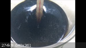

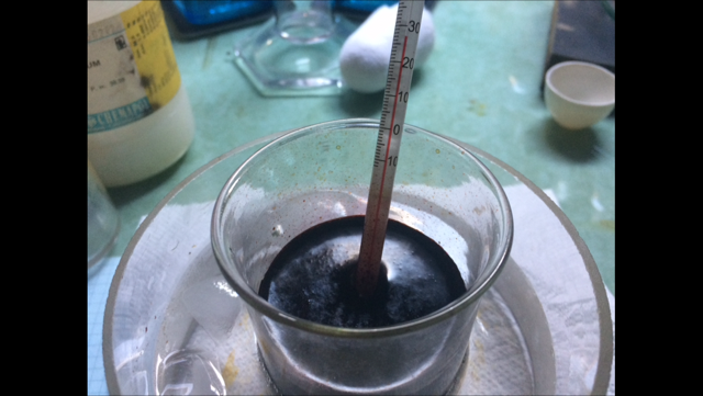

10g Citric Acid was dissolved in 20mL boiling dH2O.
Solution #1 was cooled to 15°C.
3g KMnO4 was dissolved in 100mL boiling dH2O.
Solution #2 was cooled to 15°C.
Solution #1 was added dropwise over solution #2.
The temperature was kept between 30°C - 35°C upon addition (10 minutes).
Fizzing and bubbling indicating the evolution of CO2.
The smell is reminiscent of Coca-Cola.
After 2h on standing, the liquid, which had now attained a yellow colour, was esterified with NaOH and EtOH.
Let's see in the morning if something precipitates out.
IMG_8745.PNG - 274kB IMG_8745.PNG - 274kB IMG_8746.PNG - 274kB IMG_8747.PNG - 275kB IMG_8748.PNG - 266kB IMG_8749.PNG - 260kB IMG_8751.PNG - 292kB IMG_8750.PNG - 294kB IMG_8752.PNG - 290kB IMG_8753.PNG - 302kB IMG_8754.PNG - 274kB IMG_8755.PNG - 273kB IMG_8756.PNG - 299kB IMG_8757.PNG - 298kB
[Edited on 5-6-2017 by ronstark]
