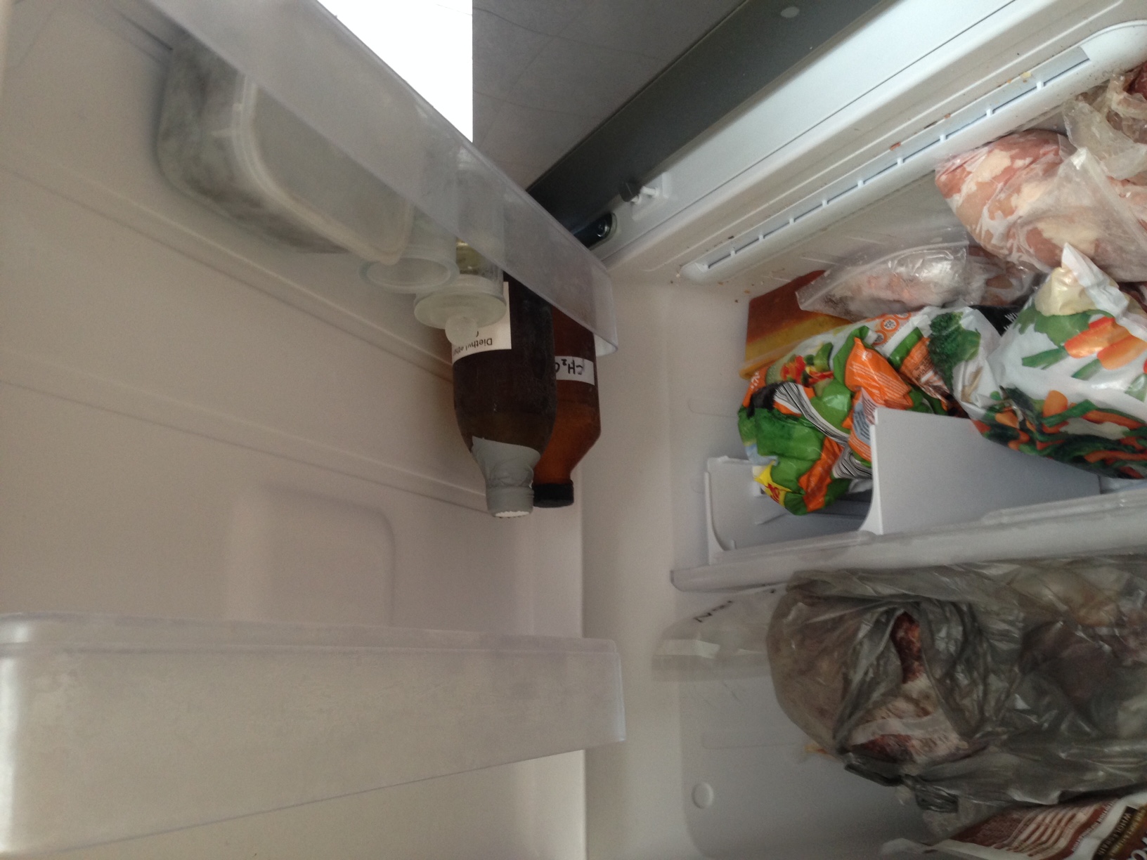

[*] posted on 22-12-2017 at 15:53
hahah nor do i.
IMG_0206.JPG - 442kB
any one for dichloro Chicken?
i have not died yet. no smells. note double storage of I2 and tape on ether
the plastic container has 1kg of Ga crystals :)
[Edited on 22-12-2017 by diddi]
