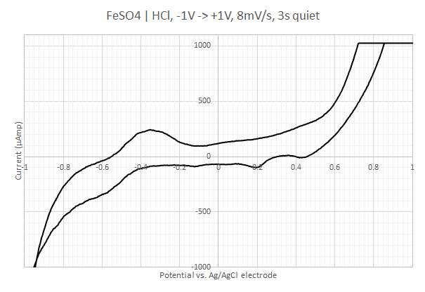

This time I got something :D The sampled current voltammogram is given below:
sampledcurrent.png - 23kB
I do get some nice peaks that differs from the scan direction.

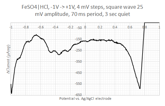

Moreover, when running square wave voltammetry from -1V to +1V I do resolve some structure in the large -0.2...0.4 Volts blob:
squarewave.png - 22kB

2/ What are those peaks in the -0.2...0.4 Volts range ? Is that coming from the iron or from the sulfate ? I have checked with the redox table but I cannot find any matches... Same for the two other peaks at 0.2 and 0.45 Volts. Are my axis eventually flipped around ? I have four different combination with the reference electrode and I do not know which one could be the correct one (i.e. signal + ref, signal - ref, -signal + ref, -signal - ref). I was expecting to get the answer to that question by looking at a "simple" voltammogram but... yeah... that's not really the case :-/

This paper might be helpful for you:
Attachment: MN.JPCC.117(2013)16343.pdf (1.3MB)
This file has been downloaded 532 times
Figure 2b shows a CV spectrum measured at a scanning rate of 5 mV/s. The reduction of Fe(III) ions to Fe(II) ions occurs as a single peak at 0.35 V, which is close to that obtained at 20 mV/s. The oxidation of Fe(II) ions to Fe(III) ions shows two peaks, whose positions are 0.57 and 0.72 V. The peak at 0.72 V is close to that obtained at 20 mV/s and is attributed to simple oxidation of Fe(II) to Fe(III). The oxidation process at the low potential involves the sulfate ions, which affect electrode kinetic parameters and diffusion coefficients at high concentration of aqueous iron sulfate solutions.

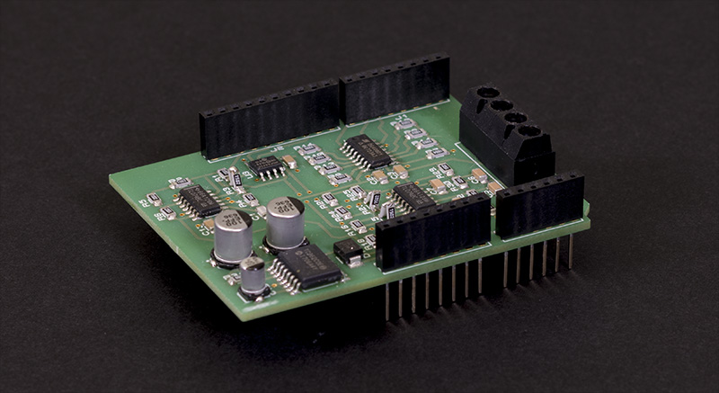

@Nemo: I implemented your advice of multi-sampling this morning. It is a bit tricky because of the non-steady nature of the waveforms considering the relatively low speed of the Arduino ADC. Nonetheless, it should at least give repeatable measurements even if they might be biased. On the other hand, the 10-bit ADC starts to be limiting with the quantification noise. Maybe upgrading to 12-bit ADC would be a good thing.
Last time I forgot to put a picture of the arduino shield, so I am also taking the occasion to put one :)
