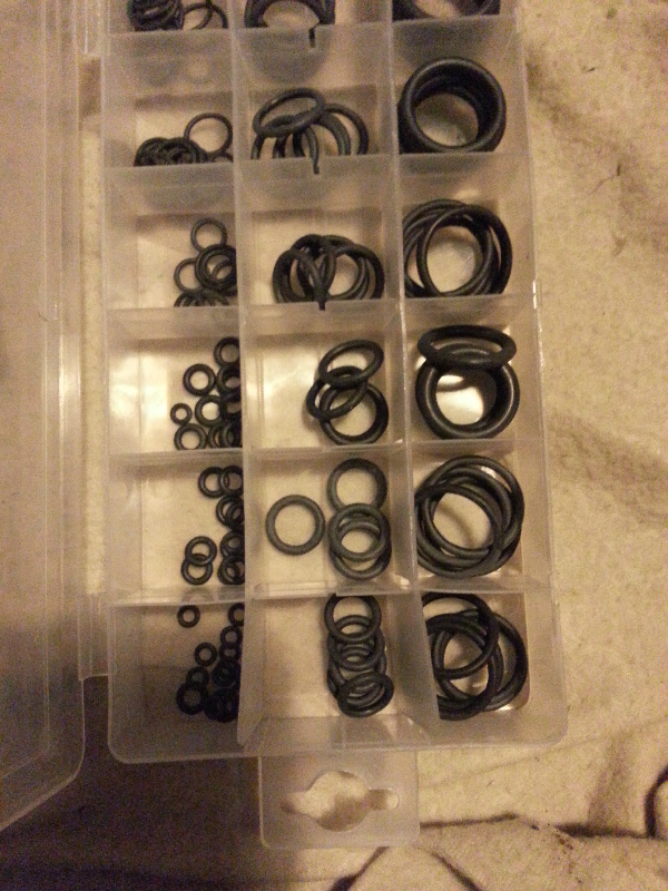

I been using these with vac high temp grease. They are on ebay and ALL 4 boxs were sold together for £4
https://www.ebay.co.uk/itm/419pc-Rubber-O-Rings-Tap-Washers-...
20180113_032951[1].png - 1.1MB 20180113_033026_-_Copy[1].png - 1.2MB
[Edited on 13-1-2018 by NEMO-Chemistry]

Great find Nemo, I paid a lot for a box of them years ago. But I always run out of the smaller ones for stopcocks whenever I have an assortment. Viton is fine for most chemicals, the O-ring should not see much solvent if the stopcock does not leak.
