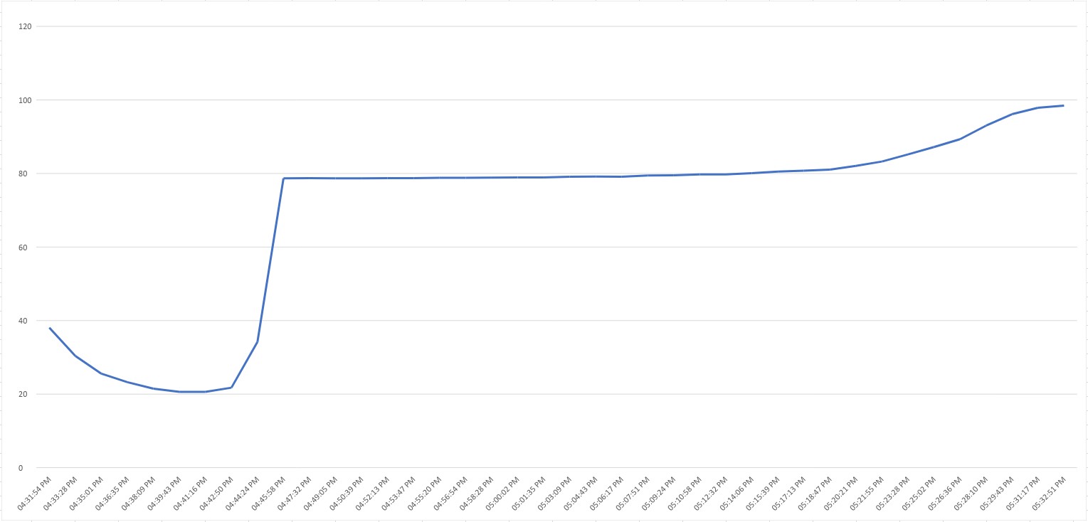

After I wrote a script that converted the data into an Excel document then plotted a graph of each of the distillations.
The first one was the distillation of the sugar wash
1.jpg - 60kB
Then, as it became more concentrated
2.jpg - 80kB
The vapour temperature slowly creeps down to 78 after a few distillations meaning we have reasonably pure ethanol.
3.jpg - 77kB
This is a small proof of concept and I know my apparatus is pretty ghetto but this could be massively scaled up for example for fuel distillation.

Haha nope it only shuts off the hotplate once it reaches 98C, I always have a terminal window sitting on my desktop when I have a distillation running so I can make sure it turns off. Then afterwards I monitor the temperature and it drops so I know the socket is off.

Good idea, I was thinking about comparing it to a table of boiling points for ethanol water mixtures but I can't find good data. How would you go about estimating concentration with those temp values and the mass of the distillate?
