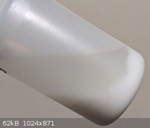

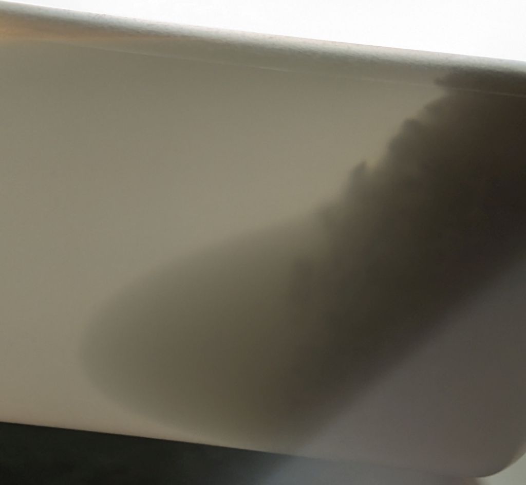

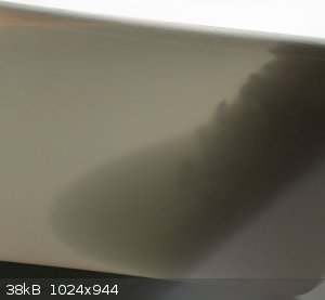

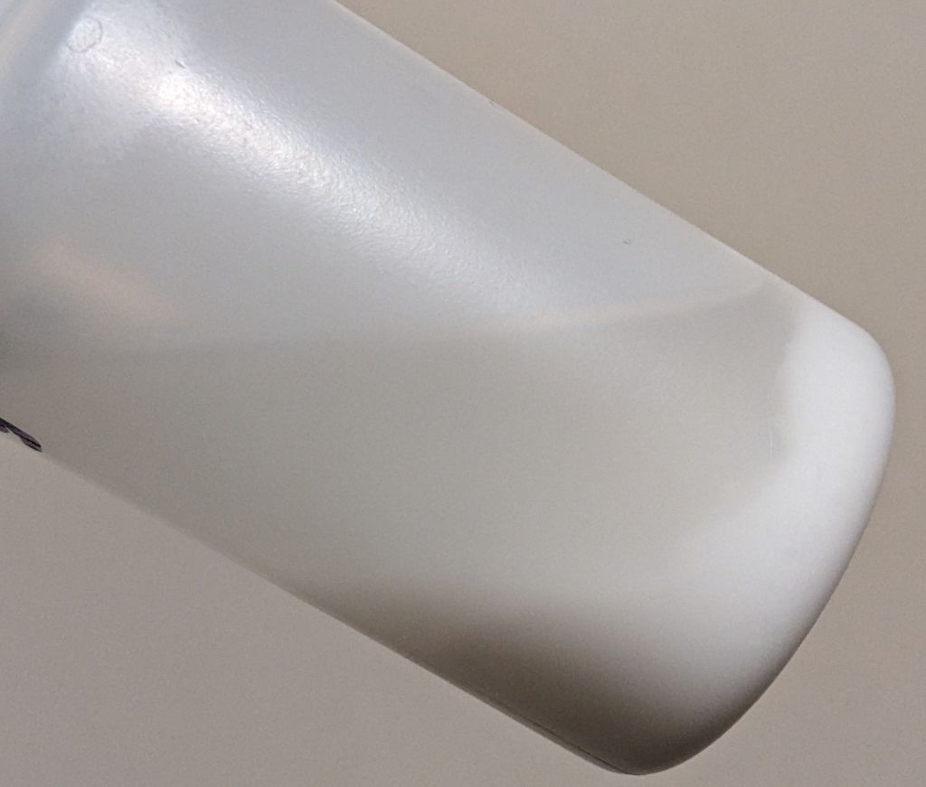

I have tried MgSO4 in 91 v% IPA azeotrope (87.3 w% IPA).
I prepare MgSO4 as a drying agent by gently heating commercial Epsom Salts at 100 °C until the crystals turn from clear to white, which gives the
trihydrate (by gravimetric estimation) without melting, then raising the temp to 200 °C which gives the monohydrate with the original crystalline
form intact, so it is easy to handle; no crushing needed and there is not much dust. I cannot get to anhydrous with the lab drying oven that I am
using. Supposedly the monohydrate decomposes to anhydrous at 250 °C, but I have not found that yet.
Adding 10g of this MgSo4.1H2O to 50g of 91% IPA gives me 3 distinct phases; a solid phase, an aqueous layer, and an alcohol phase on top. So, some of
the water has salted out of the azeotrope, but I have not yet separated the layers for quantitative determination. A drop of the alcohol layer

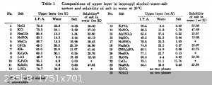

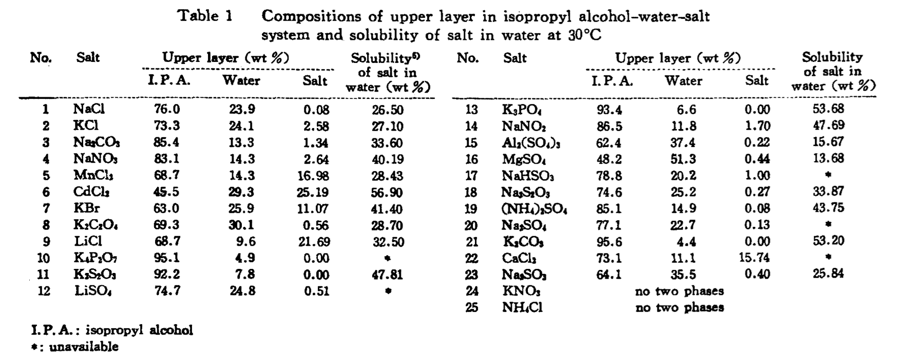

evaporated on glass does not leave any visible haze, so the solubility of MgSO4 in IPA cannot be more than trace. I found this reference that probably
applies to my aqueous phase: water 74.5%, IPA 3.%, magnesium sulfate 22.5%, 25 °C.
Another test using 5g of MgSO4.1H2O in 100g of 91% IPA increased the weight of the (very gently dried) salt to 8g suggesting that the salt can go to
the pentahydrate under these conditions, while reducing the water content of the alcohol phase from 12.7% to 10% by weight (by calculation).

Line 16: MgSo4 Upper layer; 48.2% IPA, 51.3% water, does not represent what I obtained for my upper layer, not even close, although it might be my
aqueous (middle) layer.
What I have for the upper IPA layer has much less water than azeotropic. I still need to determine composition to make a proper comparison.
The solid, aqueous, and alcohol layers can be seen in the photos through the translucent plastic bottle that I used.
I will make another attempt to add just enough MgSO4 to make a lower liquid layer to an endpoint that leaves only a trace of solid.
