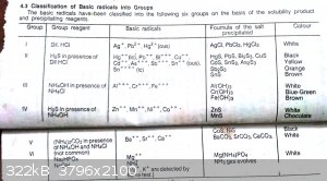

Mant times I have tried this experiment but every time I get a precipitate. I take some zinc chloride soln. in a test tube ,add NH4Cl in it and then add NH4OH but always i get a ppt and according to this book Zinc ions should not ppt due to common ion effect and their higher solubility product . Same thing is happening with manganese instead of precipitating in group 4 they get ppt in group 3 .
Guys please try this and tell is same happening with you
These are photos of that book . You may understand from this what I want to say
New Doc 2018-03-08(1)_1.jpg - 480kB New Doc 2018-03-08(1)_2.jpg - 322kB

Ya bro you were right . I tried and this time I could not get a ppt with zinc ions but got a ppt with Fe2+ ions. Why did they get precipitated their solubility product is almost of same order of other ions of group 4
