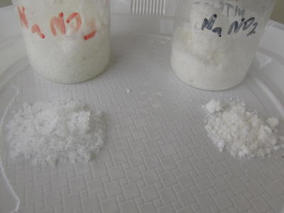

The yellow tint is almost impossible to see unless you sneak up on it and take a peek while it's back is turned.
nitrite.jpg - 28kB
On the left is some sodium nitrate, probably prepared with nitric acid & some sodium salt (can't remember).
On the right is the sodium nitrite prepared a couple of years back, using some of the same nitrate seen on the left.
@Akhil: if you're convinced there's no Fe present, try the activated carbon trick to see if it clears that yellow solution up a little.

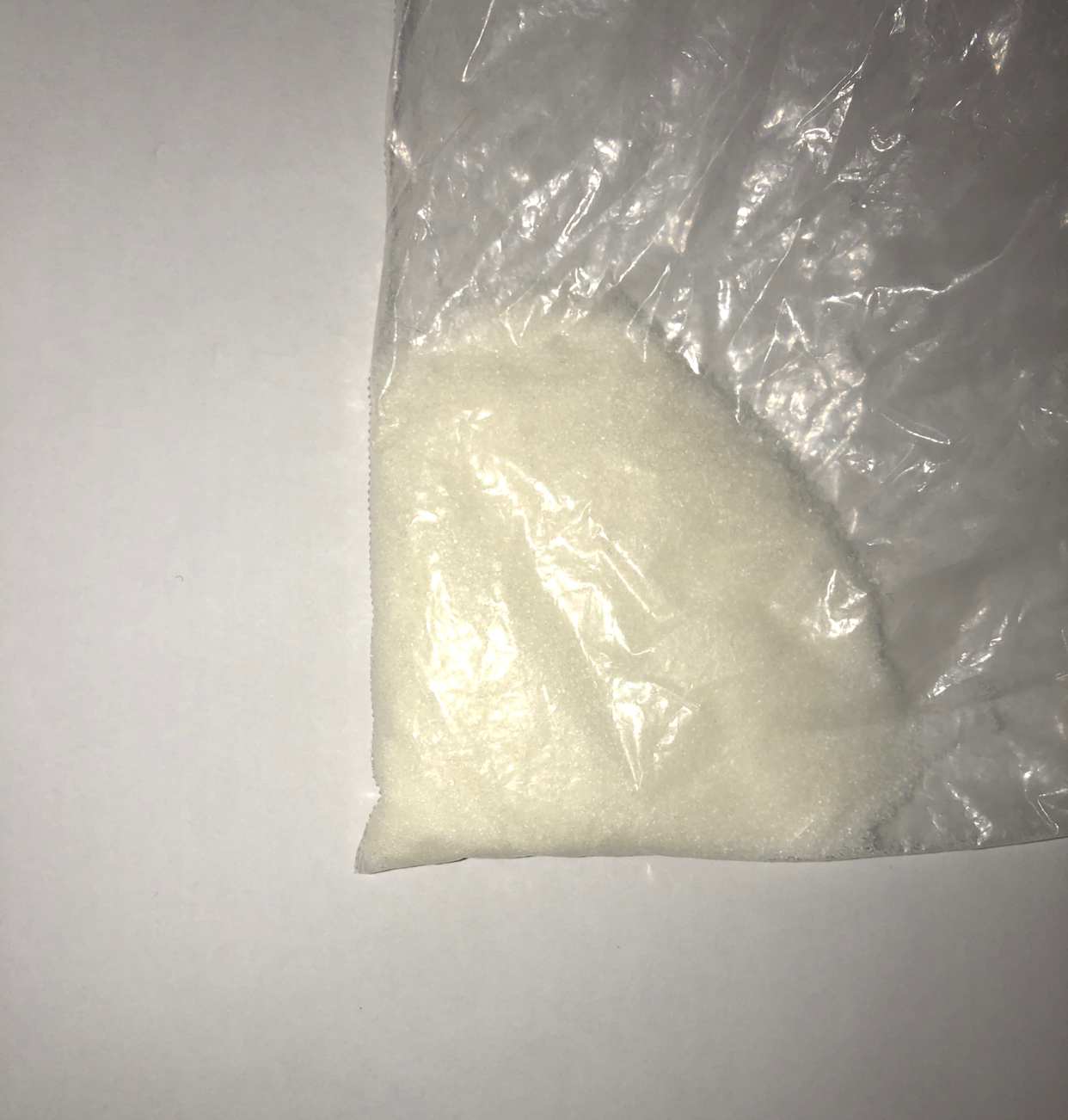

The food grade sodium nitrite I have is slight yellow in colour. Since both K+ and Na+ are colourless, I’d presume it would be the same either way.
[*] posted on 19-3-2018 at 11:17
Quote: Originally posted by LearnedAmateur
The food grade sodium nitrite I have is slight yellow in colour. ....
Please post a photo for comparison.

Only got about 50-60 grams left, gotta get some more soon.
Apparently it’s 99.9% pure, it’ll have to be high for food use but in any case it’ll be at least 98%.
E00698F3-915C-468C-82FA-E95CE27954F9.jpeg - 1MB
[Edited on 19-3-2018 by LearnedAmateur]
[*] posted on 19-3-2018 at 11:45
Thanks LearnedAmateur !
That yellow stuff looks highly granular, like cubic crystals.
Very much like the wiki image shows.
I guess mine is more white and fluffy due to idiocy and/or Pb salt contamination.

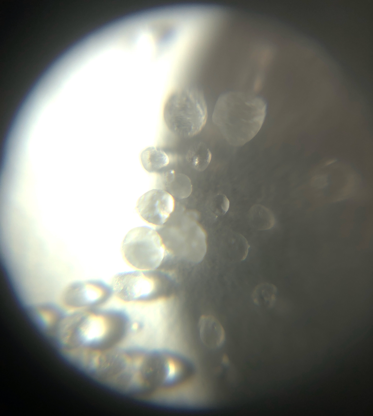

Yeah it’s got the consistency of table sugar as far as I can see, just a little smaller. Time to bust out the ghetto microscope for a better look! Sucks though because it doesn’t exactly show true colour and it gets in the way of the flash, but I’ve got some cool pictures with it before.
0F94E14C-123C-4DC9-B0C9-EFA855BE8077.jpeg - 878kB
