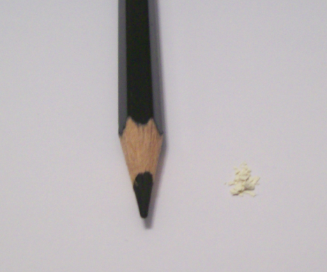

An amount around 0.005g of the silver salt can be seen below, next to a pencil for scale and when it was confined in foil and heated, it detonated sounding like a gunshot (amounts near 2 to 5mg yield detonations that sound like gunshots).
2-5mg sounds like a gunshot huh.......
that's a lot of sass from such a tiny mass :D
Maybe about 50mg made into a paste with dextrin and dried into a pellet around a bridgewire in a squib cavity could be good for something or another. Pushed firmly against a column of compressed PETN the two could probably really communicate.

Yes, it gave me quite an unexpected shock because of its flimsy reaction to open flame. It could make for a great party gag.
Silver nitriminotetrazolate and disilver(aminotetrazol) perchlorate have been said to be the two most promising compounds for replacing the most useful initiator for insensitive HNS, which is currently Cd(N3)2.

[*] posted on 21-10-2011 at 11:24
After the process, the obtained white powder was let dry under the sun. The liquid liquor of this containing some of the powder, nitric acid, and water was saved. The powder should be 5-nitrimino-1H-tetrazole (5-NAMTZ), or its hydrate.
I've attempted to characterize this white powder, but I now think that it is in fact aminotetrazole nitrate. Using non-anhydrous ATZ and nitric acid, likely caused only a partial nitration and so then nitriminotetrazole likely passed into the liquor solution. Forming the pale-yellow silver salt could also be done this way (it's best not scaled up because of diazotetrazole risk): a few mg ATZ.H2O added to several drops red fuming nitric acid, this then mixed and let stand a few moments and then taking only the liquid portion of this and adding it to aq. AgNO3 under mixing, then filtering and washing.
The pale-yellow salt's reaction to open flame sounds very similar to Axt's description of the salt he made from the acid. I've attempted Ag determination but much of the fine Ag2O precipitate passed right through the filter paper, and so its silver content could not be determined. It's much less flame and impact sensitive than silver nitrotetrazolate (AgNTZ). It gave no reaction to various hammer blows directly on an iron plate (meaning it's not entierly insensitive, but its sensitivity is low). It is a highly powerful material and so should not be underestimated. It doesn't have texture issues like silver or especially copper nitrotetrazolate, it flows very good. It does not darken on standing like AgNTZ does. The high amount of thermal energy needed to explode it, is indeed in the same area as silver azide.
Concerning impact sensitivity, the sensitivity between aluminium foil does not work well even as a crude impact test. The thought was it would help powder keep from spreading during impact. But hitting several crystals of copper nitrotetrazolate in between the foil on an iron plate even with the hardest hammer blows gave no reaction, though the crystals were crushed. The aluminium foil caused forces to dissipate. A symmetrical pestle mass falling only a few centimeters directly onto the crystal detonated the copper salt (other primaries like silver acetylide complex do this also). Also mechanically speaking, indirect forces are safest there.
