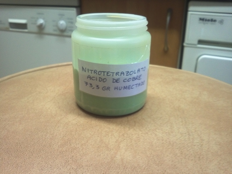

@Formatik:
here more pictures of acid salt CuNTZ primary explosive and precursor. With the sincere hope that those experts who have made ​​this thread (Engager, Rosco Bodine, The Davster, PHILOU Zrealone, Hokk, Sobrero, Microteck, Chemoleo, User, Franklyn, Swany, JohnWW, Nick F, oket, hokk, quick silver, 497, Pdb, Ritter, Axt, and long etc...) as soon as possible they clarify our doubts concerning to properties, storage, safety and handling of this potent compound, in dry and wet form.
I hope, Formatik... :o
NOTE: Ph around 3 Ok?

As a basic rule, you should never concentrate more than 1 gr or less of any primary in the same place, and avoid keeping it for years. Your 73 gr storage, whether dry or moist, is insane.
As CuNT is not widely used, do not expect to find as much information in literature as with century(ies)-known compounds like MF and LA. However, if you die from your 73 gr, it will be a valuable piece of information (in fact a confirmation of the rule) for the community...

I think if I were you I would add it slowly to a dilute sodium hydroxide solution. This would form a dilute sodium nitrotetrazole solution, which should be fine in storage, and copper oxide which can be filtered off. And then use your sodium nitrotetrazole solution to ppte silver nitrotetrazole or whatever in small quantities as you need it.

Just remember, it is far less painful for everyone involved to handle wet CuNT instead of dry.

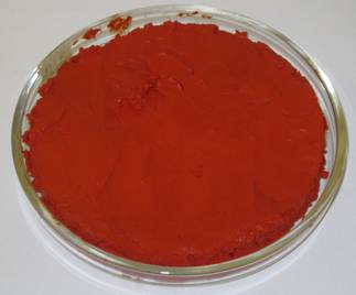

During the coarse of this work I attempted the synthesis of 5 aminotetrazole by my preferred route from cyanoguanidine and Na azide but decided to try a modification whereby the solid azide was not isolated but generated as an aqueous solution and used direct. The reaction failed but it did generate an interesting orange red product. I report back on this one with some photographs shortly.
Posts: 1805
[*] posted on 6-10-2012 at 17:20
Not 5-aminotetrazole either
I have used the method of producing 5-aminotetrazole outlined in US patent 5451682 on several occasions with complete success. This preparation involves the reaction of sodium azide with dicyandiamide in the presence of boric acid. While dicyandiamide is not easily obtained it can be purchased of the internet freely and cheaply. The same is not true of sodium azide which is hard to obtain and expensive and for most amateurs must be synthesized. There are several methods of preparing alkali azide but the most widely used synthesis is to react hydrazine with an alkyl nitrite in the presence of sodium hydroxide. There are several variations on the basic synthesis but obtaining solid sodium or potassium azide is always tedious and it would be helpful if the isolation of the solid could be avoided, in part because the reaction could then be carried out in and aqueous medium instead of an alcoholic one.
It is reported in an English patent that if a lead salt is added to a mixture of hydrazine nitrate and sodium nitrite lead azide is precipitated. Since no lead is to be introduced into the preparation of aminotetrazole the more readily available hydrazine sulphate was used in this experiment. The product in this case should be hydrazoic acid and sodium hydrogen sulphate:
N2H4.H2SO4 + NaNO2 = HN3 + NaHSO4 + 2H2O
Since hydrazoic acid is not a strong acid the presence of a large amount of bisulphate salt may cause loss of highly poisonous hydrogen azide gas from the solution during manipulation so that after mixing the reaction mixture is neutralised with two molar equivalents of sodium hydroxide. It was decided to add half the sodium hydroxide at the beginning to liberate free hydrazine.
The ultimate goal is to use the resulting solution directly in the preparation of 5-aminotetrazole.
Experimental
Stir 26.01g of hydrazine sulphate into 175ml of water and add 20ml of 10M sodium hydroxide solution and slowly add to the clear solution 13.80g of sodium nitrite in 20ml of water. The remaining half of the sodium hydroxide was not added as the solution did not appear particularly acid.
The solution produce above was placed in a 500ml round bottom flask along with 33.4g of dicyandiamide (cyanoguanidine) and 18.56g of boric acid. The mixture was warmed and swirled around until most of the dicyandiamide had dissolved, a piece of broken porcelain added and the flask then placed in a heating mantle with a reflux condenser attached. The mixture was heating until boiling and then refluxed gently for 23 hours, yielding a pale yellow liquid.
After refluxing the solution was poured into a 1 L beaker and acidified with 60ml of 28-30% hydrochloric acid, the red orange precipitate that formed was filtered at the pump. The precipitate is fine, filtered slowly and difficult to wash and dried after only limited washing. The dried material was re-dispersed into water filtered heated to 70°C, cooled to room temperature, filtered and dried. The yield of a bright orange red amorphous powder was 8.57g. It is clearly not 5-aminotetrazole. The compound is insoluble in cold water, alcohol, isopropanol, toluene and dichloromethane, it is very slightly soluble in boil water and separates out on cooling as a fine red powder. It is soluble in sodium hydroxide forming a dark brown solution that precipitates a brown amorphous product when acidified. It is weakly energetic when heated above its melting point.
The product has not yet been investigated but its weakly energetic nature and its deep orange red colour suggest an azo compound of the nature of azo-bis-formamide H2N.C=O.N=N.C=O.NH2.
The cause of the unexpected reaction product may be the failure to completely neutralise the original azide solution which meant in effect the solution was boiled far too long and any tetrazole derivative that might have formed was decomposed or it may have been due to the presence of unreacted hydrazine and nitrite in the starting mixture. Further experiments will be conducted when time permits using the following modification:
  1. After mixing the hydrazine salt and sodium nitrite raise the temperature to a gentle reflux very briefly and cool.
  2. Completely neutralise the solution completely as was originally intended before adding the cyanoguanidine and boric acid. Alternatively the boric acid can be omitted and the reaction mixture refluxed for a short period of time.
I have just purchased some melting point apparatus off ebay so when I get it working I'll investigate the m.p.'s of this and the products described in the previous post.
5 after acidifing.jpg - 29kB Precipitate on acidifying with HCl
6 final product after 2nd filtration.jpg - 22kB Final product still moist after 2nd filtration
[Edited on 7-10-2012 by Boffis]
