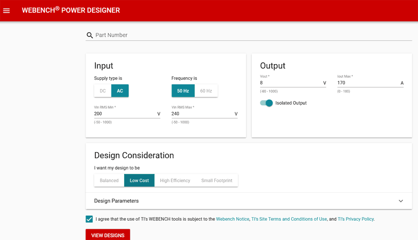

For anyone wanting to 'roll-your-own' power supply, Texas Instruments have an online tool called Webench. This will take the input voltage and output voltage and current you specify, search through TI's parts catalogue, and generate a bunch of designs that fit your specs, complete with a parts list and simulation results. You can also choose to optimise for size, efficiency or cost.
https://webench.ti.com/power-designer/

Thanks TwoSpoons but
I put a design into the machine and it give me back a 'we cannnot do a design for your specs' (or somethign like that) + a pile of reasons why it could not do it.

[*] posted on 6-12-2023 at 11:28
current too high.
Well, building a 1.5kW offline isolated supply is not so simple. You likely need to start with a PFC, followed by a quasi-resonant full bridge converter and finished off with synchronous rectification. Thats a fairly complex system, beyond what webench was intended for.
But if you already have a 48VDC server supply and you want to go down to a few volts at lots of current, then webench probably has an answer for you.

Quote: Originally posted by fx-991ex
current too high.
The page allows up to 180Amps!
I don't know much about smps.
The links on the Chez. page
use MOT's to bring the voltage down to a lower level (from the mains).
