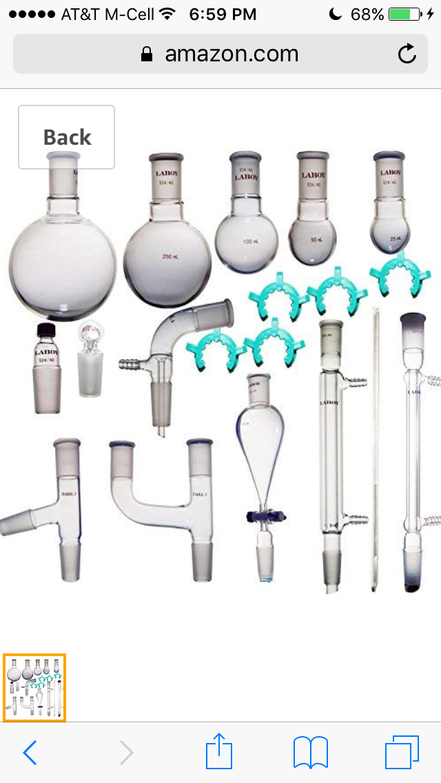

[*] posted on 18-8-2018 at 18:58
I have to get all of my glass off of Amazon because otherwise the shipping is atrocious.
This delux organic chemistry kit by laboy is something I have been looking at for a while. Is it a good kit?
https://www.amazon.com/Laboy-HMK0103-Organic-Chemistry-Glass...
[Edited on 19-8-18 by Abromination]
IMG_3189.PNG - 490kB
