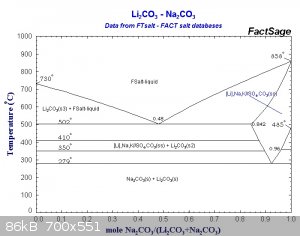

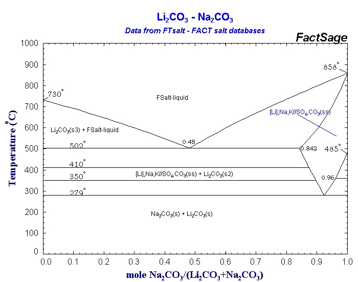

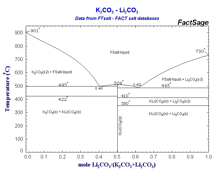

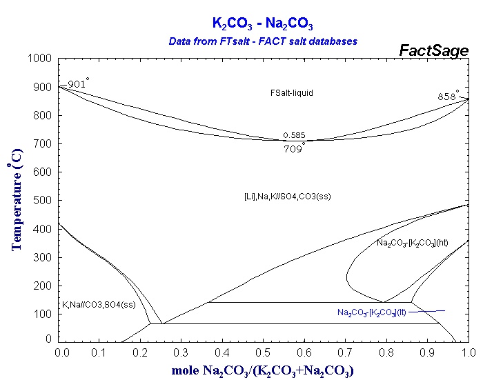

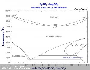

From http://www.crct.polymtl.ca/fact/documentation/FTsalt/FTsalt_...
K2CO3-Li2CO3.jpg - 82kB K2CO3-Na2CO3.jpg - 88kB Li2CO3-Na2CO3.jpg - 86kB
All three together:
https://www.researchgate.net/publication/235439109_The_Therm...
I knew that lithium salts can depress the melting point when mixed with other salts, so I just looked around for a good binary or ternary mixture. Maybe there is something better out there, but I had some zinc to melt, and what I found seemed good enough. I threw in some ammonium chloride since that is a common additive in aggressive fluxes, and most of it sublimates anyway.
