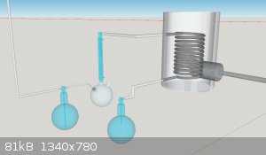

[*] posted on 14-6-2020 at 11:34
On the ketene lamp concept, could ketene be formed by just distilling acetone trough SS tube that is drawn through ceramic wool furnace heated with propane burner?
It could be more feasible to produce this than operating with nichrome wire. Put acetone vapor through bottom inlet, heat the inside of furnace to 800C and out comes ketene, which is cooled with reflux condenser with receiver for any side reactants and the final gas ketene led into GAA.
This type should be easily scalable due to tube length being the factor of pyrolysis capacity. The temp of 800C would be very easy to maintain with ordinary high pressure propane torch.
The joint between steel and glass between the pyrolysis tube end and the condenser would be an issue though. The gas would be very hot leaving the furnace and it would quickly melt any plastic joint. Making a larger tube ending and turning a graphite adapter would be an option.
ketene2.jpg - 81kB
[Edited on 14-6-2020 by Refinery]
