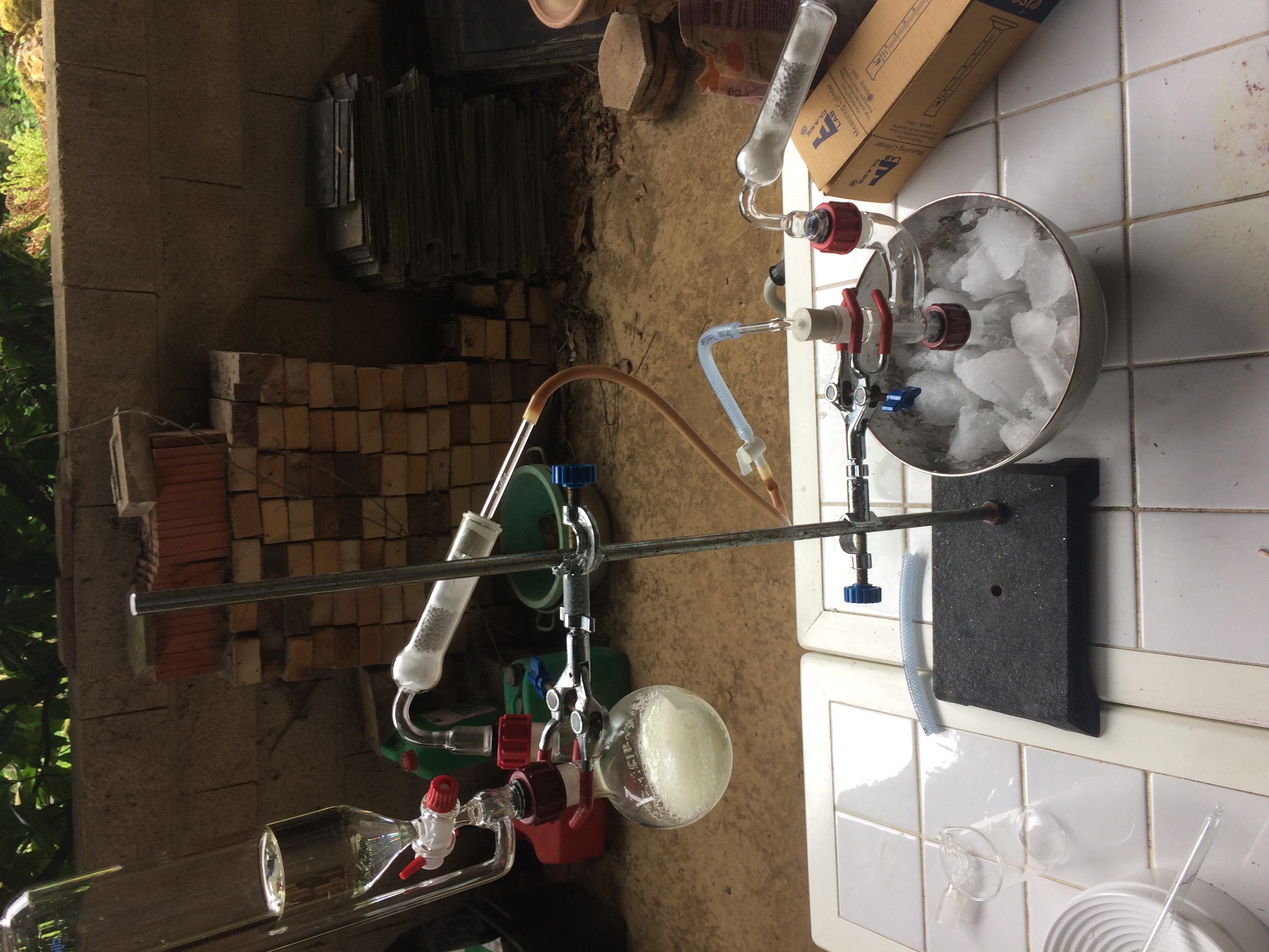

So, I decided to try this reaction today. The setup is in the first attached picture. Dropping funnel with ~ 100 mL of concentrated sulphuric acid, 250 mL two-neck RBF filled with 60 g NaCl, second neck leading to a CaCl₂ tube. The outlet is connected to a bent glass tube (that I made myself using straight tubing, a glass cutter tool and my blowtorch, I’m pretty proud of that) running through a rubber cork plugged into the first outlet of a Claisen adapter. The tube plunges into a small, 50 mL RBF containing 0.3 mole of each acetonitrile and glacial acetic acid (circa 15 mL each), the RBF being immersed in an ice/salt bath. The second outlet of the Claisen adapter is connect to a second CaCl₂ tube.
I calculated the HCl generator for a 2 mol output, way more than the stoichiometric amount (0.6 mol).
A gentle current of argon was bubbled into the solution while the HCl generator was starting, to clear residual moisture (the weather was rainy).

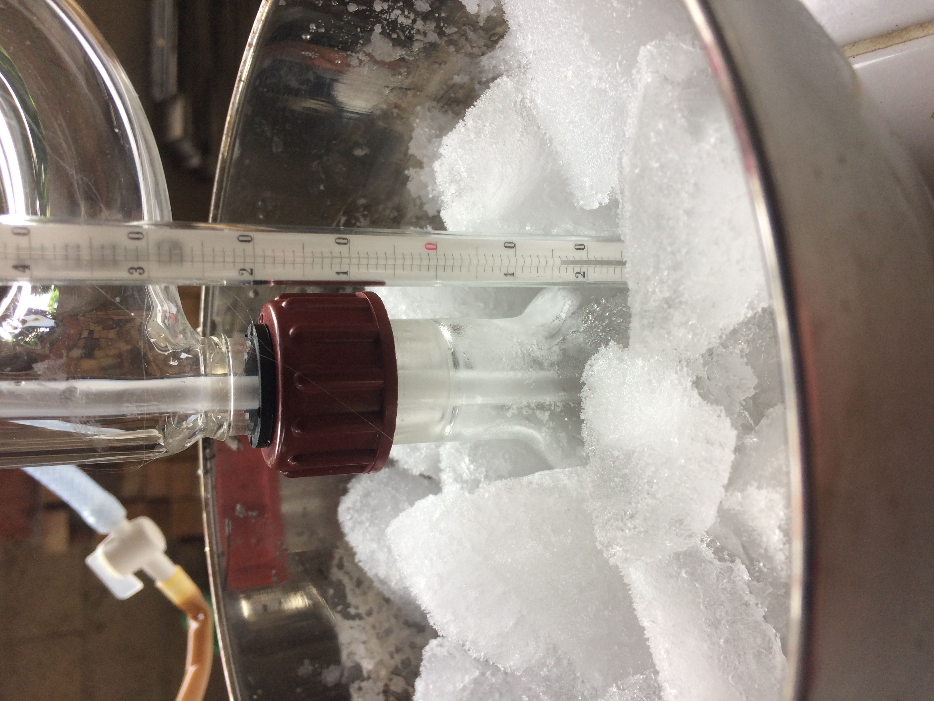

At no point during the HCl bubbling did the temperature rise over -15 °C (see second picture).
But the HCl gas generator turned out to be pretty unreliable. I had a very slow stream of HCl out. Even when the addition of all the sulphuric acid was over, I got the feeling that very little had run into the small RBF. I dismantled the apparatus, transferred the contents of the RBF into a vial that I stored in the freezer. So far, (about 6 hours later), I still have nothing apparent. There was a lot of unreacted acid in the HCl generator, which took a while to neutralise properly with both lye and sodium bicarbonate. I didn't heat the HCl generating flask, and I’m sure that was a mistake, because the reaction didn't generate a lot of heat, was slow, and I had to open the generator every so often to break up the mass of ?sodium bisulfate? that formed and swirl the flask to get it run more vigorously.
I won’t be able to return to my lab before next Tuesday, but in the meanwhile the flask with the reactants is secured in the freezer. I probably can pick up where I left, assuming I can assemble a more efficient HCl generator. If anyone had a recipe for a good, reliable HCl generator, I’m all ears :)

EDIT: I was told that the flask is now full of crystals. I suppose it takes a while for the reaction to progress at -18 °C. I wonder, btw, if the reaction starts with the bubbling at all. Probably the bubbling gets HCl dissolved in the mixture, and it’s only after the bubbling is complete that the reaction picks up. If this is true, then it’s important to keep the flask cooled in order to avoid losing HCl.
By the way, I got no HCl escaping from the second CaCl₂ moisture trap, so I guess everything I generated got dissolved.
I’ll check what I get next Tuesday.
