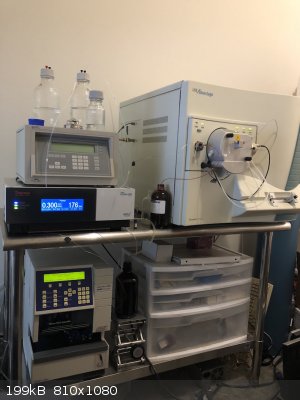

quadrupole
Posts: 4
Registered: 14-9-2018
[*] posted on 14-9-2018 at 17:34
Quote: Originally posted by DavidJR
Interesting... might help to give an example of cost.
Now that I have HPLC in my garage I would also consider doing something like this.
I strongly suggest it to you. You may help many people and earn some money yourself to run the machine.
Considering all aspects (manipulation with sample, measurement, machine running costs) I think it would be reasonable to start at 5$ per sample. Of course, with the increasing number of samples the price will rapidly fall down.
Let´s say for 5 samples you would only be charged 20$ instead of 25, for 10 and more samples 3$ per sample... as most probably ten samples will arrive together and I will not be forced to visit the post office 10 times.. and start machine ten times..
That's very reasonable I think.
Re HPLC:
I think that would be a bit trickier since the chromatogram of a sample can change dramatically depending on the conditions, so would possibly require several runs to get a good result. If there was an already known/published HPLC method then that would be useful. I would also need to consider the cost of consumables (solvents, autosampler vials, syringes, filters, etc).
However if anyone (UK/EU easiest) here has some samples they'd like me to run I'm happy to discuss that. I only have reverse phase C18 columns currently. It'd be most useful if you had a few related samples to run under the same conditions to compare (for example, the starting materials individually as well as the product of a synthesis).
do it.
I usually charge $40/sample, but because it's UHPLC-MS
IMG_4679 2.jpg - 199kB
